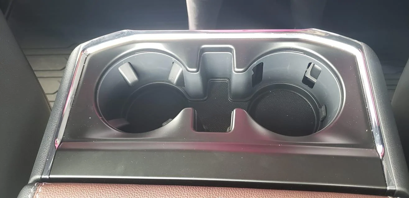

seen a couple posts where the little tension arms inside the cupholders for rear passengers are missing or pushed in or something. a couple people on the FB page have reported it. (not my pic)
