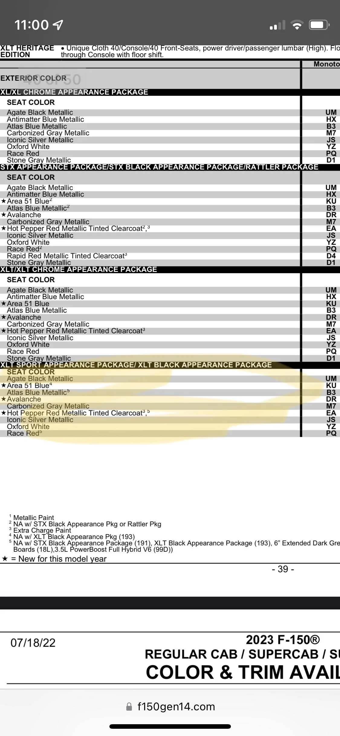

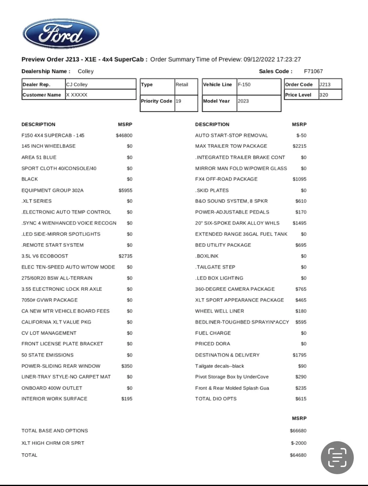

Here's what my dealer came up with ,can someone confirm my 2 ? I've asked about previously,will this have the rear dual exhaust & will it have leather seats with center console shifter.I told them I want the Bap package but this is all they could find for the Xlt ,If not what exactly are the codes I need to tell them thanks for any help. In the description of the sport appearance package it looks like it said painted bumpers but mentioned cloth seats .I've asked here before & was told to ask for sport appearance package & Bap ,but Bap doesn't show up for them, Thanks I included a couple of the descriptions that I found

Black appearance back gets dual exhaust , and your console is correct 40/console/40 indicates center console.
Now for leather it’s unavailable on xlts this year on 2023 model years……

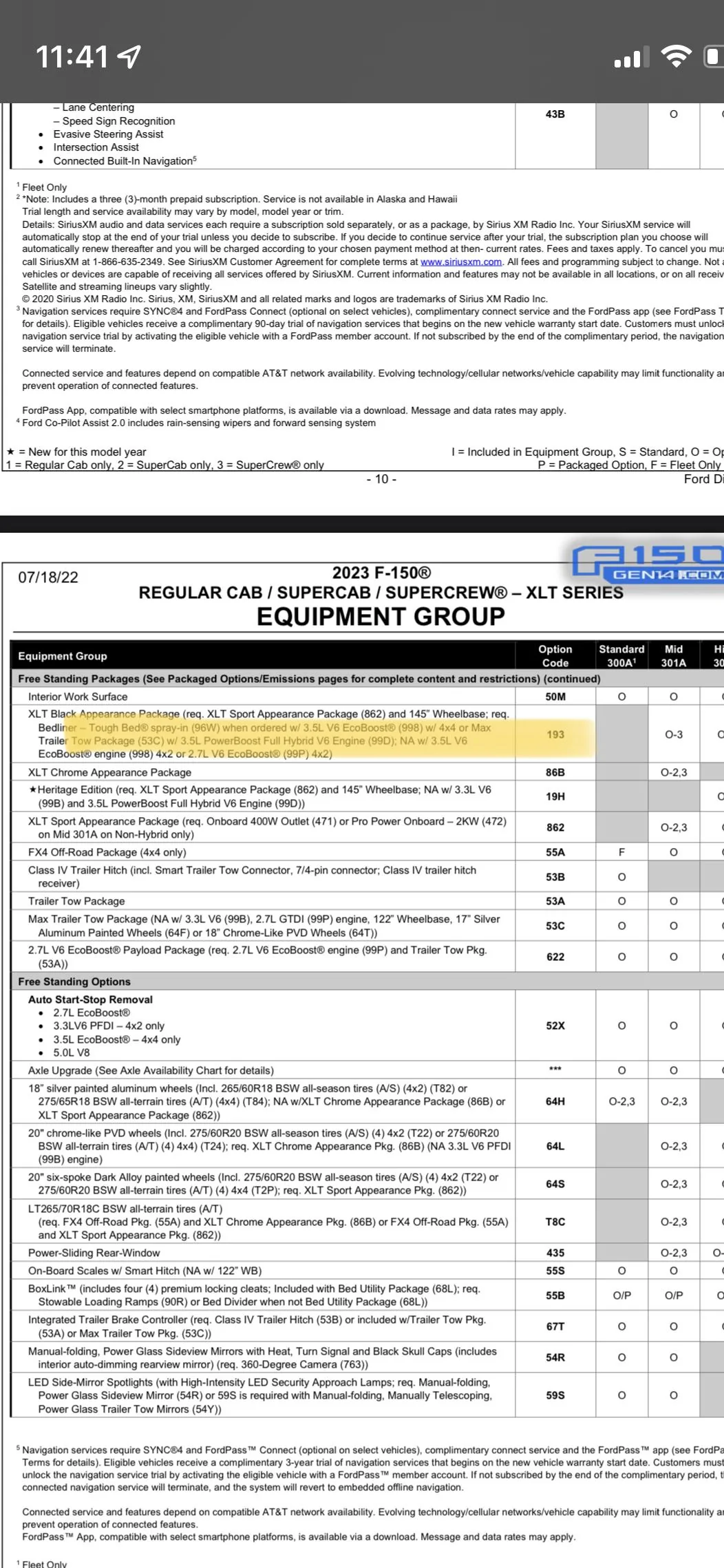

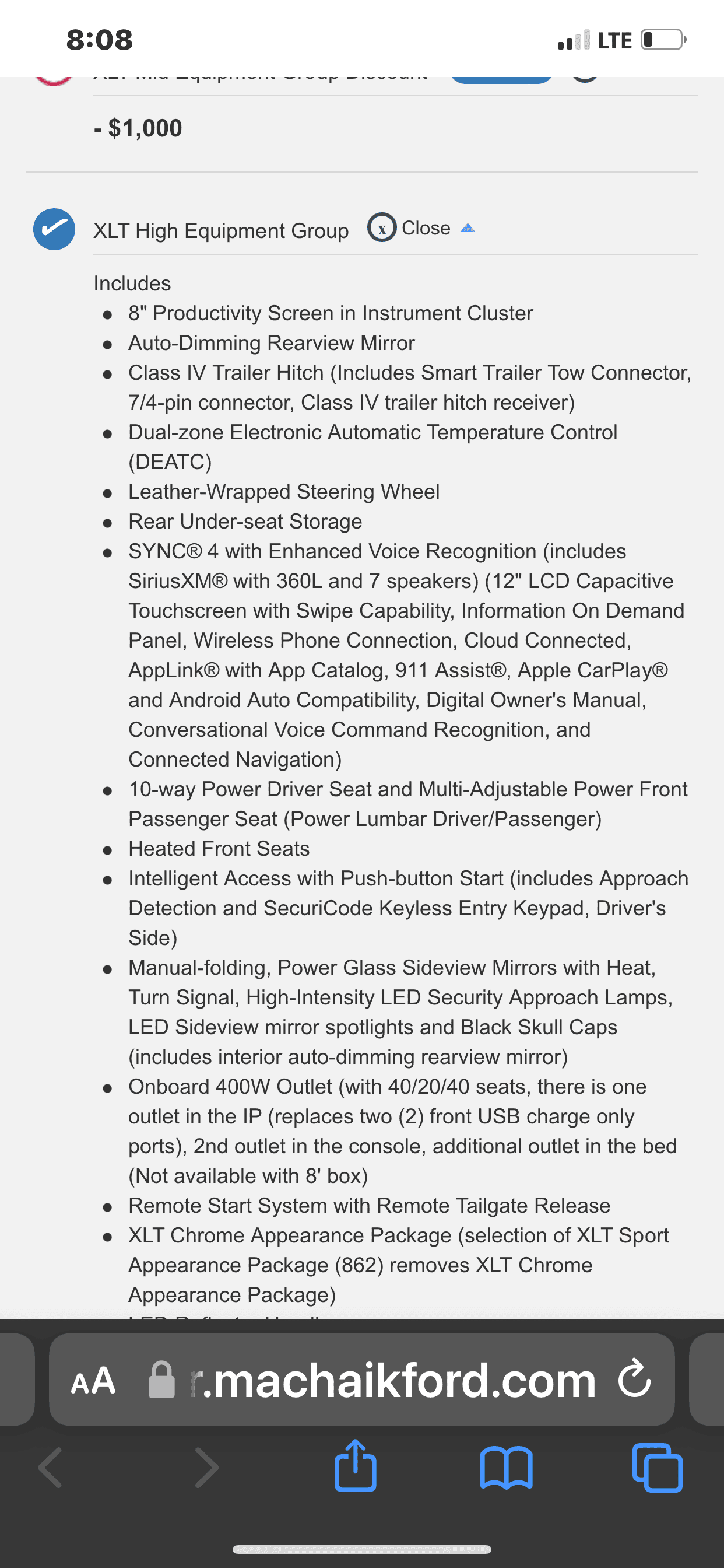

Looking at your build sheet your missing black appearance pack. Order code is 193. I highlighted it above in the 2023 f150 order guide….

Thanks Nobody looks like what i was looking for ,you think this would also give leather

Be careful because you ordered paint code Area 51 blue, BAP is not available on that colour. This happened to me in january when I tried ordering Star White with BAP until I changed my order to Carbonized gray then BAP became available for the dealer to order.
OK thanks that makes sense do you know what colors are available with BAP

BAP is only available in Supercrew with 5.5 bed. On a supercab XLT, the only option to get leather would be to add after delivery like Katzkin or similar.
Supposedly you can get leather on an Xlt with the Bap & the sport appearance package ,well see as i just ordered one.
