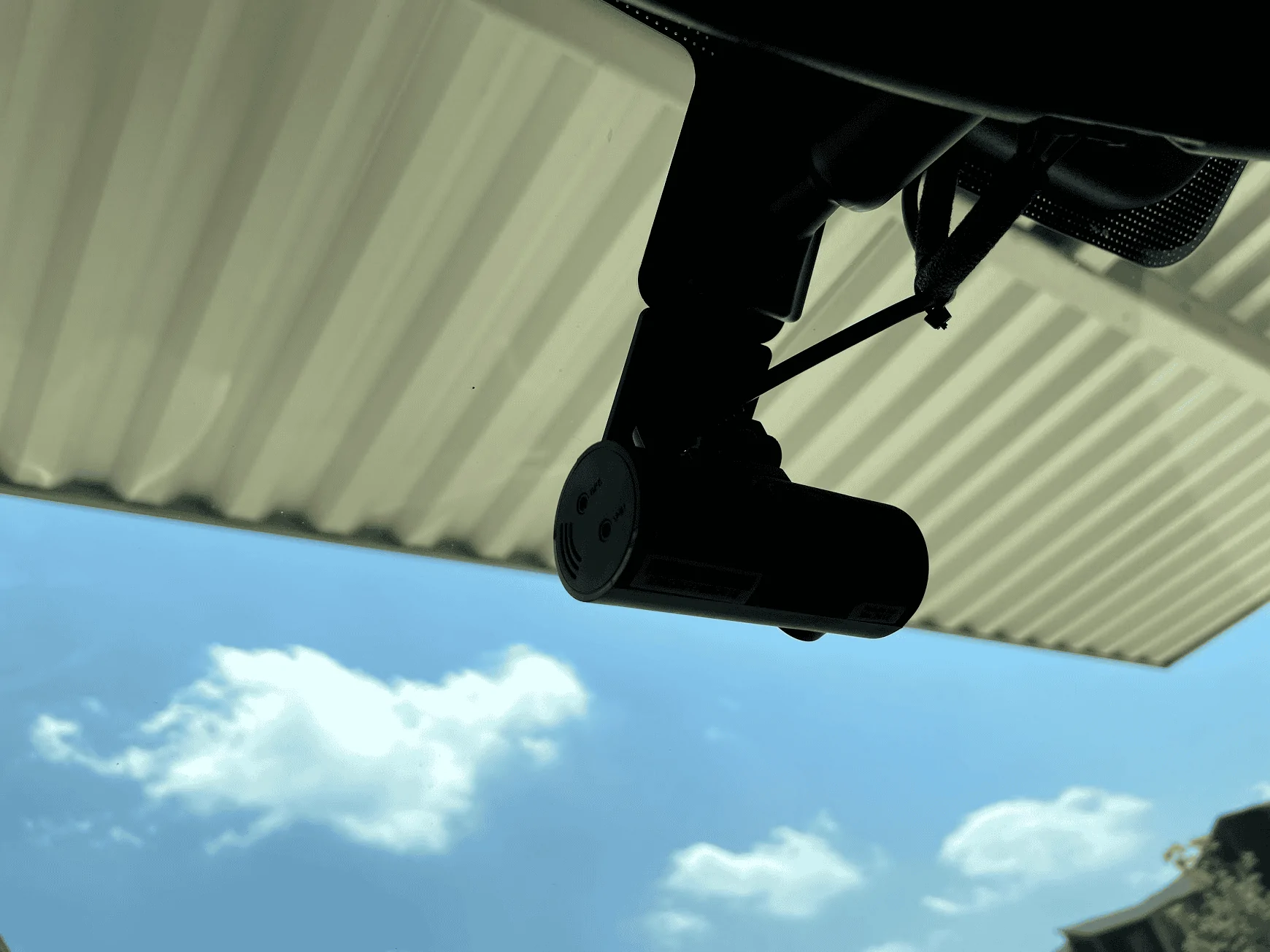

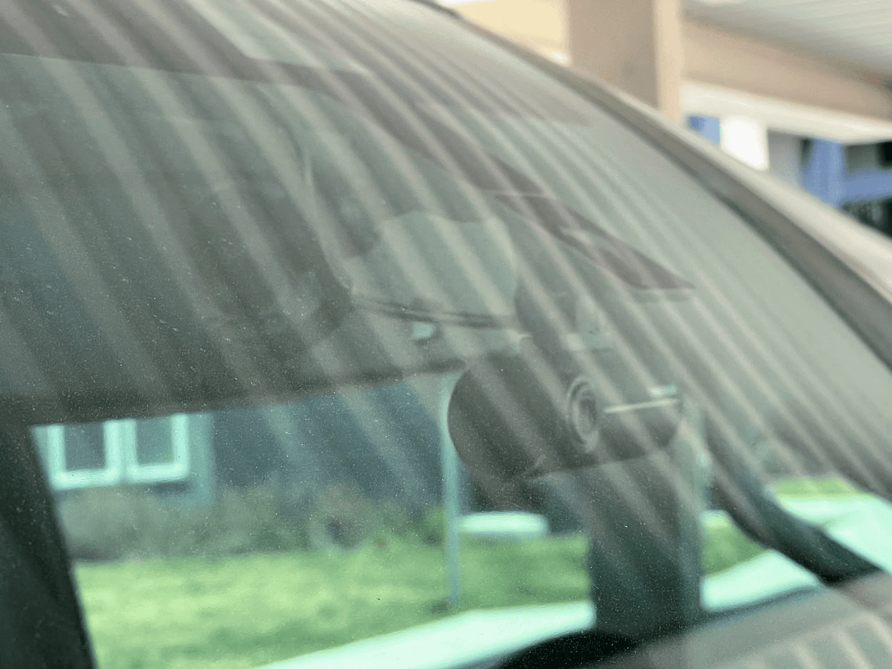

I think a better use of your money would be to get a known quality dash cam and have it professionally installed.
I'm currently running a Thinkware F100 w/ hardwire kit. Had it installed for me, looks great and almost stock. No special software needed, I just remove the sd card and I can get to the files just fine.
