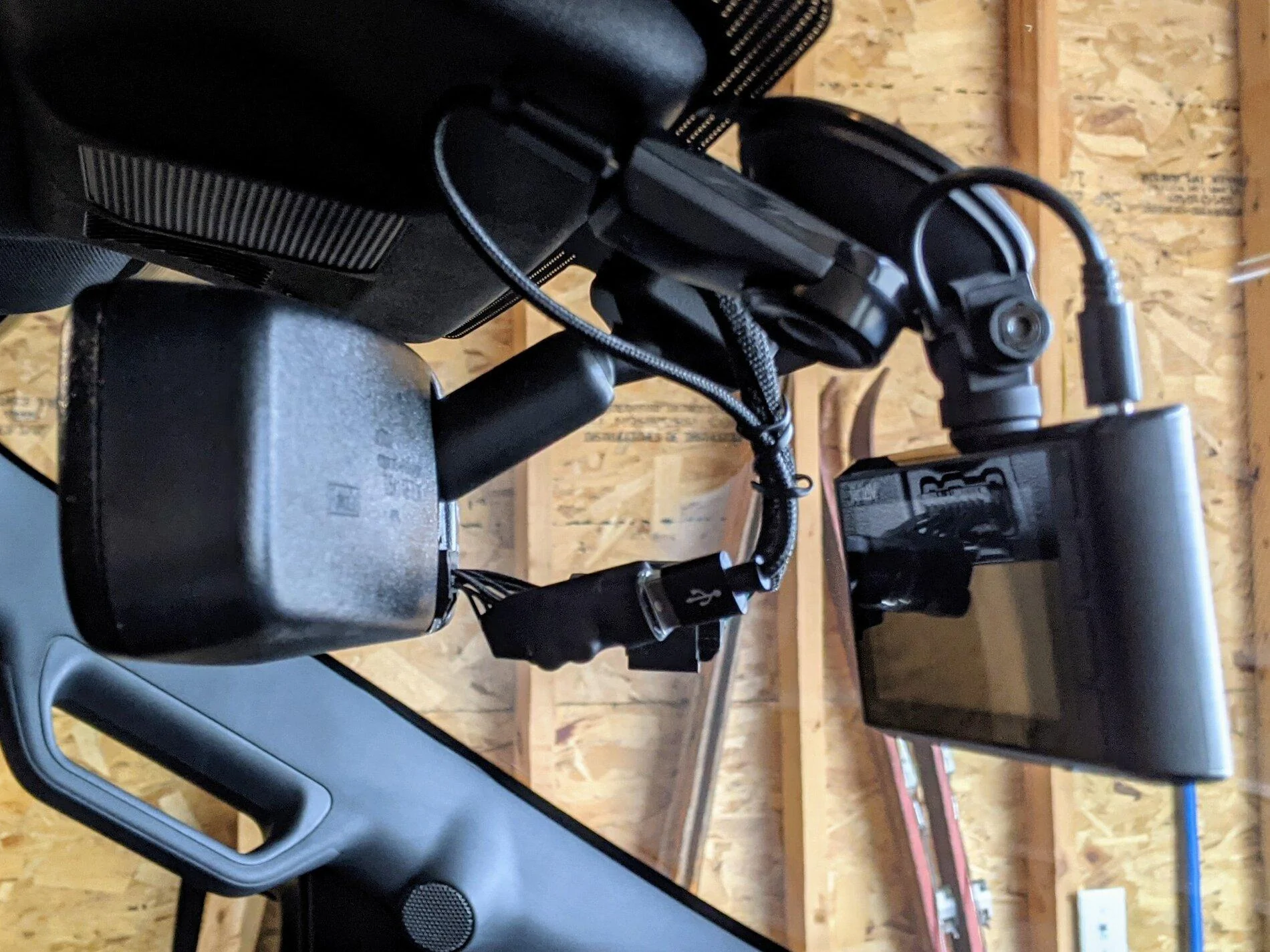

For my '21 I went with a rexing dash cam and a wiring plug that goes right into the factory plug on the rearview mirror. I highly recommend it, especially after spending way too much time installing a dash cam on my wife's Volvo that required removing a bunch of trim panels (and breaking tabs on some of course), snaking wires, tapping/splicing wires, and a lot of cursing.
The entire install on the F150 with the plug took less than 5 minutes. No removing trim panels, accessing fuse boxes, running wires, etc. Just unplug the harness from behind mirror, plug in the Dongar SImpleUSB plug, plug in the camera with the supplied short USB cable, and mount camera to windshield. Done.
The Rexing camera gets the job done for the price, has 4k resolution, and has an app that makes it easy to pull the recordings off it, right onto your phone.

Do you have any pictures of your installation?
