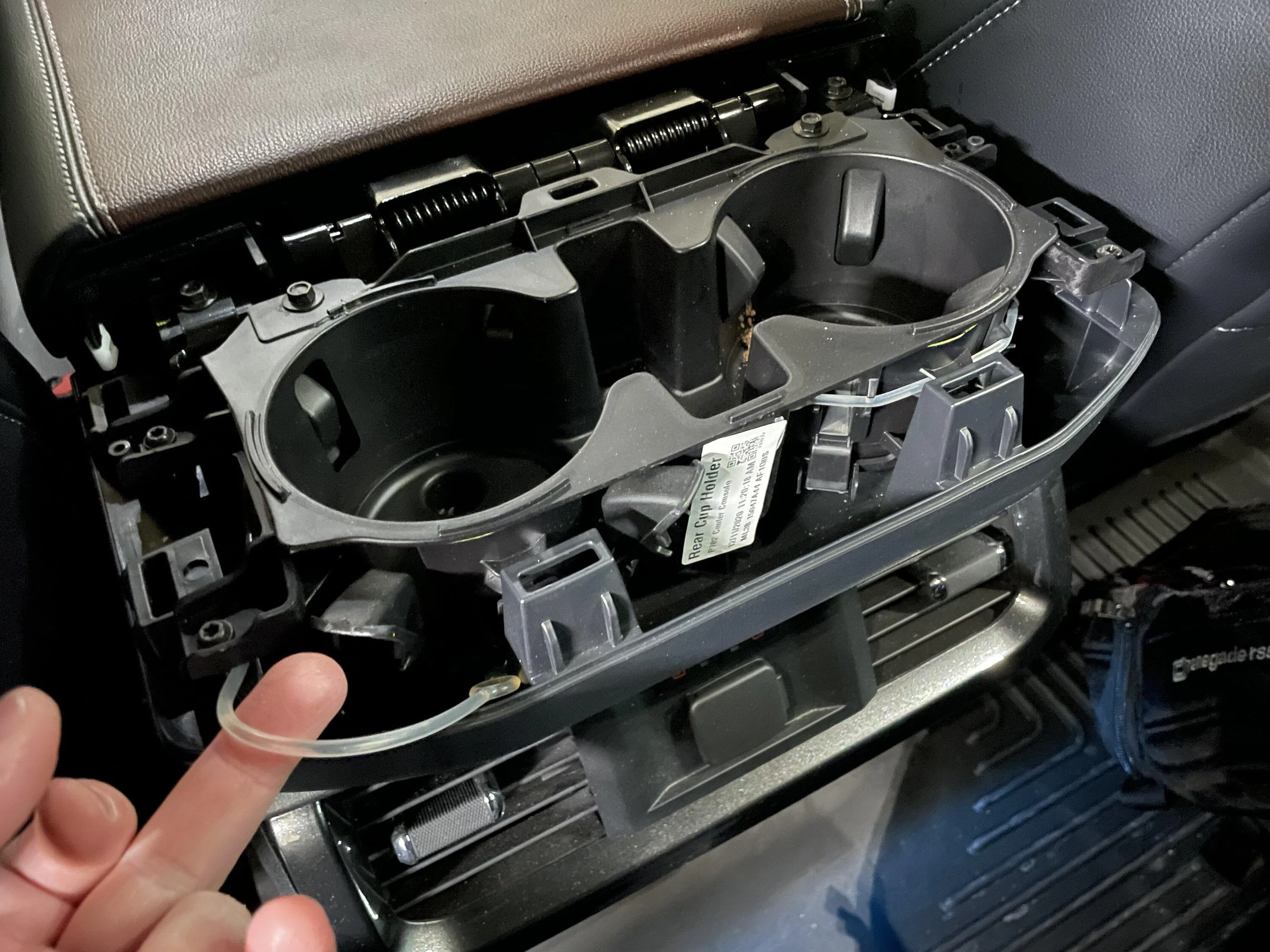

What are the steps to remove the rear cupholder assembly? If you tell me where to start I can most likely figure out the rest.
Open up the center console and there’s a rectangular trim piece that has to be removed just under the lid hinge. Pull 3 screws behind that trim piece. That allows you to pull the top trim piece off of the rear cupholder. There are several screws to be removed from that. I think it’s 7 total, 4 surrounding the cup holders and 3 under the rubber piece in the cup holders. It’s been a month or so since I’ve removed them, so I’m recalling them all from memory

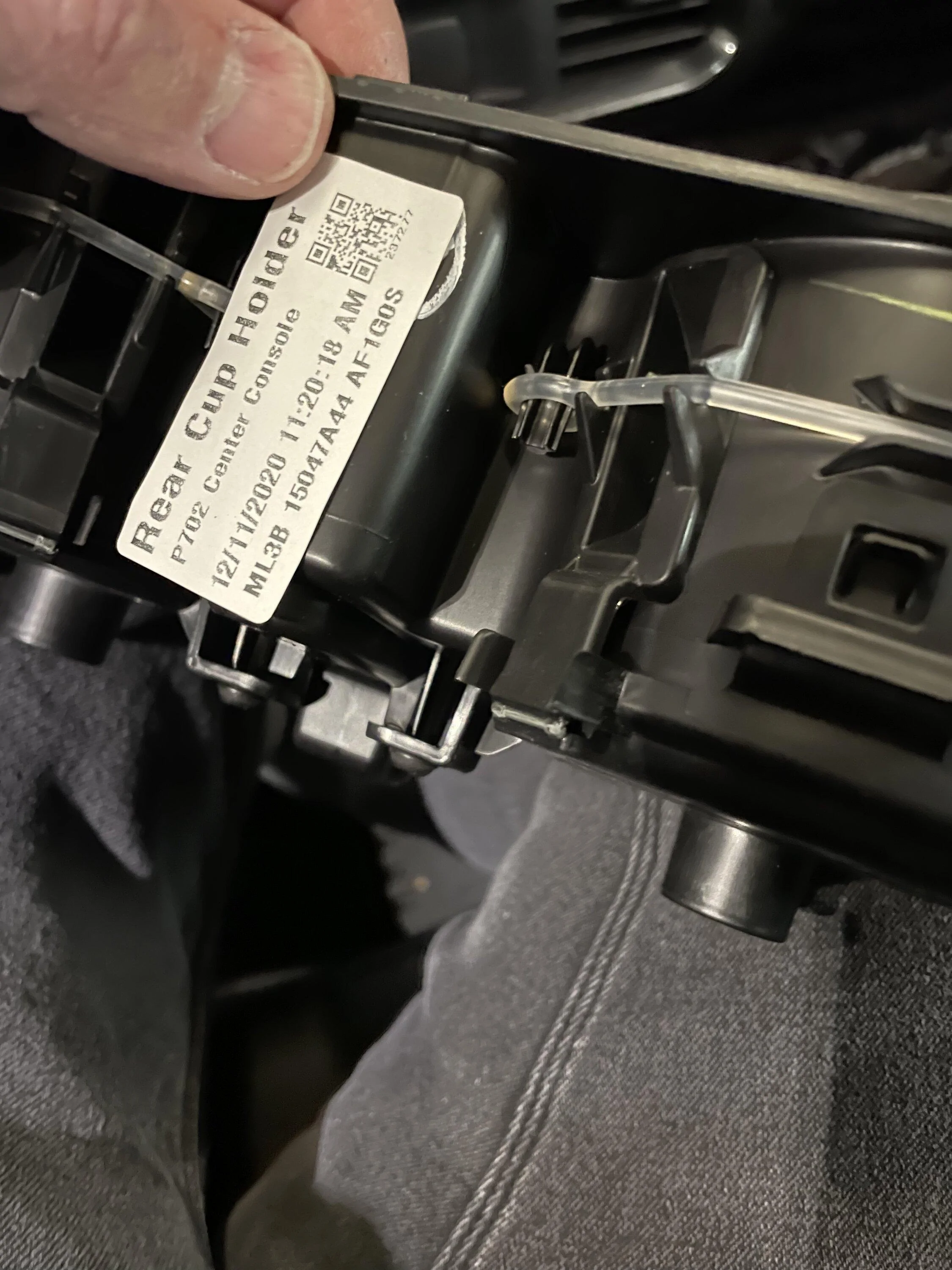

The tension spring busted in one of the cup holders that sit at the back of the center console arm rest. The little “fingers” that apply pressure to hold the cup in place no longer apply pressure so the cup is able to flop around. I had the dealer look at it under warranty while in for something else and they said Ford discontinued that style cup holder because they keep breaking. They’re now supplying just a wide open cup holder with no tension spring to hold the cup steady. I told them not to put the new one in as I figured I’d rather have one with tension spring than two that don’t have the springs. The part comes as one complete unit for both cup holders. Not a big deal but you’d think after 30 years of providing cup holders they’d know by now which style works and what doesn’t.

Thanks for all the help guys. I pulled it apart today and found that the band had just slipped off.
Pretty lame design really. Would have been fine if they’d just used something on the end of that tab to keep the band from sliding off.
The mounting of the cup holder itself however, seems way over-engineered. That cup holder isn’t going anywhere with the 11 screws that secure it. Overall way easy fix and now my water bottles won’t fall over.
I’m stoked I told the dealer not to replace it with the new fingerless model. Good as new!
