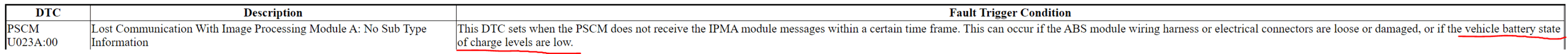

It finally worked but now I am getting new errors. I know there's a tsb for the U0415:86 code for the one in IPMA TSB 22-2214
Will they clear?

Well these are all loss of comms and are normal while udpating. ANy update you do VIA canbus will trip a bunch of loss of comms

For now I will only update the ABS module tomorrow according to the TSB saying if U0415:86 shows up in IPMA, do a software update. The update fail with IPMA got me honestly spooked and iffy about doing updates lol. I erased codes again and for now B152E:55 and U0415:86 in IPMA and U0415:00 came back in PSCM. Ill follow tsb 22-2214 about updating abs and I do see an update available in FDRS that I will try tomorrow. The PMI went through on first try on IPMA with the mongoose cable that come today, so thank you for the help thus far. All of these issues with updating makes me question why they don't have a failsafe in place to put everything back to the way it was before the update in case it fails.

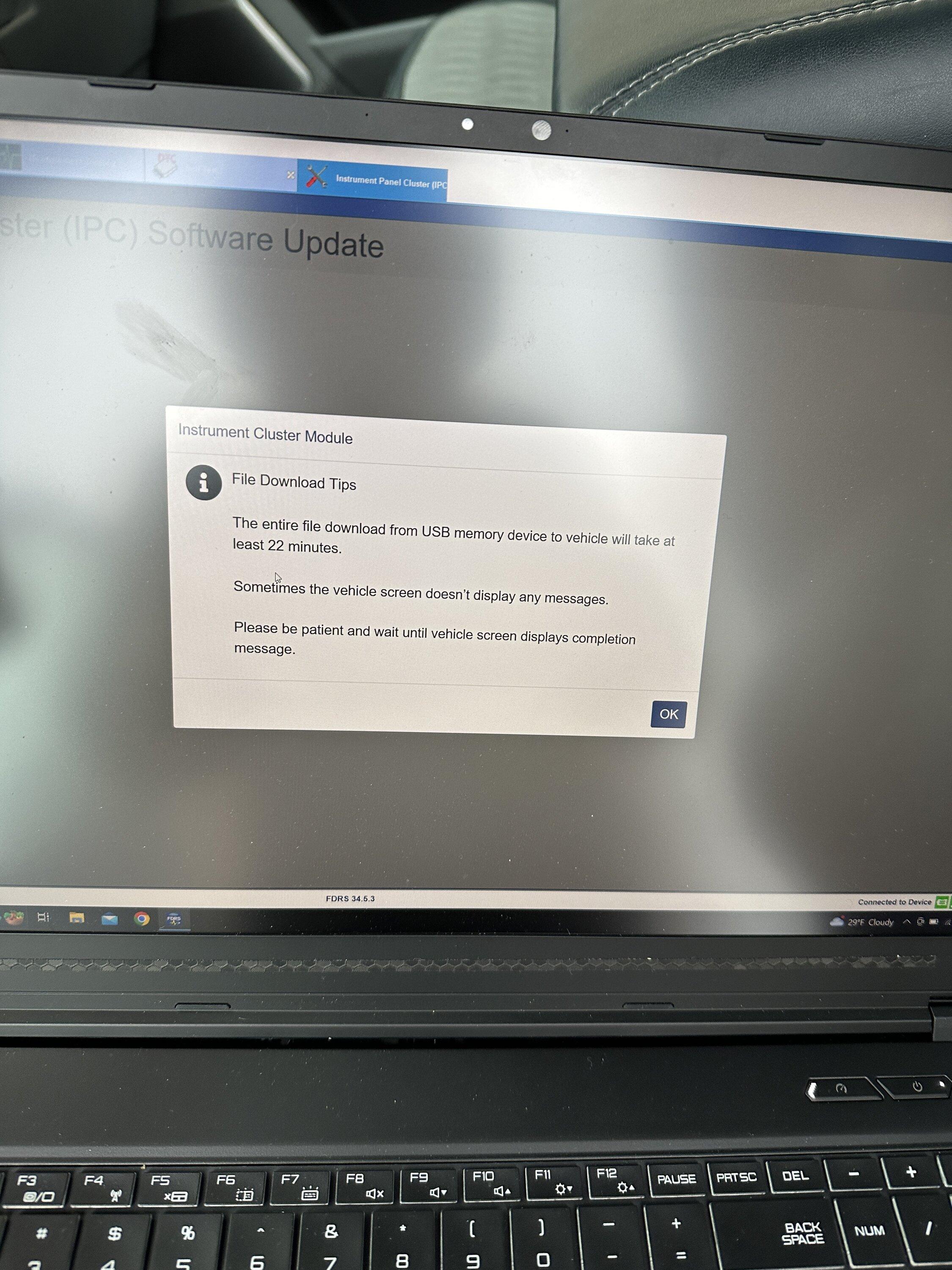

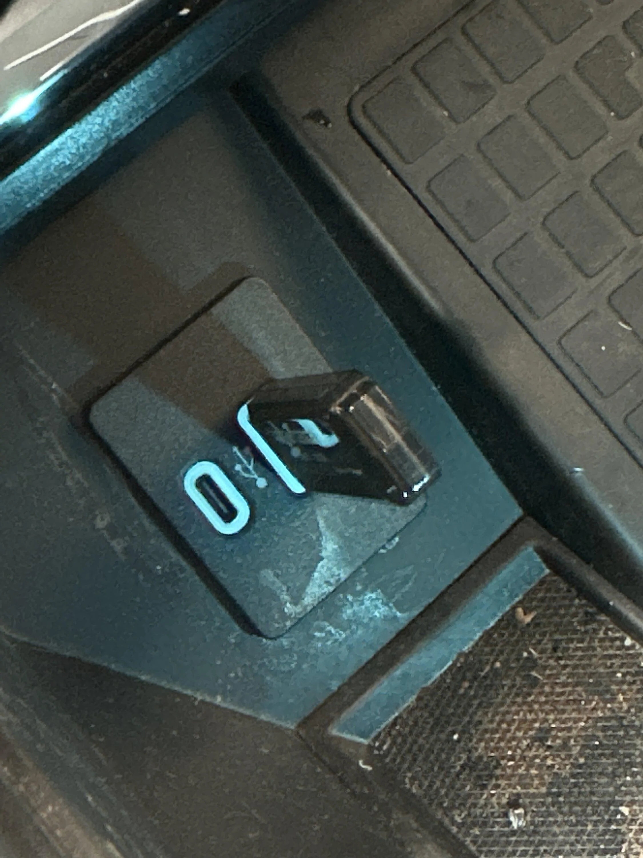

I’m trying to do the IPC update via usb, it didn’t show on screen not to remove the usb, it just showed usb indexing in the beginning and that was it, how long does an IPC update typically take? It’s been about an hour now and nothing still

Turn truck off and leave usb in
Wait 15 min.
Turn truck back on and wait for the sucessful message. You proably jsut missed the restart messgae
onodelta
Dec 31, 2022
62
United States
Wait 15 min.
USB route didnt work, I had to go the long route with the CAN update, took 6 hours but it finally finished, thanks for all your help Jesse
