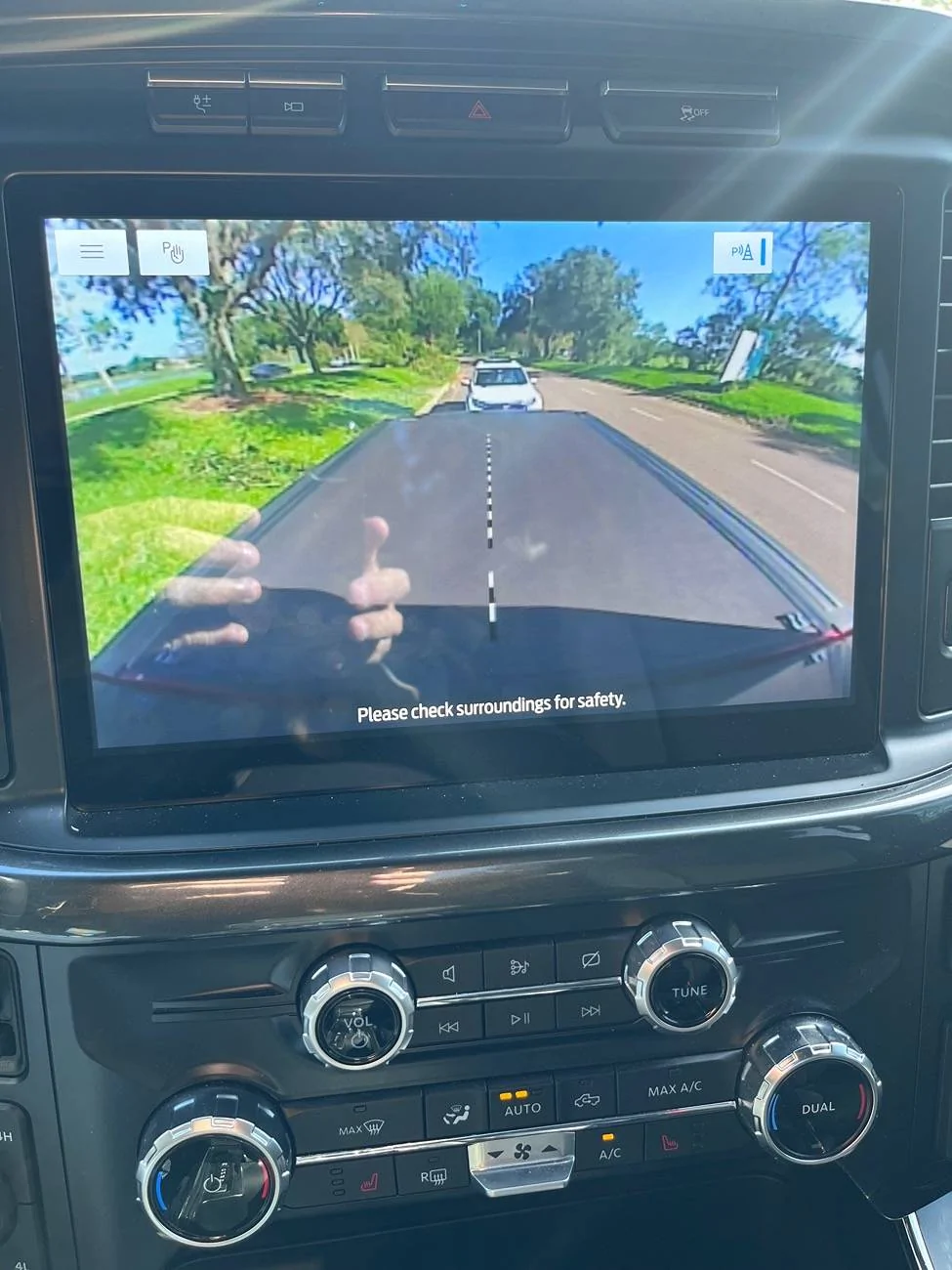

Glad you didn't have to experience the flooding but on the other hand would've been nice to see how waterproof the system is ?.

Update! With a few good 20 mile runs on expressways, turnpikes, and interstates my passenger side mirror camera dried out and started working!
Wait. Up until now, I thought that was your front-view camera. How do you engage a side-view L/R camera MODE?
The 360 degree overhead view(on the right) is a combination of the front, rear tailgate, and both side mirror cameras stitched together. The other view(on the left) is the front view just as you thought.

Ford camera guy (specialist) replaced my passenger side mirror camera and the common amplifier that serves it. Zero issues since then. Warranty work.
