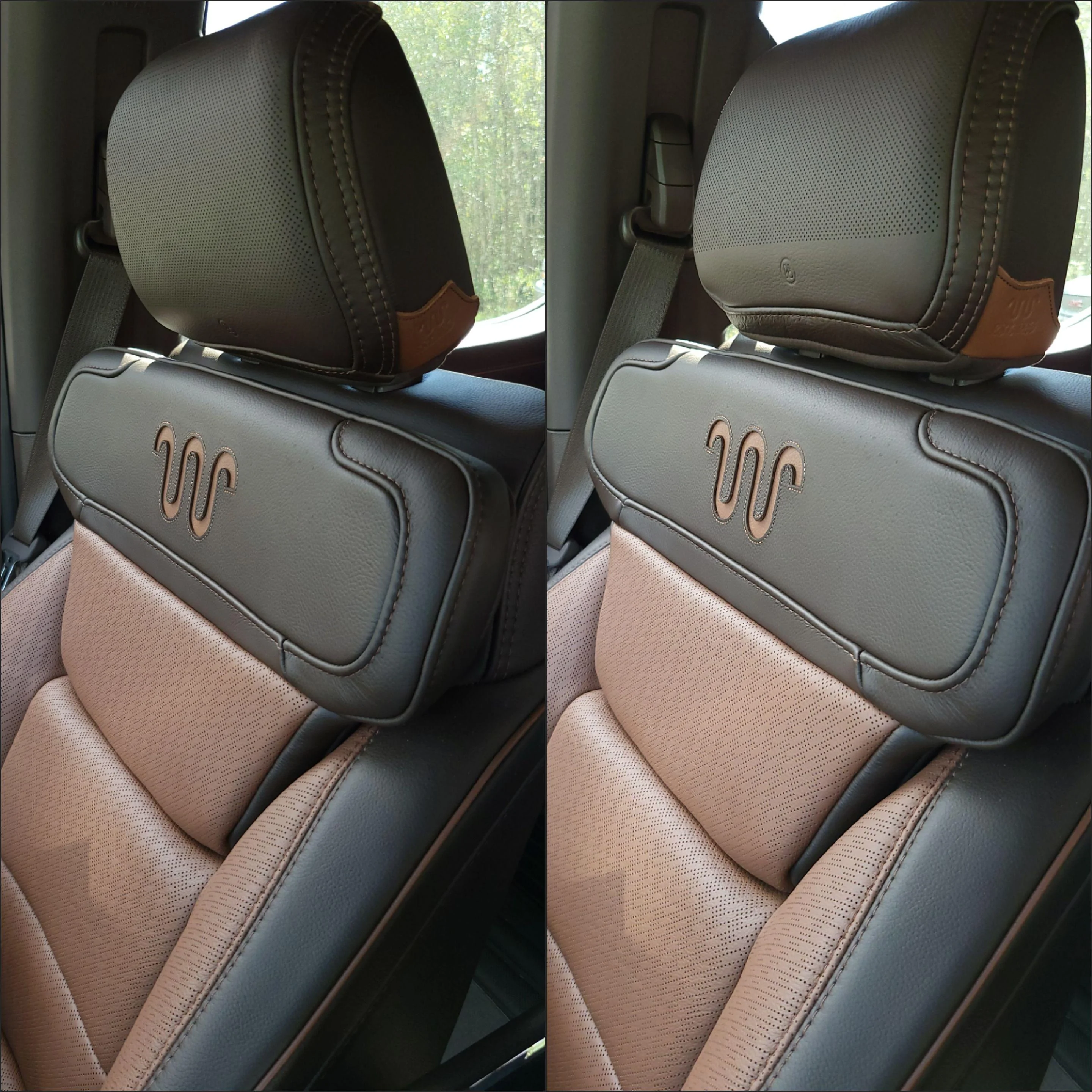

2021’s have the adjustable head rests? source?
My 2021 & 2022 have adjustable headrest. Isn't it a trim level thing?
You mean this?

Not true I have a 22 Lariat with B&O Unleased and my headrests are not adjustable. The 21 lariats had them. I have been on the look out for some 21's with the speakers for a while.

We 2022 and 2023 guys never had the finger cupholers at the back of the center armrest to begin with. I'm guessing you have adjustable headrests that we also never had (not on Lariat and below, anyway).
Best to keep the semi-broken one and maybe try your own fix, I agree!
My ‘21 lariat has adjustable headrests. May be related to the b&o upgrade.
