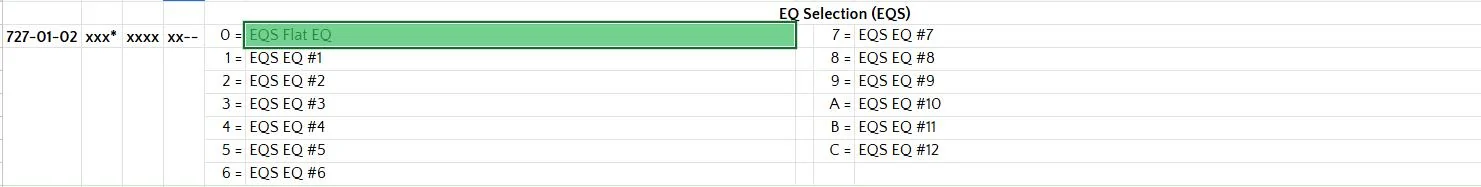

Yup, however, it mainly applies to non B&O trucks, since the ACM is upstream of the DSP for most of the B&O speakers.
I got a ton of extra sound by going to the flat EQ.
Correct, but the rear door speakers are powered by the ACM and not the DSP which is why this caught my attention. By flat setting, are you referring to this? If you are, mine truck is showing a 0 there already from factory. Unless the data on the motorcraft site is wrong. I'll check what FORScan shows later tonight when I get home from work and plug in.
Yup. 0 is flat. Makes sense as the B&O DSP probably makes best use of the full range for the speakers it handles. Non B&O trucks came with a 1 or a 2.
Let us know what sounds good on the rears. There is full range, tweeter only and non-tweeter only IIRC.
This is what the spreadsheet shows, and according to the online data, I have a 1 there now. I'm going to try a 2 to see what happens. If I hadn't left my laptop at home, I'd be in my truck doing it right now. lol

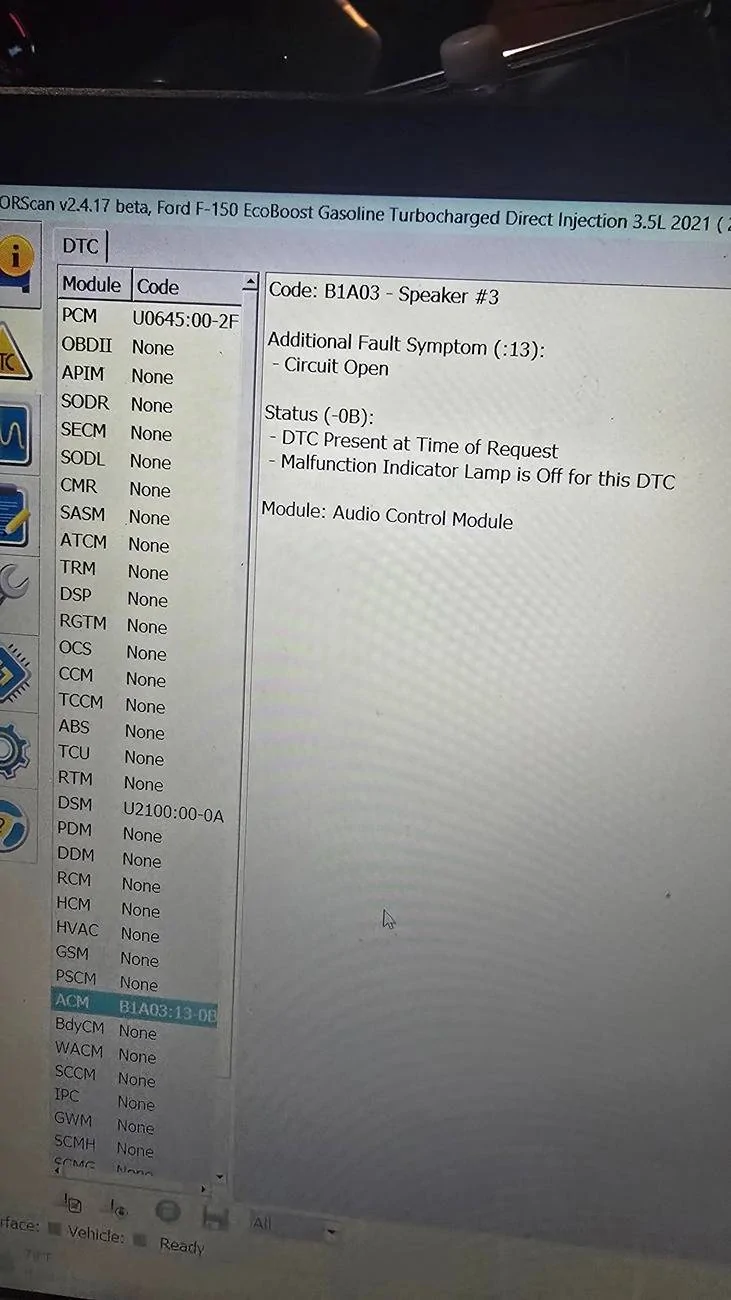

I now show this code after making the ACM change. However, I tried playing two songs at full volume that I know would make the rear aftermarket tweeters clip before and I heard no clipping. So far, I have to say this DID improve sound quality at high volume, but I will continue to test and see if I find a song that makes it clip.
I've had this code for a while but for the center speaker after changing its output. Harmless afaik. The speaker is securely wired and still makes the right noises.
Yea, I'm not worried about it. I tell people all the time: Codes are not problems.....only problems are problems. lol

No DTCs on my XLT.
