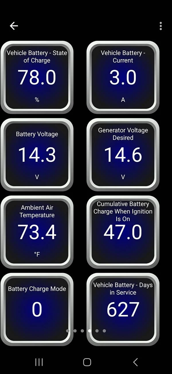

I'm interested in that screenshot... Wha
Theres nothing to change. I went from an H6 to an H8 and haven’t had any issues. The H8 has been in for 627 days now and doing great!
What is that from? How do I get that info for my vehicle?
Big Dog Daddy
May 27, 2021
2,453
3,934
New Jersey
I purchased an ODB MX+ Bluetooth adapter from Amazon. It has a free app in which you can download vehicle specific PID's for Ford, and then you are able to build custom dashboards on your phone or tablet. It also allows you to read and clear codes from ALL Ford modules as well as many other features. such as logging, monitoring and diagnostics.
Amazon.com: OBDLink MX+ OBD2 Bluetooth Scanner for iPhone, Android, and Windows : Automotive
