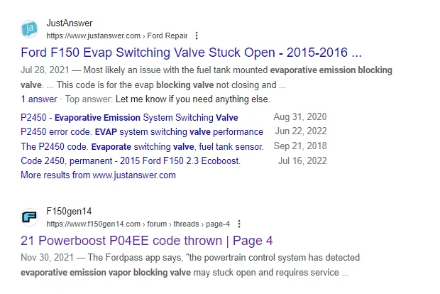

This is the only thread that appears in search: https://www.f150gen14.com/forum/threads/21-powerboost-p04ee-code-thrown.7218/
Seems a little more common on other Ford forums and could be the result of either the gas tank filler flapper OR the valve near the gas tank.
