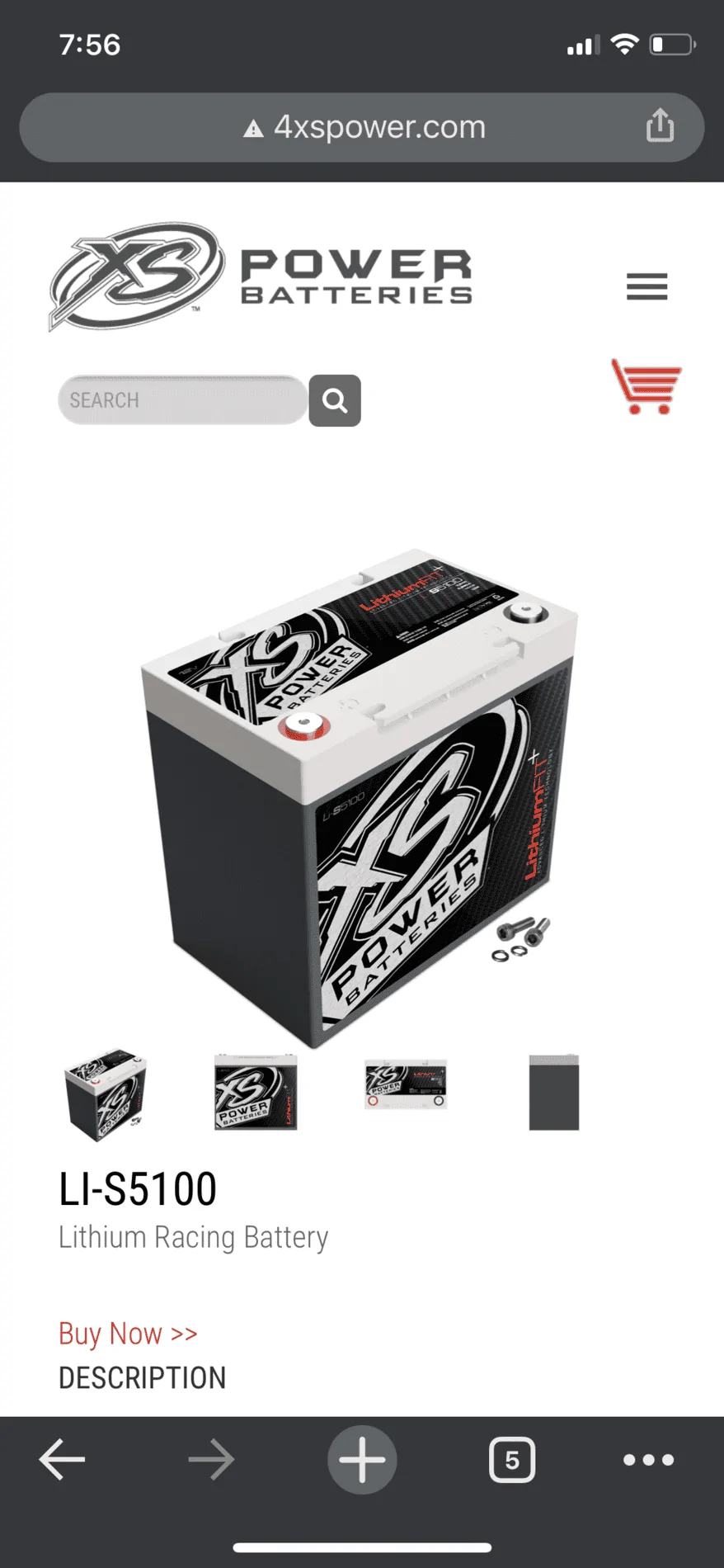

I installed a 40ah Lpf behind the seat. Removed the jack and auxiliary battery under rear passenger seat. The pos and neg leads just connected to the new battery. 5100 seeies fits nice. I have a powerboost with 7.2k. Deleted bms and I charge at 14.6v all the time.
Ford F-150 Can you get a secondary battery for the engine? C14CDAF4-DF8A-40CA-82A0-BFD328136B53
based on this the truck has 3 batteries (Starting, aux and the power boost battery under the bed)?
I’ve added a fridge and was looking to install a house battery and run it on 12v vs 120ac and it sounds like Aux battery upgrade is way to go. Thanks for the info
