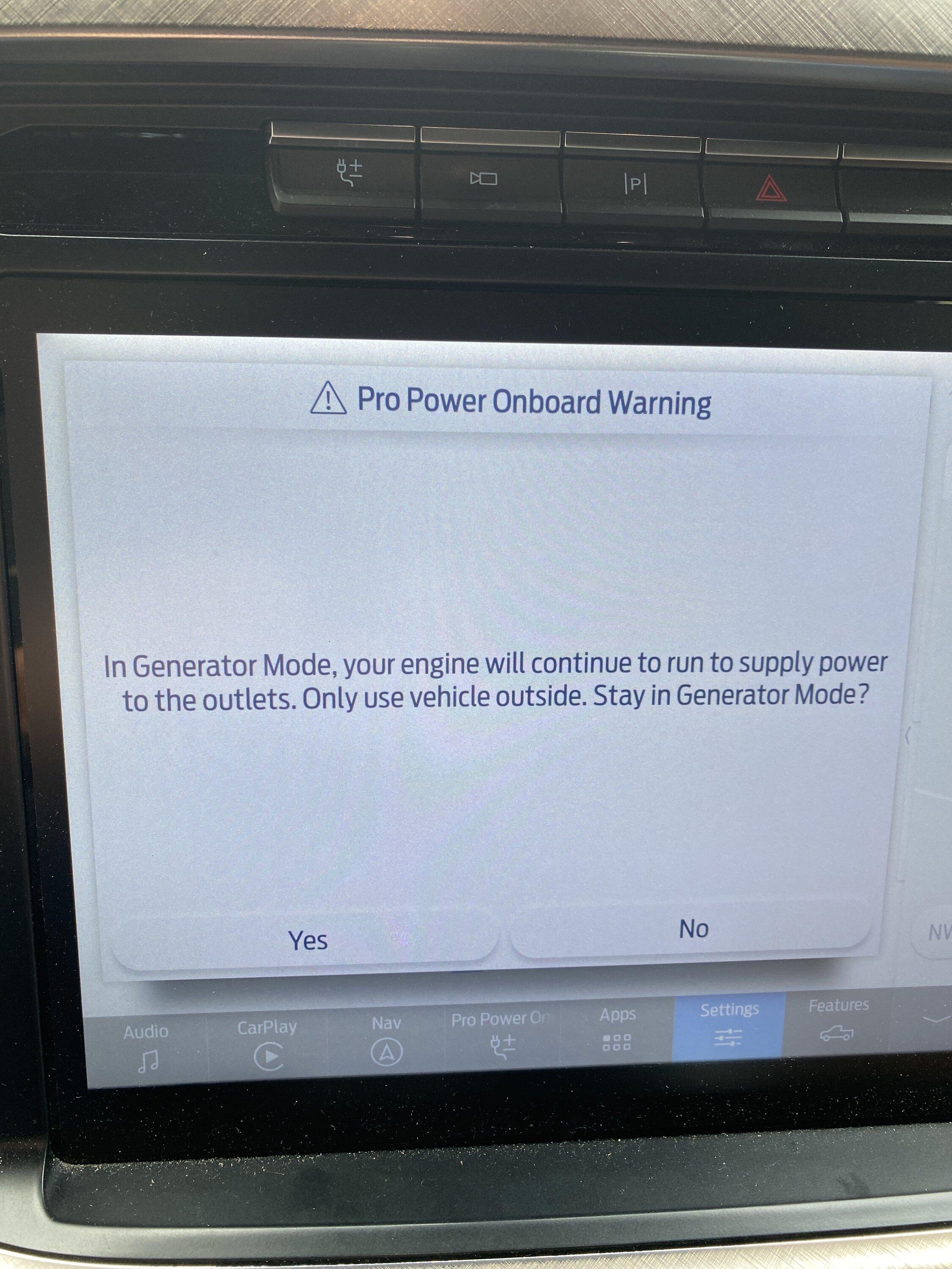

I got an update at some point that did the same --- If you read the warning and follow directions you can shift out of park ;)
Ford F-150 Can’t shift from park using pro power 1695959363647
A recent PCM update added that "feature" to my 2022. So now, like HammaMan's picture above, I get the prompt and have to say OK before I can drive the truck with anything plugged in.
So I agree with others that you have some kind of software bug that is not providing you the prompt.

Message on my screen, note however this is using internal plug. It comes on every time you open drivers door with pro power on. You don’t need to do anything, close the door and drive away, message goes away and pro power stays on. Im pretty sure I’ve used the box plug and it’s the same.
