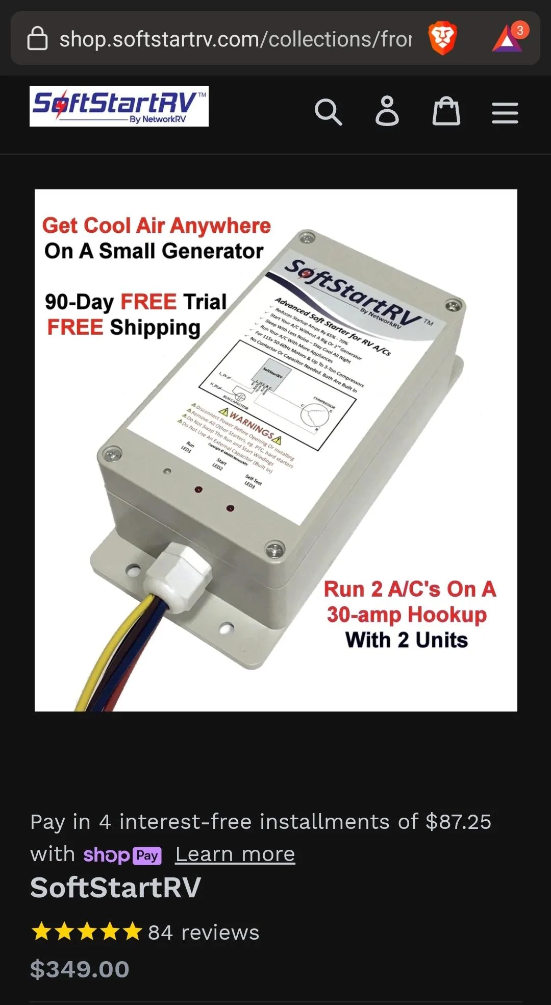

I realize I am commenting on an older thread. Hopefully somebody is still monitoring and can help explain in more detail. The behavior that has been documented as well as the behavior that I've observed when using the powerboost with my RV.
I understand the basic electrical math that volts times amps equals watts, I also read that the travel trailers are typically wired for 120 volt feeds only. So a 30 amp connection at 120 volts will max out at 3,600 Watts. I understand that math, but I am having a difficult time reconciling that against the behavior I've observed with standalone generators connected to my RV, The RV park provided 30 amp connection and the powerboost 30 amp connection.
If all 3 30 amp power sources are providing power to the RV trailer at 120 volts, then all three power sources should exhibit similar behavior that they cannot provide more than 3,600 Watts of continuous power at any point in time... Yet, the behavior that I have observed is that I have never had a overload error or issue when using a standalone generator with a 30 amp connection or when using the RV park provided 30 amp power. I have only ran into an overload error when using the powerboost to power my RV.
I have a small 19 ft travel trailer with a 15K BTU air conditioner (Coleman Mach). Based on the specs that I have researched, it looks like it requires 3,900 Watts starting and continuous wattage of 1,560. Based on the math above, my trailer should not be able to start the air conditioner simultaneously while running anything else or be at risk of a power overload fault... However, when connected to an RV park provided power source or with a standalone 4,500W generator we have been able to run not only the air conditioner and all the lights, but also the refrigerator, the convection microwave and a small built-in vacuum simultaneously without ever tripping a breaker or having a power overload fault.
When connected to the pro power onboard generator we have only been able to effectively run the air conditioner, refrigerator and lights simultaneously... Anytime we try to simultaneously use the convection oven or the vacuum, we are immediately greeted with a power overload error on the display screen in the truck. Similar to the other individual's observation, I only see the B leg of the pro power generator being utilized and once it exceeds the 3600 w limit the truck shuts down and displays an error message.
I think I understand that I can only use the A and B leg from the pro power generator simultaneously via a 240 volt connection, which I also think my trailer is not capable of... But what I don't understand is why do I have different behaviors when using a medium standalone generator or the RV park power pedestal versus when I am connected to the powerboost.
I appreciate any insight that can be shared. I acknowledge I am pretty ignorant when it comes to electricity and so appreciate small words and simple explanations ?
I live in a small 30 Amp EV hooked to a shore power 30Amp RV receptacle behind a 30amp breaker in a 125Amp service panel.
I also have powered this RV from the Powerboost ProPower generator on now many occasions. (actually 2 different Powerboost trucks)
While I admit that the shore power 30amp breaker will not trip immediately, if I am using a second high wattage "device" while the AC compressor tries to cycle on, the 30amp breaker will throw.
The Powerboost is only a little quicker to do the same.
My Air Conditioner is a Dometic Brisk II 15,000 BTU as well.
By "second device", I mean microwave oven, air fryer, or even sometimes the electric tea kettle. It's simply the math.

Ditto with Snakebitten, Wheaties. The power pole breaker at the RV Park and the F150's 120V 30A breaker share the same design limits. They may behave differently for a variety of reasons including the age of that RV Park breaker. But as Snakebitten concludes....it's simply math and 30A is 30A.
I'm guessing the reason you raise this question is that you can't carry the load you want with your other appliances and still have your air conditioner cycle on & off. As you noted, the surge current on A/C start-up can exceed your 30A current draw limit while also using the other appliances. So I would suggest installing a 'soft start' device on your A/C unit. The Micro-Air product is the one I've seen most commonly recommended (see e.g. Amazon), and I found its quality and install instructions very good. This device will slowly ramp up the current delivery to the A/C compressor and, in my experience, it does not exceed on start-up the normal ongoing current draw of my Domestic A/C unit.
Jack
I indeed have one of those softstarts. It obviously doesn't increase the amount of load that my shore power breaker or my Powerboost will tolerate, but it nips that momentary spike, which definitely gives me headroom I didn't have before when the compressor cycles.
I recently purchased this one: (Although at a pre-inflation price)

I appreciate the input and confirmation. I will be investing in a soft start ASAP.
