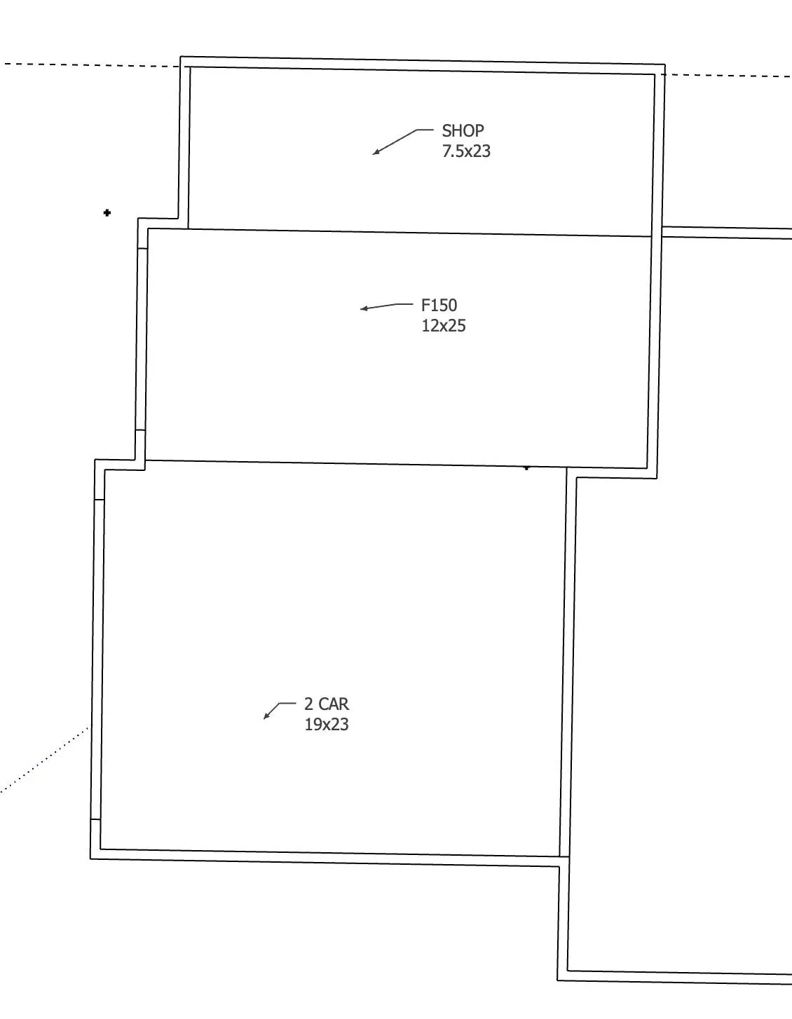

Looking for some serious answers here, not joking. We are in the process of designing our new house thus trying to decide what will best fit an 2022 F150 xlt crew cab with 6.5 bed. Probably will be doing a 3 bay garage with 2 doors one 9' other 16'. The single bay will not be on the same plane as the 16' in order to break things up and will house the f150. Right now thinking 12x25 foot area.
All input and photos are welcome and what you wish was different about yours!

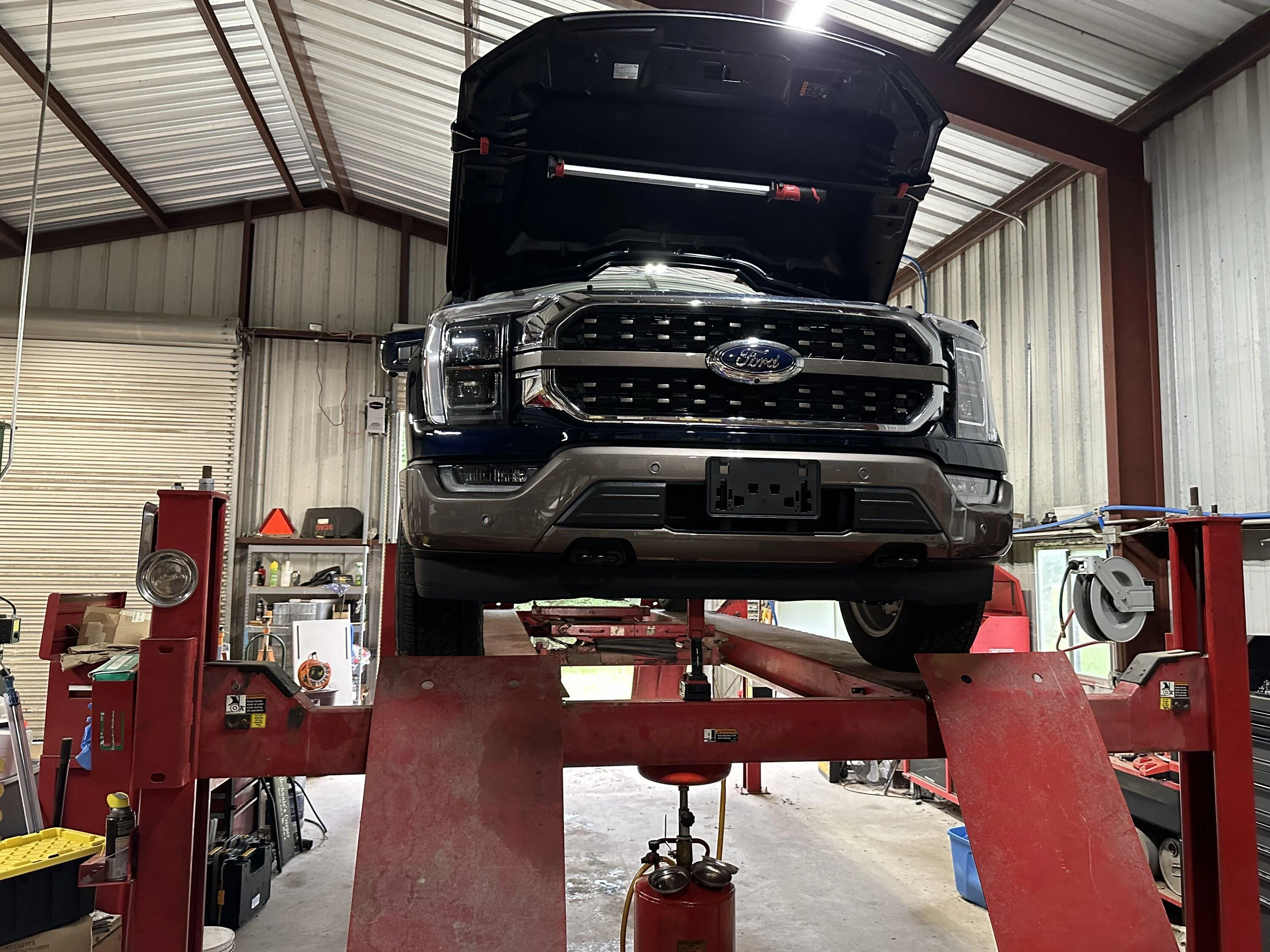

i have 26.5 by 46 rv garage...i used to be able to park truck or expedition in there plus one other car
NOW i need more room as the car parking has been taken over by a lounge area for me and the dog. plus all the tools. and a mezzanine ( loft :eek:)
hindsight.....40 x 100 and i think i would be ok

That is one thing I would like! Have not decided on ceiling height. Which since attached will probably depend on height of the house rooms Have not decided if living space will be above garage as well and if so it will need to match that of the house.
Regardless we are deciding between 9 and 10 feet, for the first floor. Since we are going for 2 stories we are limited to a 35’ house height. Garages usually sit one step down from the house here. So that gives 7” extra . The lot also slopes left to right. The two furthest corners; front right to rear left, have a 12’ difference that eats into the 35’ overall. The city takes lowest to highest point.
if I did a lift it probably be a 4 post storage lift. Which does leads to another question. I have to go back and read the code, but we follow the IRC which I think says the garage floor must be pitched to the opening. Which presents some challenges when installing on a slanted floor.
I have looked at lifts but not the installation instructions.
