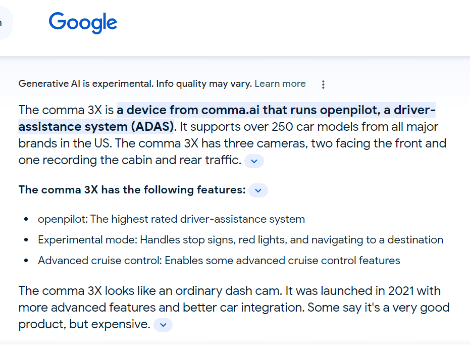

What is a 'comma 3x'? Remember our discussion about the use of jargon?
That's its name, it's not initialism.
