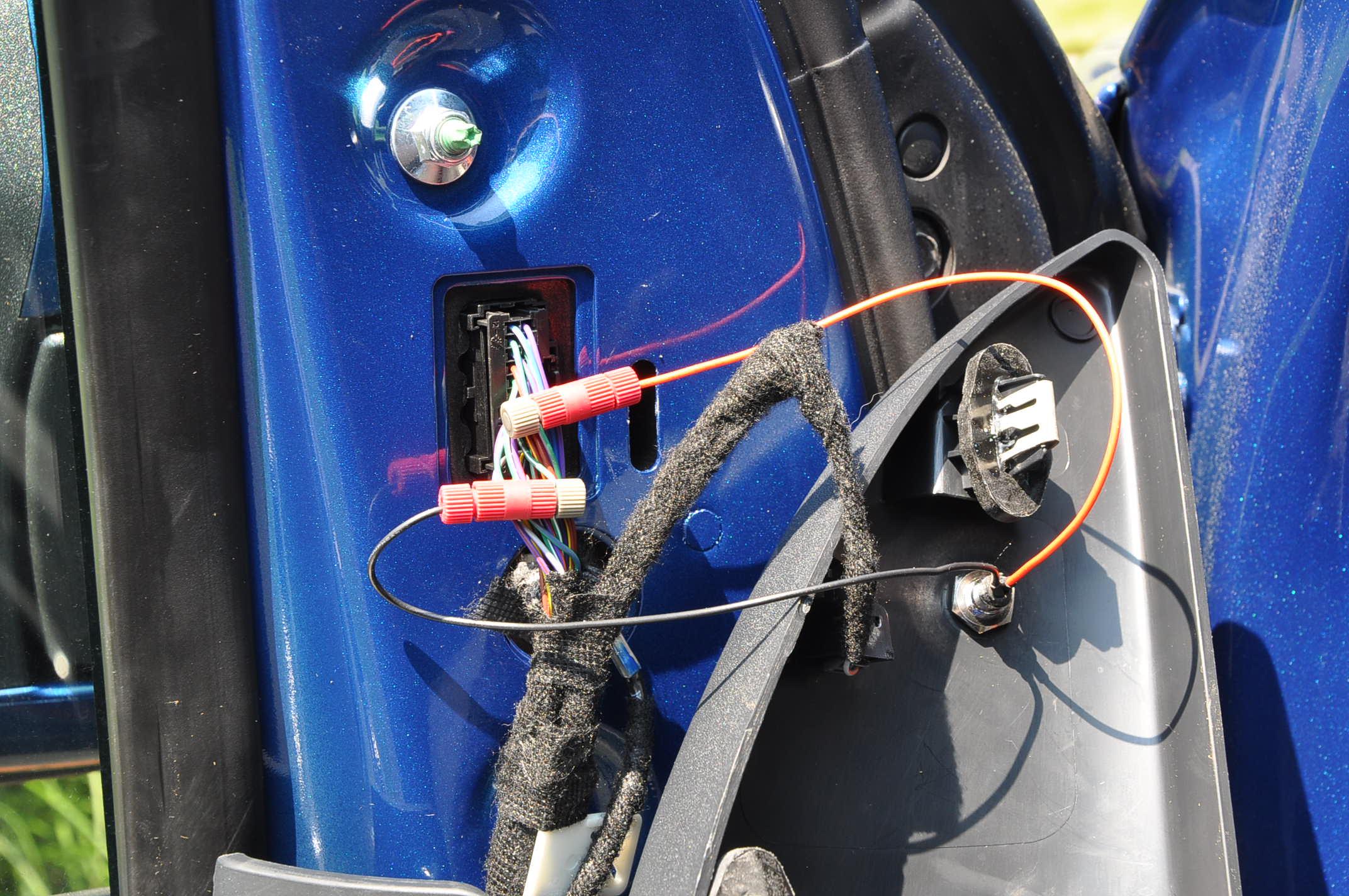

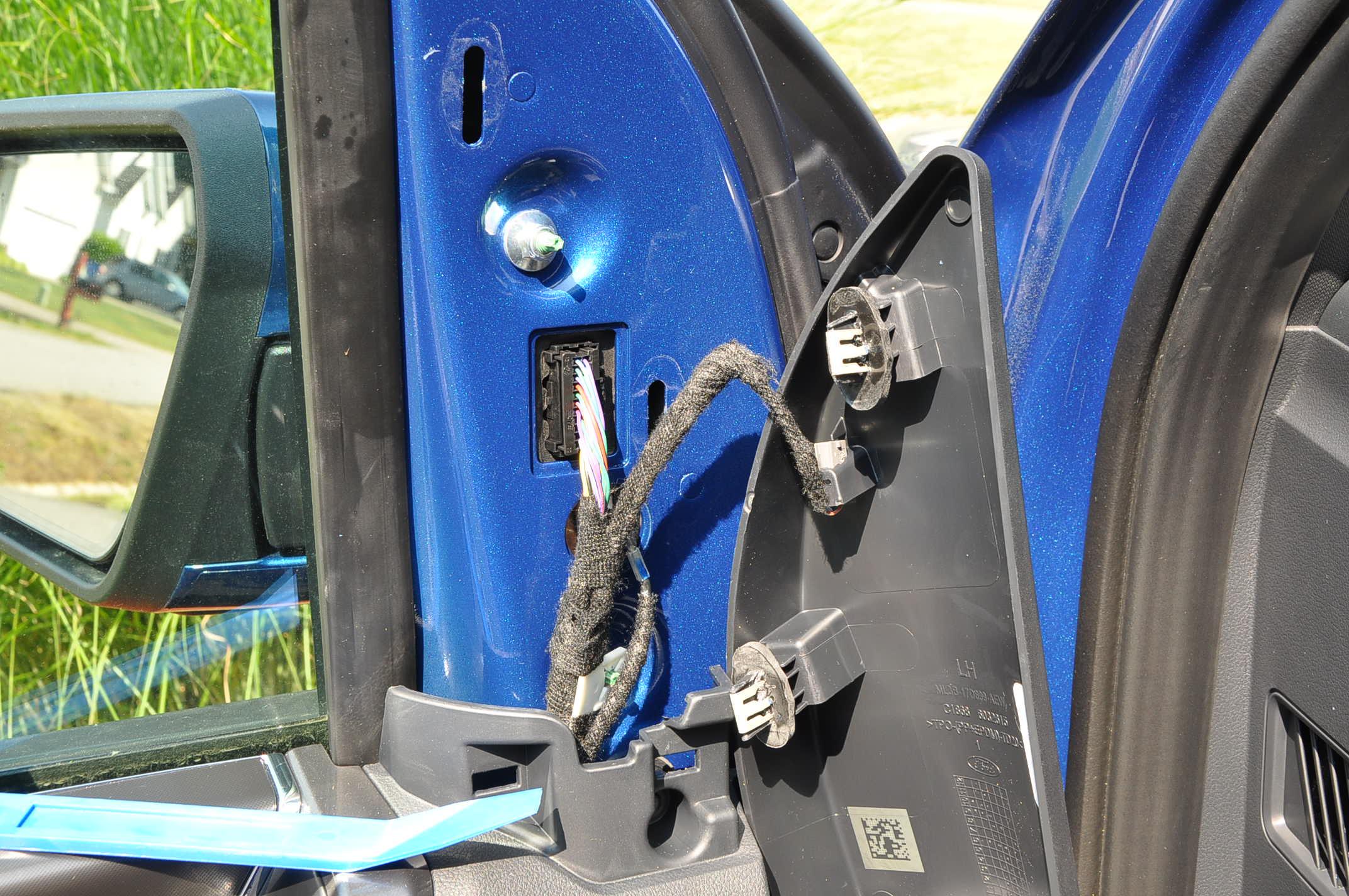

This next picture shows the truck’s interior cover for the mirror wiring. This could not be more convenient.
In the wiring diagram for the LEFT BLIS MIRROR (Driver side) you will see the diagram for connection C521. This shows that wires 13 and 20 are the wires that are connected with the BLIS alert in the mirror. In the picture you will see the test set up with the LED positive lead (orange) going to wire 13 and the LED’s ground wire (black) going to wire 20. This worked perfectly with the truck’s regular BLIS alert in the side mirror and both the alert and new LED activated together. I used the Posi Tap 20-22 gauge to tap into those original BLIS wires (13 and 20) to make my connection for the additional LED.
NOTE: In the wiring diagram pdf (at the bottom of this post) you see what the wiring diagram C521 would look like from the other side of the connection. When you look at the wires after removing that cover you are seeing a mirror image of the wires in the pdf. You can tell by the side that the locking connector is on and space 21 has no wire in it. Use this missing space (21) as your guide.
NOTE: The passenger side connection (C622) was actually completely flipped over in the truck. Again you have to use the empty wire space (21) to be your judge. Wires 13 and 20 are the also the BLIS wires for the passenger side so use their location in relation to the missing 21 wire and look at the wires colors in the wiring pdf file. Just double check, and it is easy.

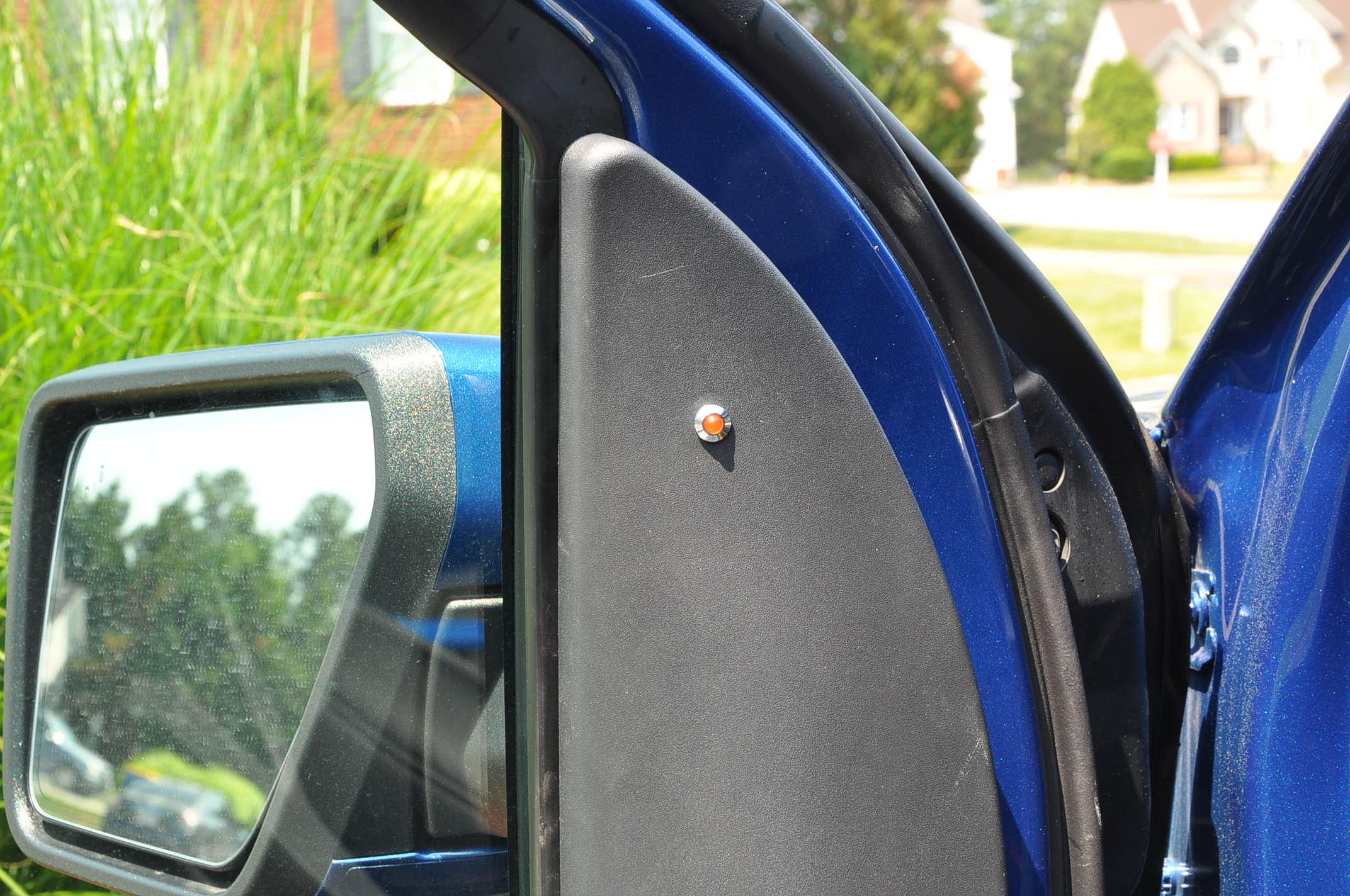

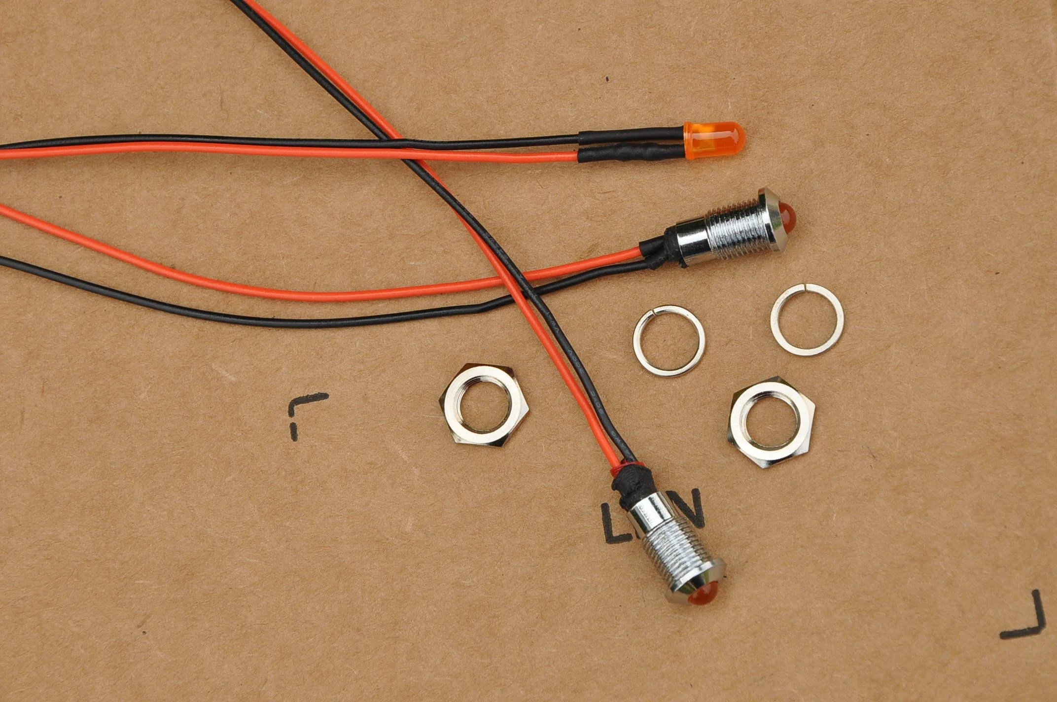

These next pictures just show the test LED removed and the final LED housing attached to the plastic cover in the position that I determined earlier. I used a 5/16 drill bit for this particular housing and tested it on a block of wood first. The hole for the LED and housing was perfect. I then threaded the wires through and attached them to the Posi Taps and tightened down the housing. Then just snapped the interior cover back on.

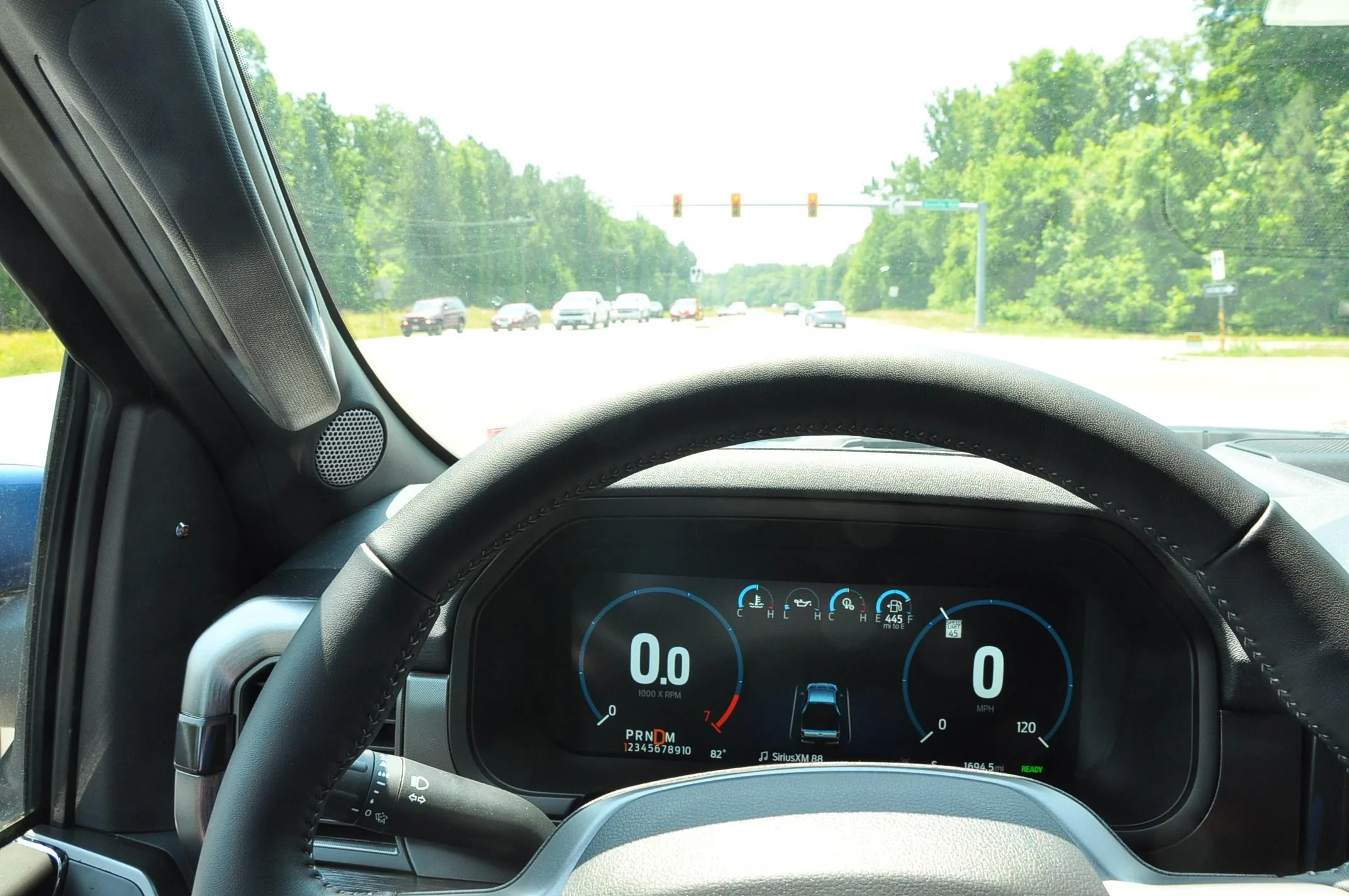

These next 3 pictures give you another drivers view of this mod both on and off.
Ford F-150 BLIS - Additional LED Mod (How To) BLIS 9
Ford F-150 BLIS - Additional LED Mod (How To) BLIS 9c
Final thoughts. This mod ended up better than expected. While I would love this BLIS information in a HUD that just is not in the cards for the F-150 and I doubt that will happen anytime soon. I now find that when I get the thought to change lanes, I can quickly just glance my eye down to see if it is active or if I want to go further with the lane change mechanics. I do not have to take my eyes off the road and turn my head to find the mirror or the BLIS in the mirror only to have to refocus on the road if something is there. This ended up being a wonderful compromise on the BLIS position and with a small 5mm LED, it is not a distraction in the least.

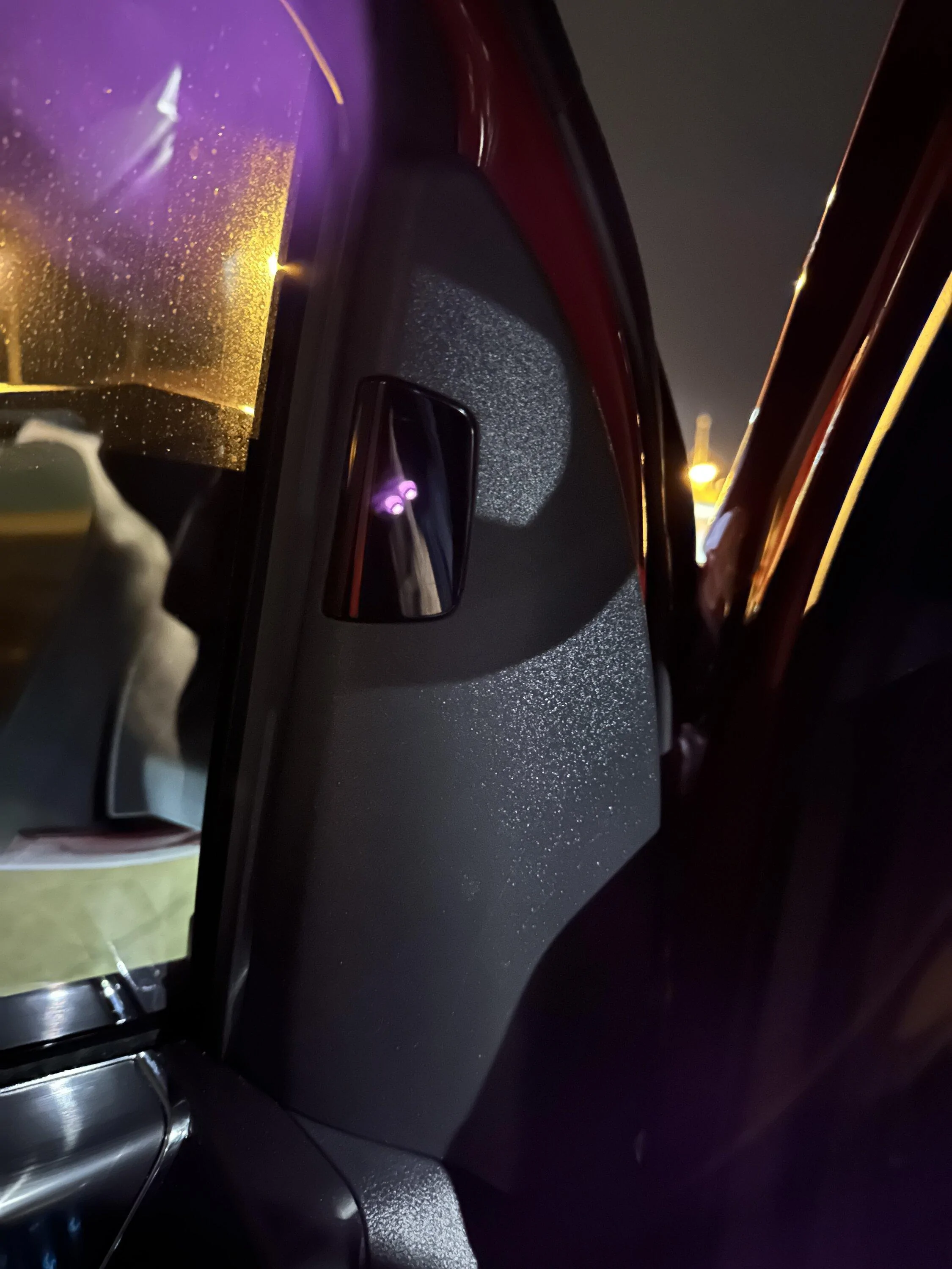

I just did some night driving and the frosted LED is just a pleasant glow. Not distracting or overly bright in the least. It is just another little light among many.
Now at night this has diminished value as the regular BLIS light in the dark really stands out and is easy to see. It stands out at night so much that just a quick flick of your head and you will know if it is on without having to focus your eyes to look for the little light in the mirror. My big issue is during the day. The mirror BLIS light is harder to see so I have to shift my eyes focus to find it. Then shift the focus back to the road if it is on.
The closer you sit to the steering wheel, or the further away to your peripheral vision that original BLIS light is, just makes it that little bit harder to see and find in the day.
With that said this was nice to just have a BLIS light inside the cab that is easy to identify without having to take my eyes off the road, or turn my head.
