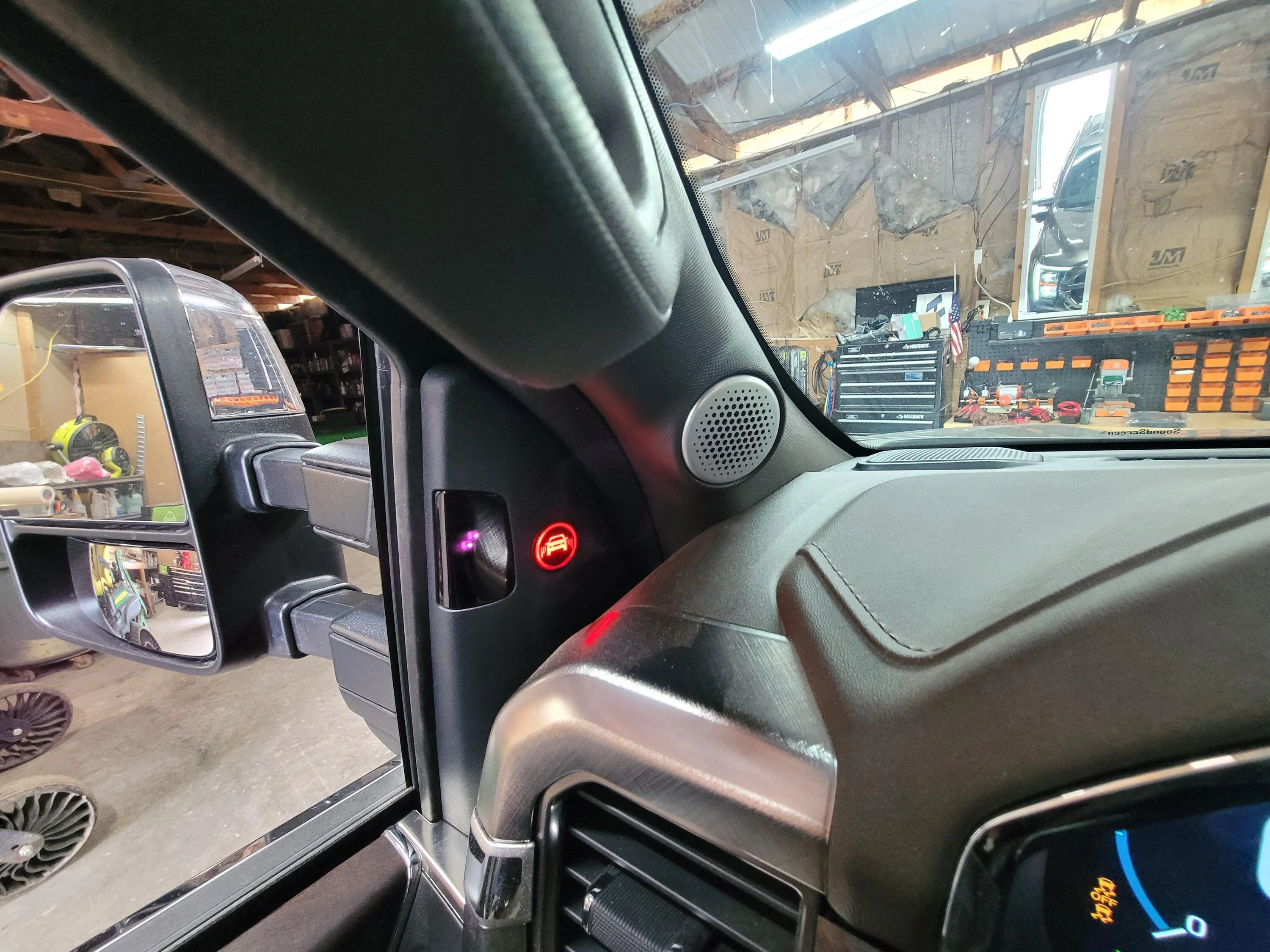

I was wondering what that dummy plug on the back of the inside cover was and now I know...it's for blue cruise.
BarryT82
Barry
Jul 20, 2022
442
400
WV
2024 F-150 Platinum
USAF
Thanks for posting this. This may be worth a look for future "upgrades".
Are those lights shining through or just a reflection of something?
Those are lights shining through for the blue cruise system.

Used a different indicator light.
Very Nice! What I would like to find is a beeper that beeps once when the power is applied and then will not beep again until the power goes off and it resets. This would give a nice auditable beep when BLIS is activated, but not constant.
Great light you found there. It looks like it was made for it.
