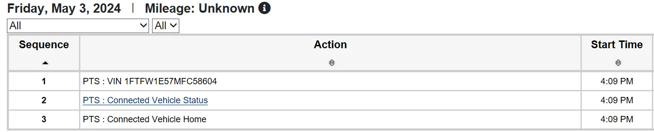

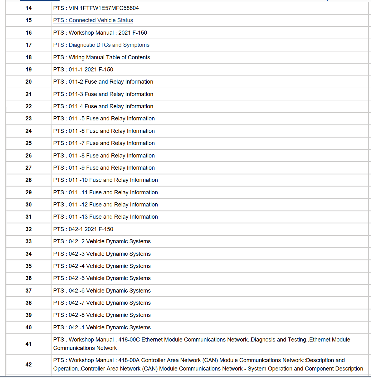

Someone just used PTS on the truck 9m ago

They refuse to connect to the truck and show the FDRS module communication. They keep looking on PTS to read DTCs. Truck is probably sitting in the lot eating up battery with each PTS query they do.
