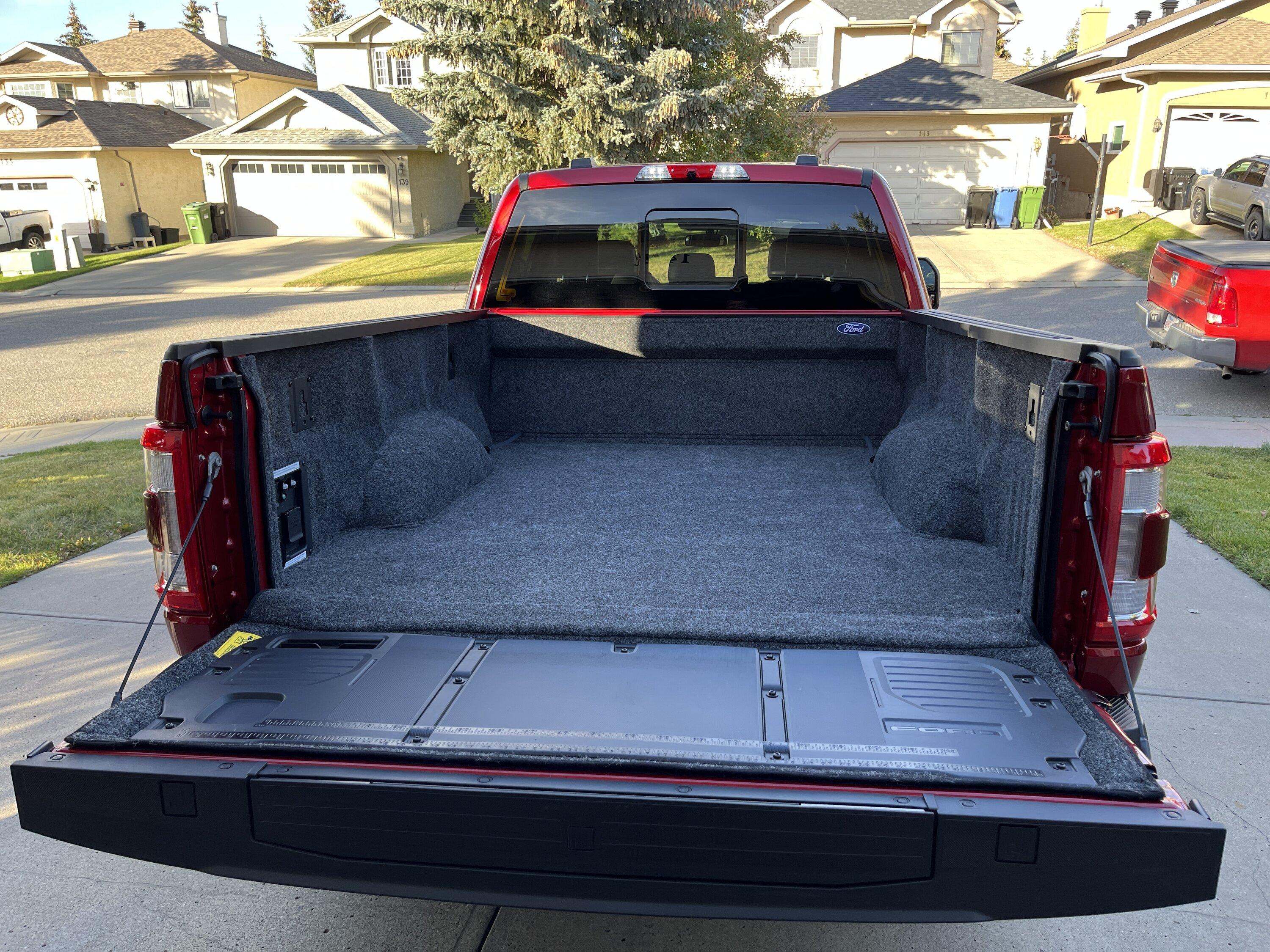

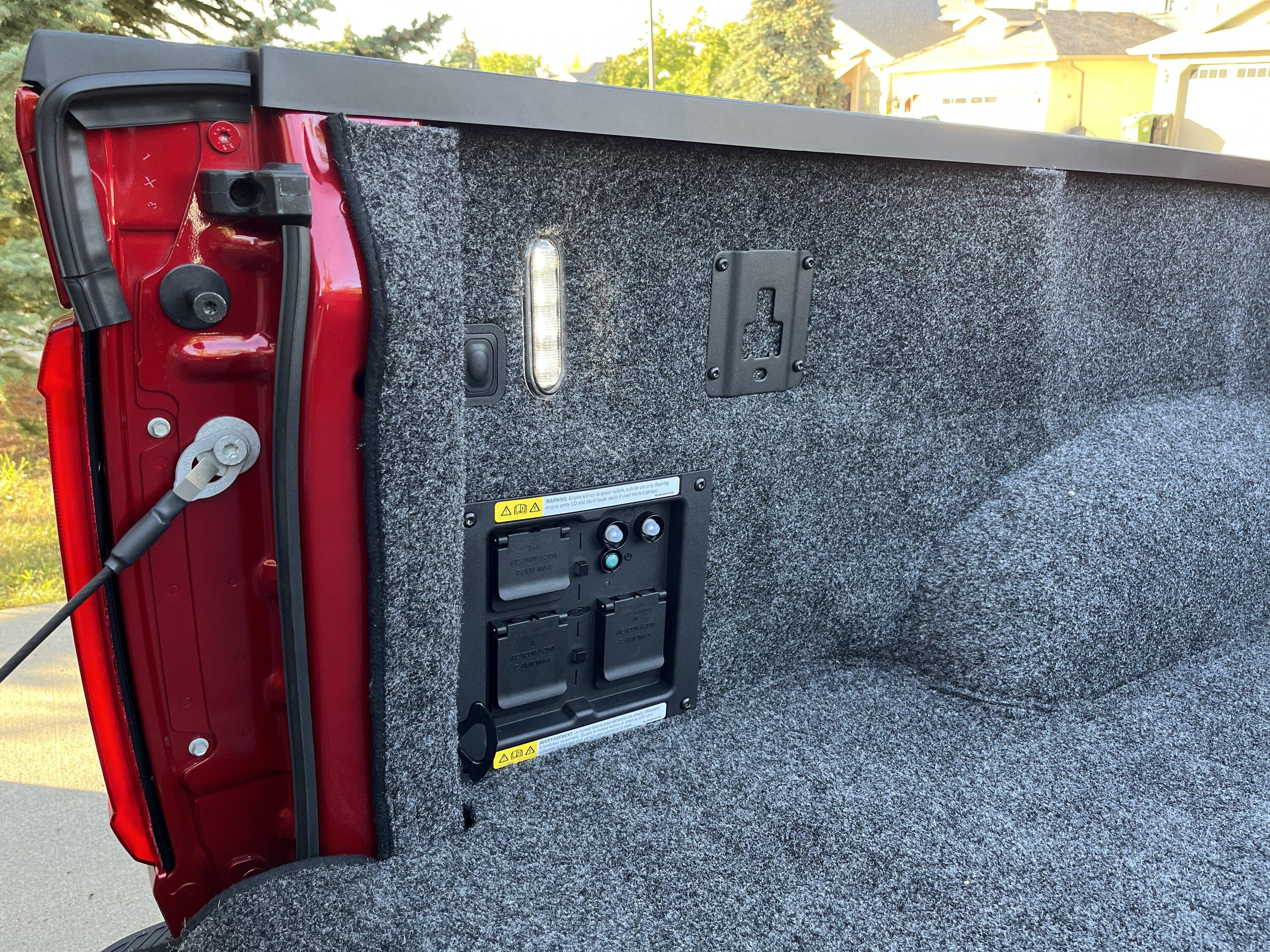

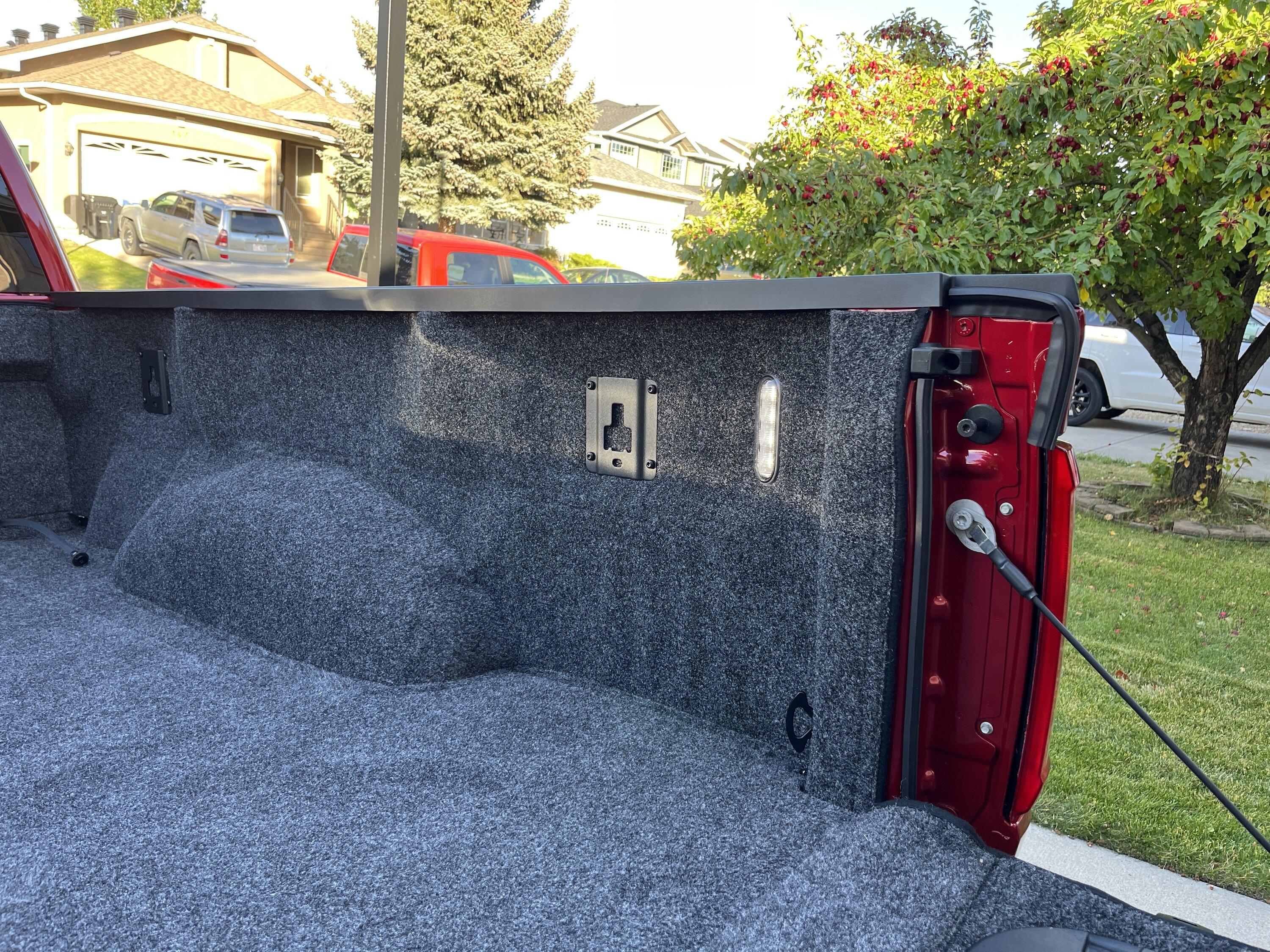

I have just installed the Ford Bedrug today in my PowerBoost - went ok, but with all the accessories on the drivers side, it pulled the Bedrug a bit tighter, so it’s a bit further from the tailgate - but it’s just cosmetic
I also installed the Ford Tailgate seal before hand as well.
As you can see, I went under the Work Surface.

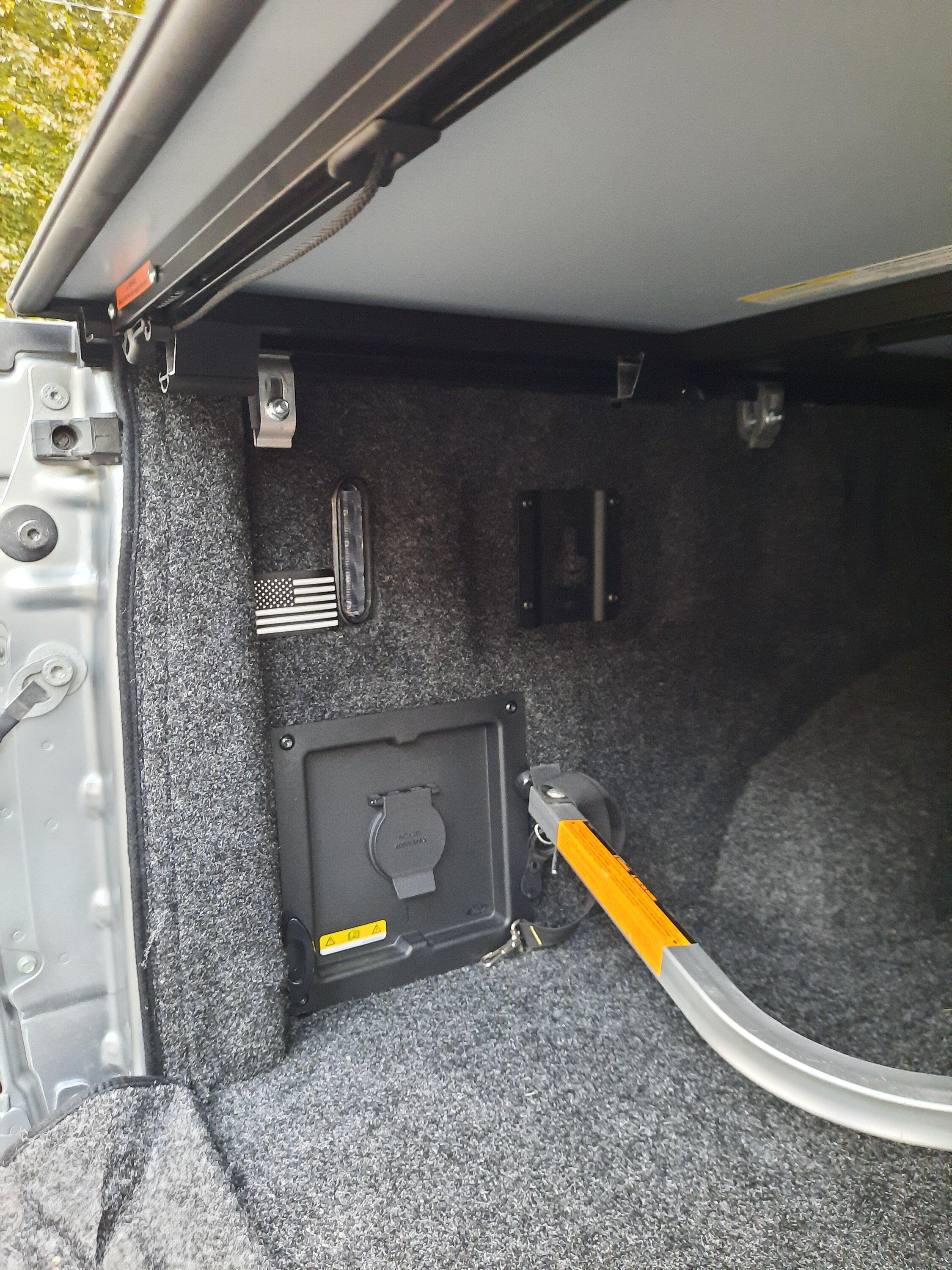

Pretty happy with the result of my bed rug install. Work surface tailgate over the rug.
A few minor regrets for the bedrug install but it worked out in the end. I was working in a bit of a hurry, a bad combo with having some level of car OCD.
2) During the install i chickened out of pulling the bed lights because they weren't budging and I didn't want to break them. Ended up cutting and didn't like the look. Ultimately popped off the lights, installed over the rug, and they look much better, just cut out a little more than needed on the driver's side. Passenger is perfect now.
2) Didn't get a super clean cut over the bed light button switch. Ended up adding a hook & loop (velcro) reflective flag patch over the button. The flag looks great in my opinion and the button functions by pressing on the flag. May end up swapping the flag for a circular patch. The patch is a solid option for those who aren't happy with a cutout they made around the switch.
The patches are a way for bed rug owners to add some non-permanent expression/ personality to the inside of the bed without it being outwardly visible on the exterior.
