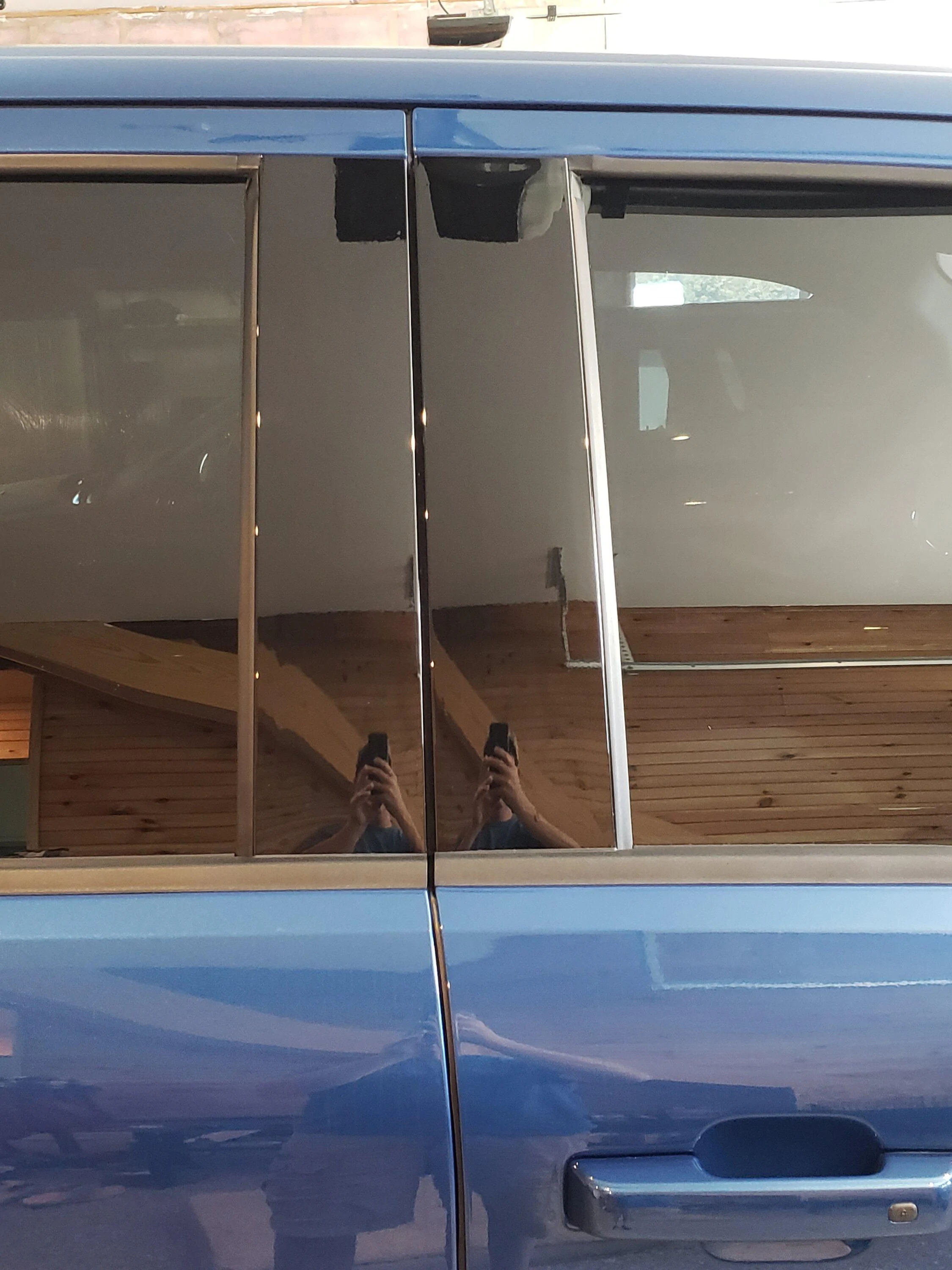

It appears that the detailer at the dealership hit the piano black B pillars with the buffer when my truck was getting prepped. Most of the time you can't notice it but in certain lighting, they look terrible. Is there any way to fix this without replacing the panels?

Not a bad idea to go the route of PPF, but these swirls can be removed with a finishing polishing pad and finish polish very easily.

They are pesky! That material is pretty when new, but is SO soft and swirls just by looking at it... I've had my truck for over a year and a half and almost need to polish mine. Will likely put a ceramic coating on mine since it will be a little harder than the clear coat on it.
