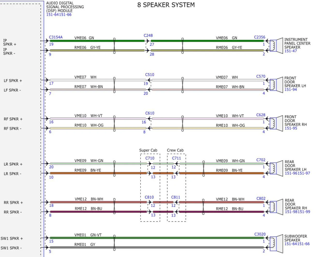

You'd need one or 2 slimline subs depending on if you want to move your jack or not and use the room for another sub. Remove the sub, tap its speaker signal and connect it up to an LC2i to alleviate bass rolloff / get an RCA signal that doesn't roll off w/ volume. Create your own sub hole block off means (could be 3D printed plate, self adhesive foam, a thick sound deadening material like dynamat, etc as the factory sub is vented outside of the cab pretty simple to do .
Get an amp power wiring kit appropriate for your slimline sub/s. A few choices out there depending on what you're wanting.
https://www.rockvilleaudio.com/ss10p
https://www.crutchfield.com/S-qIVPkNZc6Ax/p_20651HS10/Kicker-51HS10.html

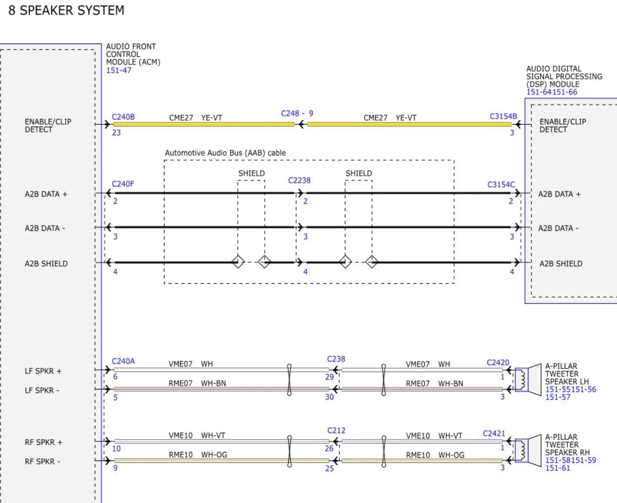

You may be able to fit 2 of them w/out moving the jack, I don't have the factory B&O amp any longer to measure the room available. Fold down the seat and take measurements. If you have the rear opening window changes the variables a little bit as well. I do and have a custom sealed box with dual 10s (only fits slimline subs). Might be more work than you want to do in regards to replacing the factory amp. It powers everything including the center channel, but it does not power the tweeters. The amp has an A2B digital feed and is referred to as the "DSP". The so called "IPC" speaker is in the middle of the dash behind the screen.
