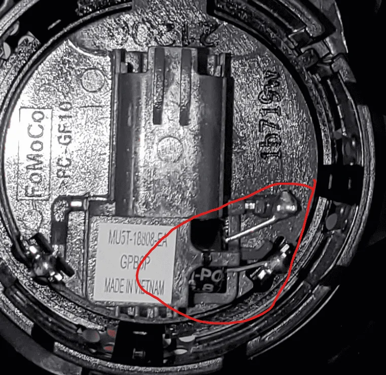

C2s are .75", C3s are a 1" version. Tweeter protectors stop freqs below 3500hz reaching them as lower freqs will damage them. Component sets come with crossovers that perform the same thing. What you can't do however is just straight connect the tweet to the factory wiring. You'd need to put a cap inline with it to protect them. You can search on it. If you insist on using the factory amp, the tweeters are fed by the ACM in the dash, all other speakers on B&O 8 channel are fed from the amp in the back. You'd need to either install a protection device on the tweeter, or wire in its crossover in the dash at the ACM.
Here on the factory tweeter you can see the protection built-in
Ford F-150 B&O 8 speaker upgrade question 1679680836048
What you can't do is just swap in the JLs w/ out any kind of protection on them. You could tear apart the factory tweeter and yank out its parts and use them if you want. Using a 3/4 tweeter there, you're going to have to gut it either way to retain the grille / mount.
