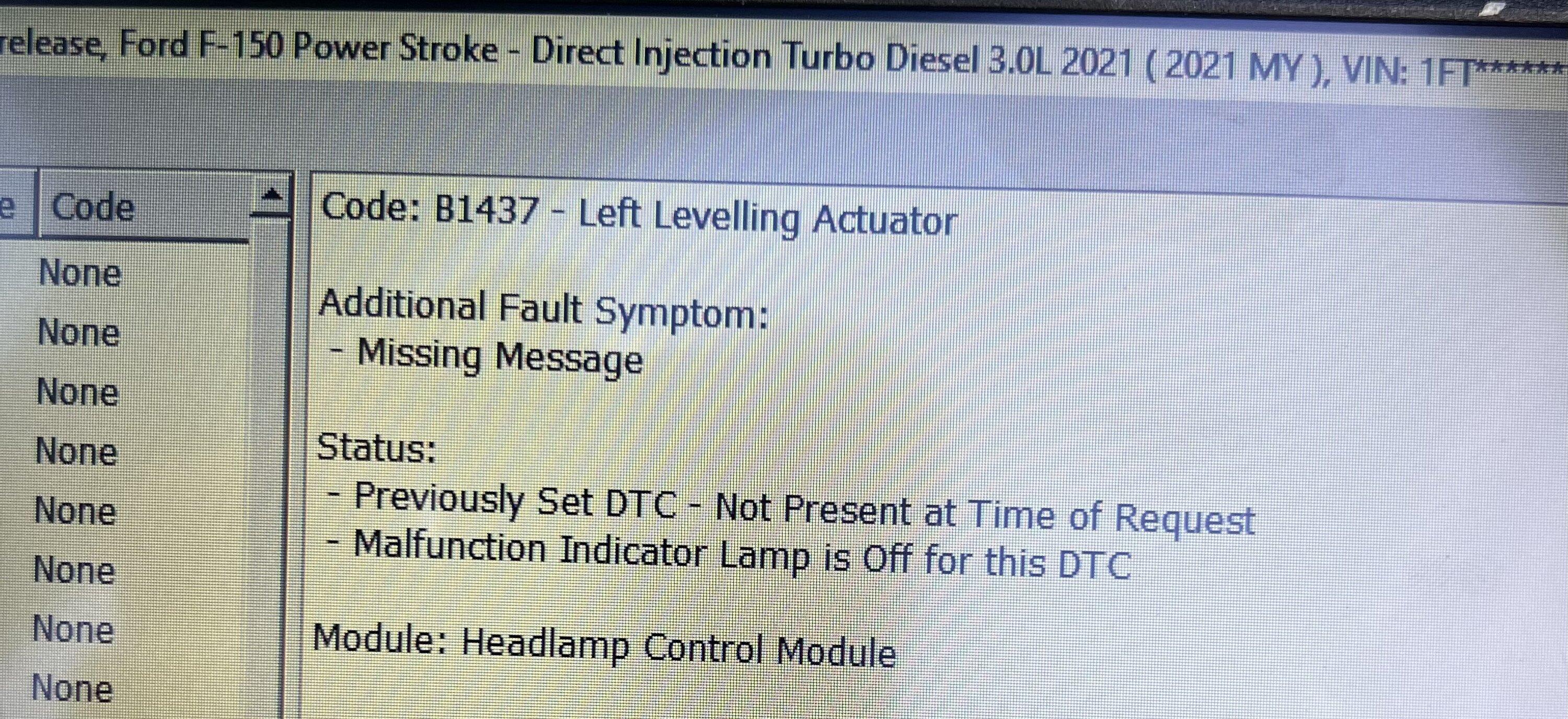

DTC codes from the HCM module.
Ford F-150 Auto leveling headlights not always working 9A139F8A-C5DA-4A4F-B647-0CF4BCAEEAF4
Ford F-150 Auto leveling headlights not always working 194FC8CE-6E92-4EA6-A47B-810A56832F63
Ford F-150 Auto leveling headlights not always working 756F4226-27B7-4772-B3E9-F4A20FBCB912
Ford F-150 Auto leveling headlights not always working 4B2C07F1-8B7A-4029-ABF4-6502CA259DF9

COuld be a wiring issue. Both side.. Very unlikely to have two bad headlamp assemblies. It has a lin bus that handles that.
Could be a HCM also.
