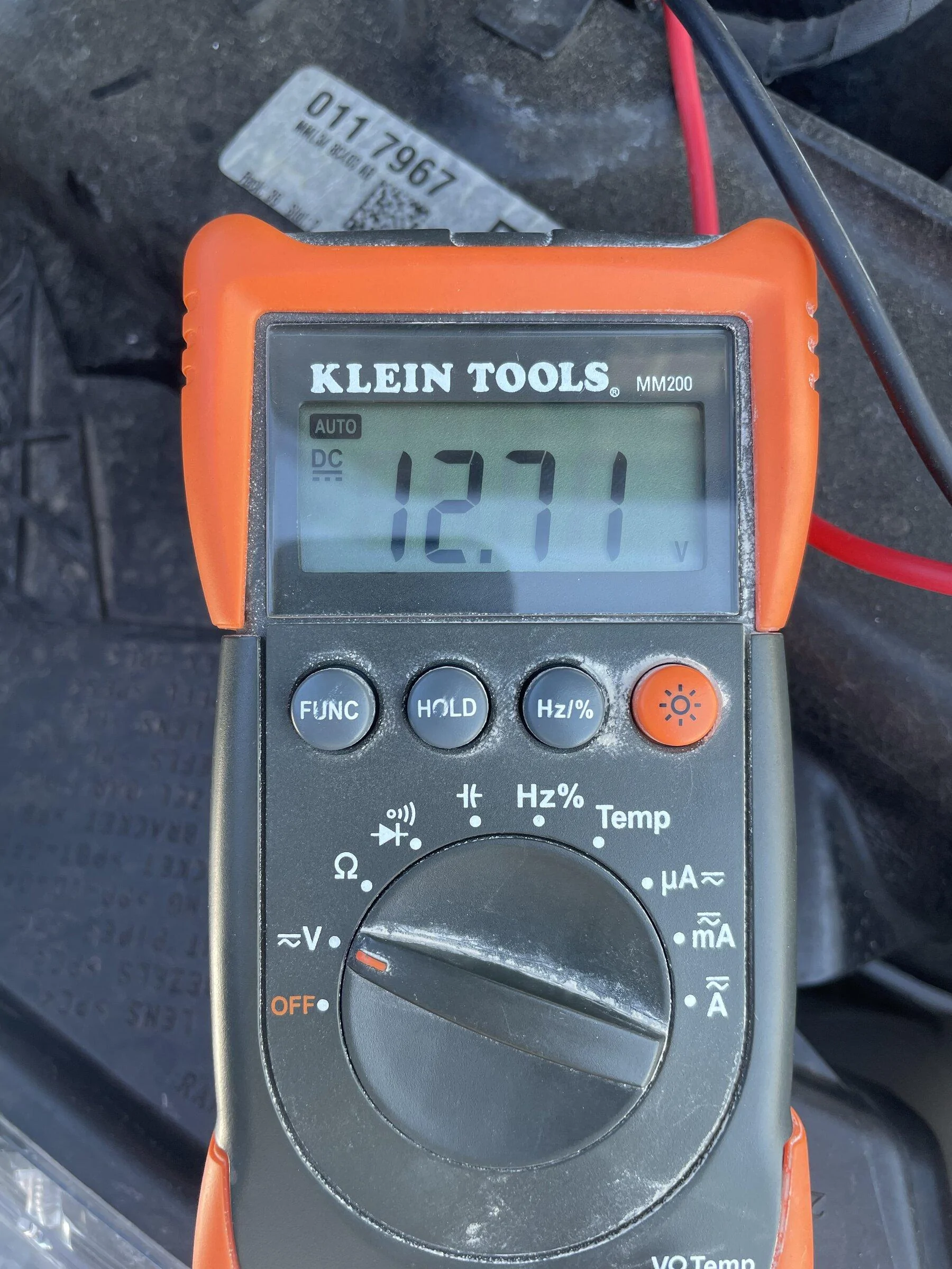

Voltage appears to be good both non running and running.
Mine did exactly the same thing after picking it up from service. Battery charge was over 12.7. took it in and they replaced the battery. No more issue.
Beats me. All I know is replacing the battery made it start working again.
