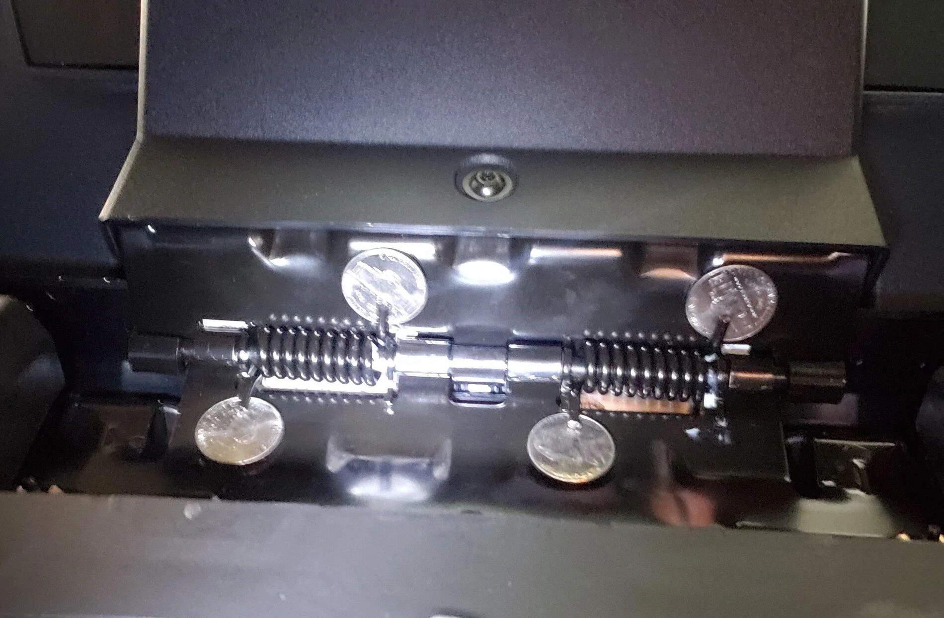

Two nickels didn't quite do it, still left armrest half open/closed. Four nickels did the trick though, but had to basically place my head upside-down in order to do the top ones. Lid opens with some gusto now.
Thanks again for the tip!
Looks like you have a Limited. Do you have the work surface? I have a Platinum with work surface. The double nickel was doing the trick. I saw your post and I thought what the heck, do the double double nickel. I did, but mine doesn't fly open. It just pops open and I have to lift it up. It stays up though.

FANTASTIC!
UPDATE:
....I spent at least a half hour bending, twisting, pulling, and everything else one can think of and that spring end will not budge.
Leverage. I used 7" locking pliers. Lock on to the spring tab at a 45° angle. Now use leverage to easily lift the spring. Slide your nickel in and release the locking pliers. You can move anything with the correct leverage.

I do not have the work surface, so guessing the armrest is a bit lighter.

Armrest lid FIXED:
Complete write-up with how to. This repair will cost about $0.10 and 2 minutes.
Tools needed: Slotted screwdriver
First, go to the auto parts store, you are looking for any type of candy bar or treat. Pick up your favorite and go back out to your truck.
Next, lift up the armrest and curse that you have to hold it up. With the free hand, remove the trim piece directly below the spring to reveal the entire spring, hinge and bracket. The springs each have one "leg" that rests against the metal bracket; those are what will be adjusted.
Take two nickels from your coin holder and set aside. With the slotted screwdriver, gently pry/lift up one of the legs on one of the springs. Slide nickel below raised leg and remove screwdriver. Repeat for the other spring. Now, let go of the armrest and BAM! Stays up!
Jump back into the driver's seat and drop that candy bar/treat into the now "hands free" fully opened console for future snacking.

Did Hambone’s fix today. Much better spring tension in the open position than before. Not as much as i would like but it does stay open even wen driving.
