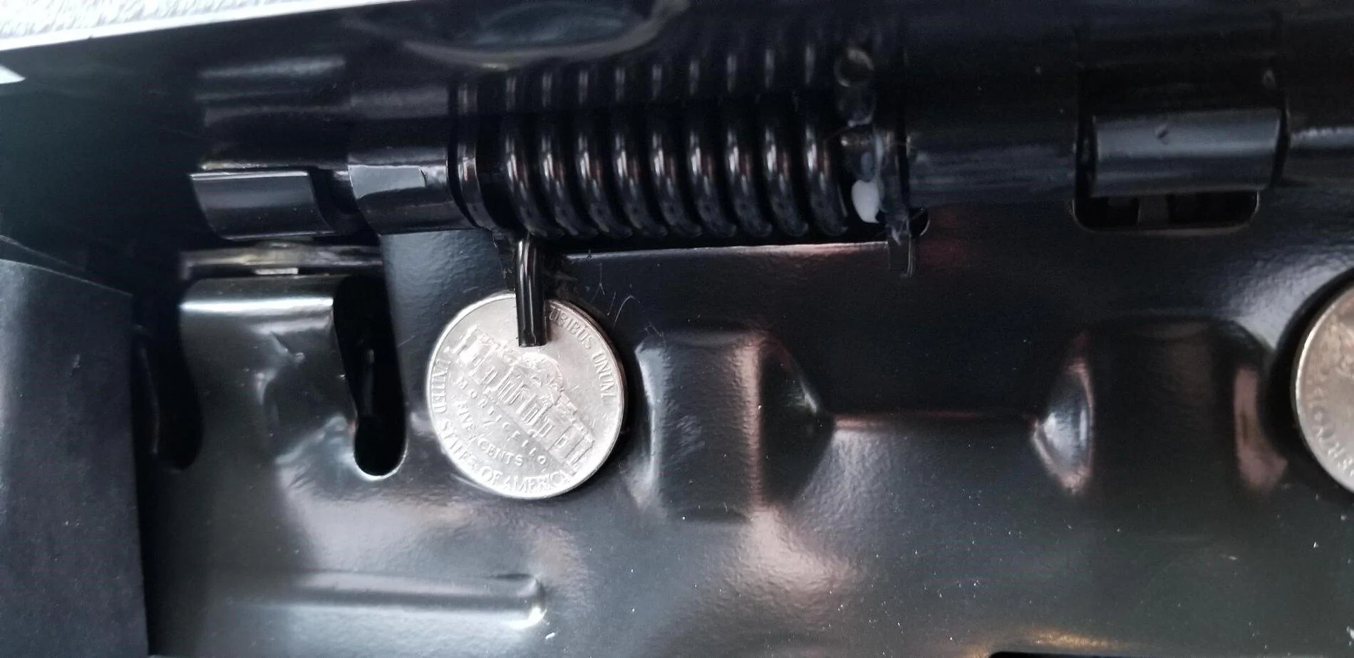

I used the @Hambone method but was having trouble getting the trim piece off. The springs are exposed when the trim piece is in place and there is some space to get the nickel in where it needs to go. First I propped the lid open so I had 2 free hands. Then I slid a nickel behind the trim piece close to the flat end of the spring and held it in place. I pulled up on the flat end of the spring using large needle nose plyers and slid the nickel under the spring. I did the same on the other side. My fix cost me $0.20 because a couple of nickels got away from me & fell down behind the trim piece. My lid now stands up when opened.

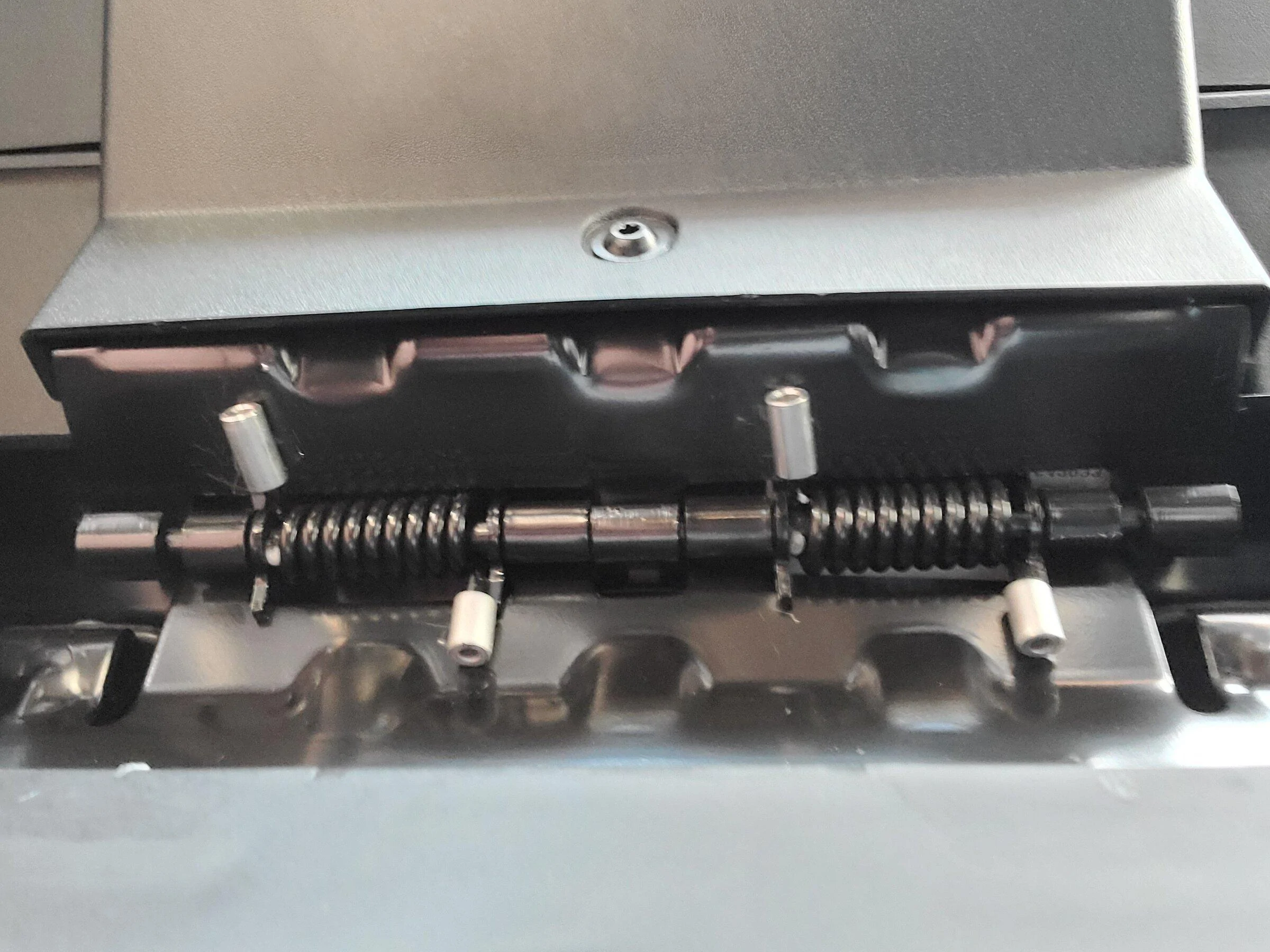

Well i started off with two nickels on the bottom springs but that was not strong enough. Then i saw mxlchgo idea above and tried to find some of those metal spacers since i thought they looked better than nickels. Couldn't find none local so i decided to try these nylon style ones i found and they seem to be working good so far(will see how long they hold up). I put 4 on total. I have a builtright molle panel on my armrest with workstation so it's a little heavy. I also bought a nice set of needlenose locking pliers that made the top springs much easier to move.

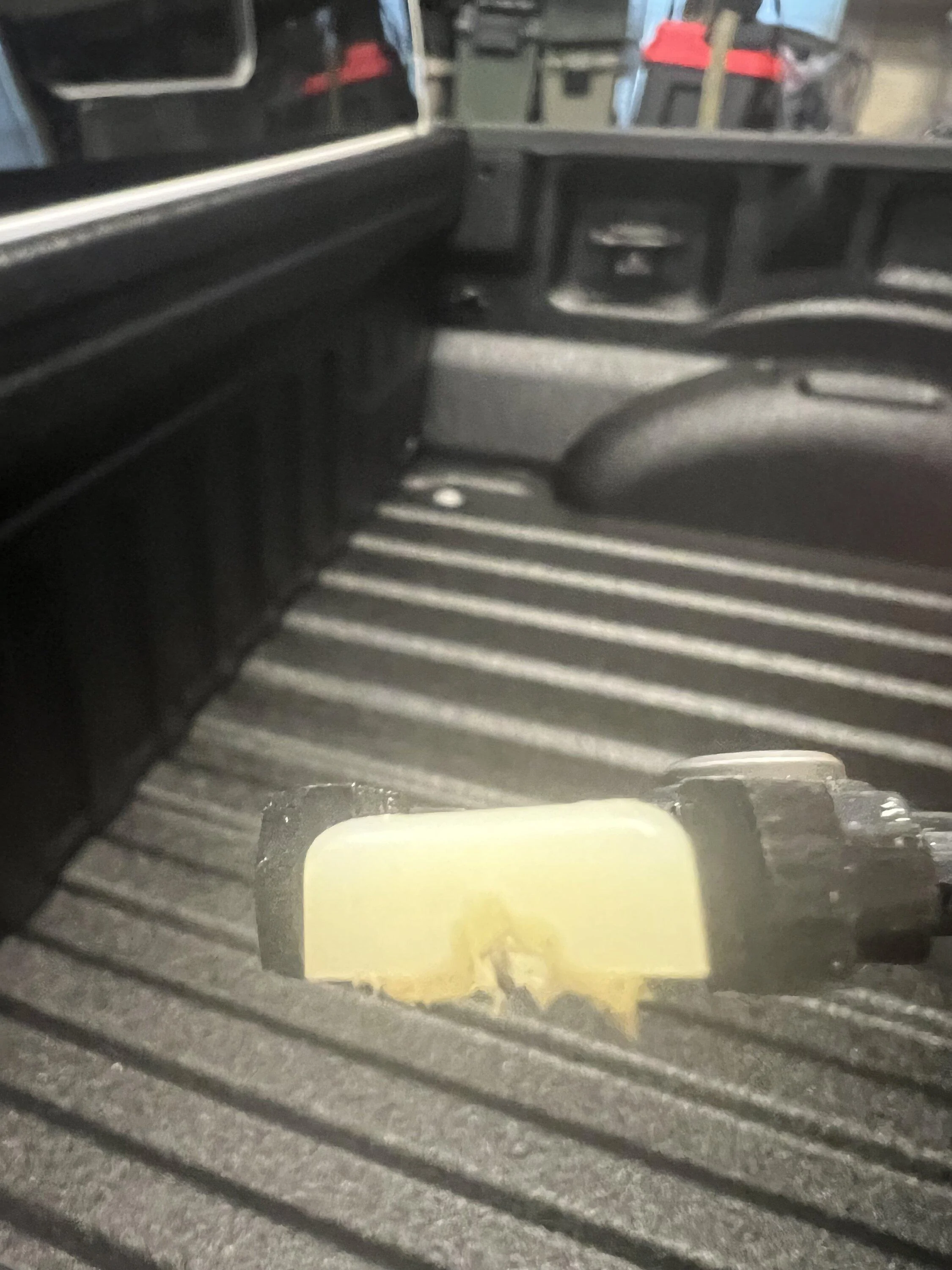

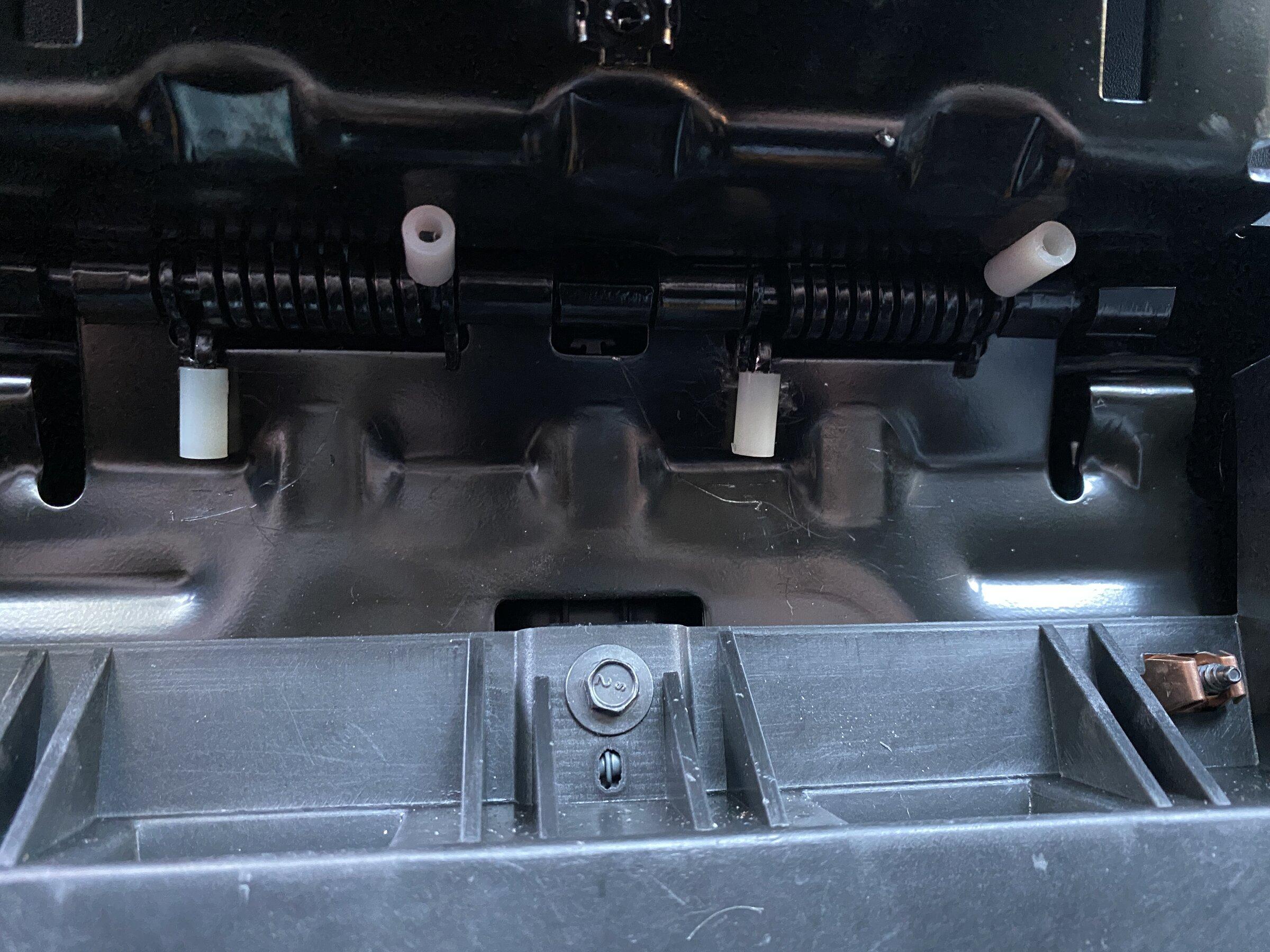

My fix was similar but I used a hillman chrysler nylon license plate lug with a dremel-cut channel in the side to seat the flat spring. The needle vise-grips are a necessity. Used a coping saw to cut off the insert flange. It's a little thicker than a nickel, so I didn't have to address the top of the springs.
