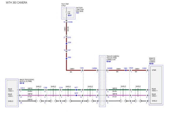

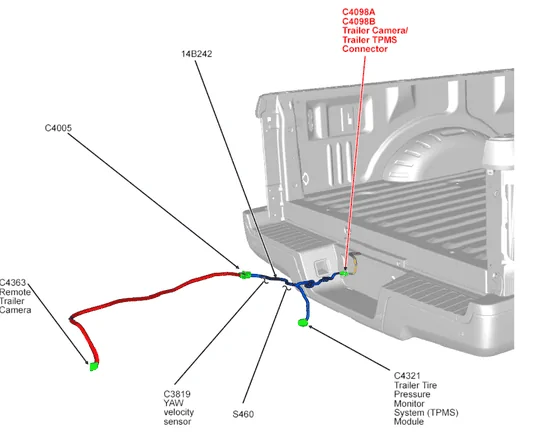

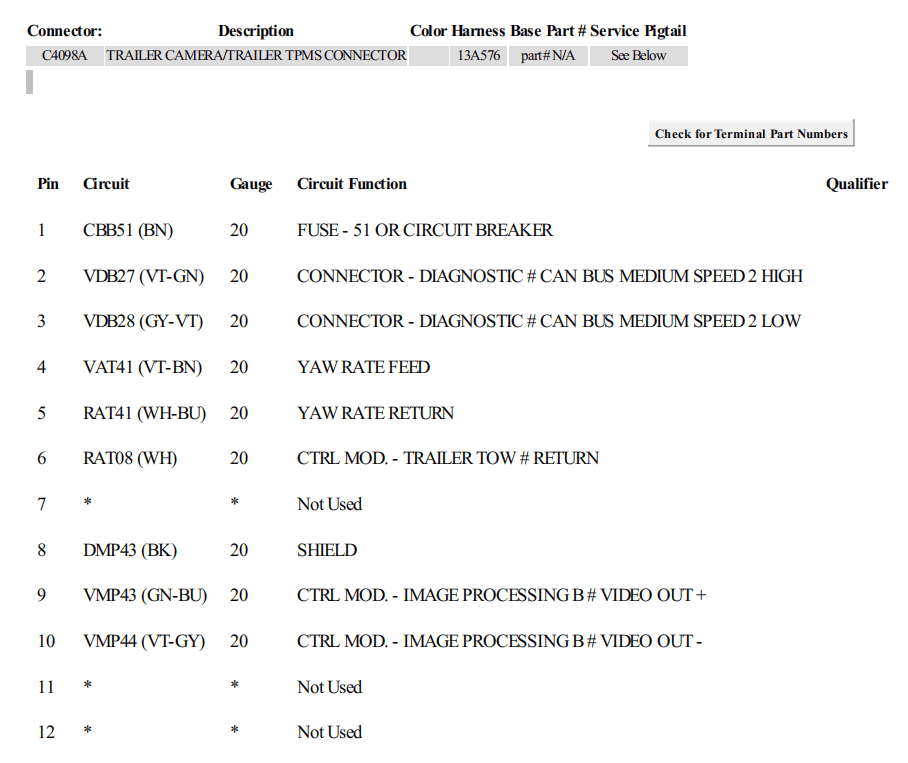

So upon a little more searching I found the pin out and some wiring diagrams. I’ll post here, apologies if they aren’t perfect, but it’s just how they downloaded to my phone.
The yaw sensor cabling goes to pins 4 and 5 which was expected, will still have to confirm on the truck if those are the populated pins.
To me this confirms yaw sensor connections/operation.
The unfortunate part is tpms operation. The diagrams I found indicate power and ground as expected is needed for tpms. But it also shows can bus is needed as well.
The 2 “extra” pins on the yaw sensor cable that aren’t connected to anything, are actually used for can bus. So maybe the intention is to pigtail into there for can bus for the tpms, and then power could come from anywhere.
The mystery to me is why power and ground are not already in that connector at a minimum. I have the 360 camera, bed camera, and I believe the led chml, so according to the diagram (though I think it’s for 2021) power should at least be there. Like I said too cold to be under the Truck right now. Maybe there is a bundle of wires or a power wire tied off somewhere.
Here are the diagrams. Edit: these are from a super duty. Not a 2022 f150
Please post the link to your source. Are these diagrams known to be specific to the 2022 F150?

Please post a link to your source. Are these diagrams known to be specific to the 2022 F150?
I just looked these are diagrams from a super duty I believe. Not specific to the 2022.
