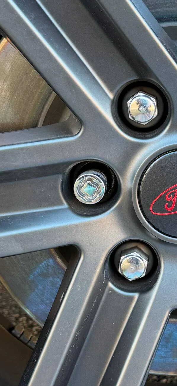

First post so sorry if this is incorrect spot or format lol.. bought a used 22 f150 and it has these locking lugs on each wheel and of course there is no key. Wasn’t sure if anyone possibly recognized which brand it might be?

Want to add I’ve looked online and seen other patterns but most seem to be 5 star looking pattern and not 4 like this one

Most tire shops have master sets to remove these. You would have to buy a new set to get a key. Also heard of weilding a nut onto the top of it to get it off in rare cases.

Yeah I did buy a “master key” set from harbor freight but none of them fit but I was in a bit of a rush so maybe I looked over one. Thanks for the suggestion!

I would check with the original selling dealer, they might be a Ford part. My dealer sells them in Ford packaging or try your dealer, if you bought from a dealer. I noticed alot of dealers have them on vehicles sitting on the lot.

McGard sells some 4 point sets

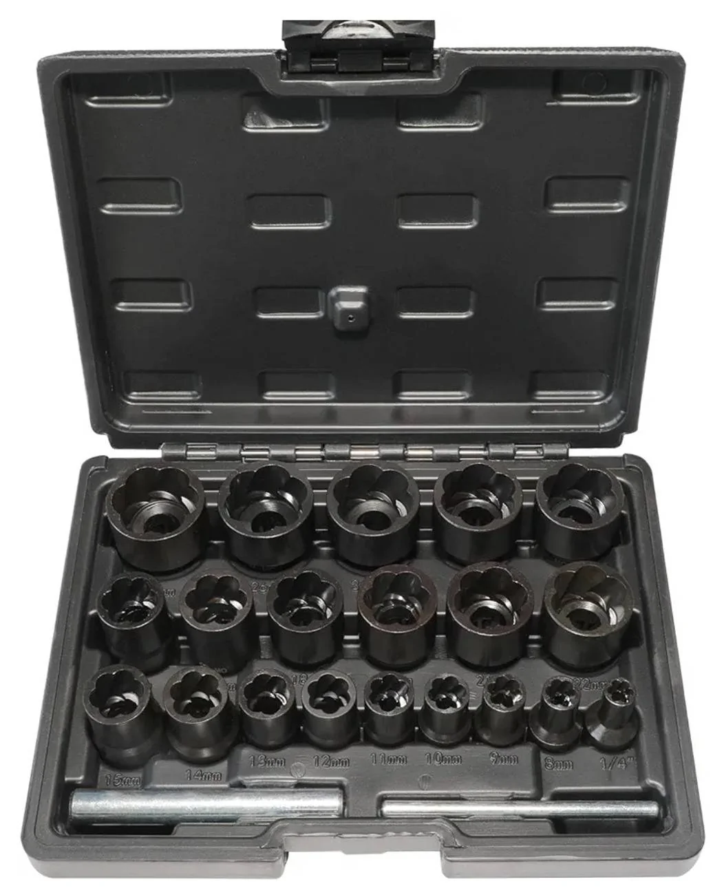

The four Star is definitely harder to find. I'd suggest going this route. There are many different sets on Amazon and you could get one smaller and cheaper for sure. These are threaded backwards and will bite on to the locking lug nut and remove it. I've used them in the past and they work great again not this set but there are many others like it.
Lug nut extractor

Just hammer a socket on it and pop it off.
