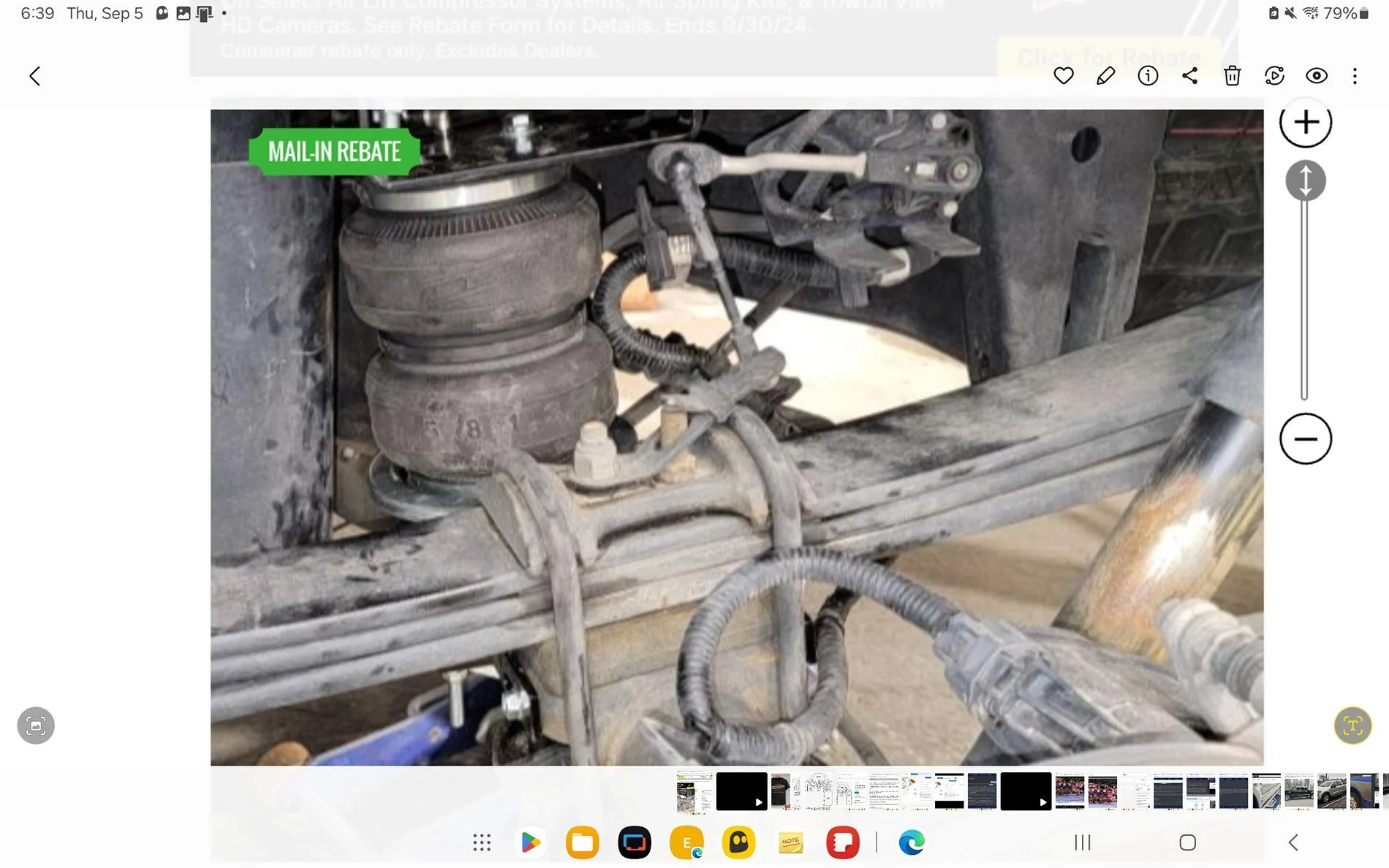

markh Active member First Name mark Joined Mar 28, 2024 Threads 3 Messages 38 Reaction score 35 Location Egg Harbor N.J. Vehicles 2021 Ford F150 Lariat Supercrew 3.5l Ecoboost Occupation Retired Sep 5, 2024 #11 Air lift makes them that fit with them in place Attachments Truck Air Lift_MN-1151.pdf 8.6 MB Views: 108
markh Active member First Name mark Joined Mar 28, 2024 Threads 3 Messages 38 Reaction score 35 Location Egg Harbor N.J. Vehicles 2021 Ford F150 Lariat Supercrew 3.5l Ecoboost Occupation Retired Sep 5, 2024 #12 Sorry for the manual i thought it was a screenshot of the cover. Here's a picture of it installed.
