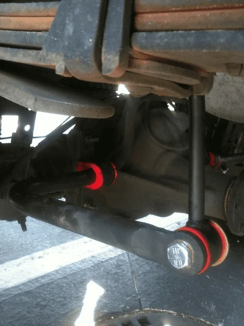

Really a shame since there used to be, and since they offer one on the Super Duty (Camper Package) I feel like there should at least be one on the MaxTow option for F150. Yeah, it's dinky, but it exists.
Also, I hate how they mount the aftermarket ones. I know there is a lot in the way, but I still feel like the older F350 style would still work somehow.
Ford F-150 Anti-Sway bars questions 1677363245183
Ford F-150 Anti-Sway bars questions 1677363262986
Ford F-150 Anti-Sway bars questions 1677363269496
Only needed for someone who goes off-road and wants the clearance, and the amount of those people that might want a swaybar for the street is even smaller, so I get why they don't, but still...

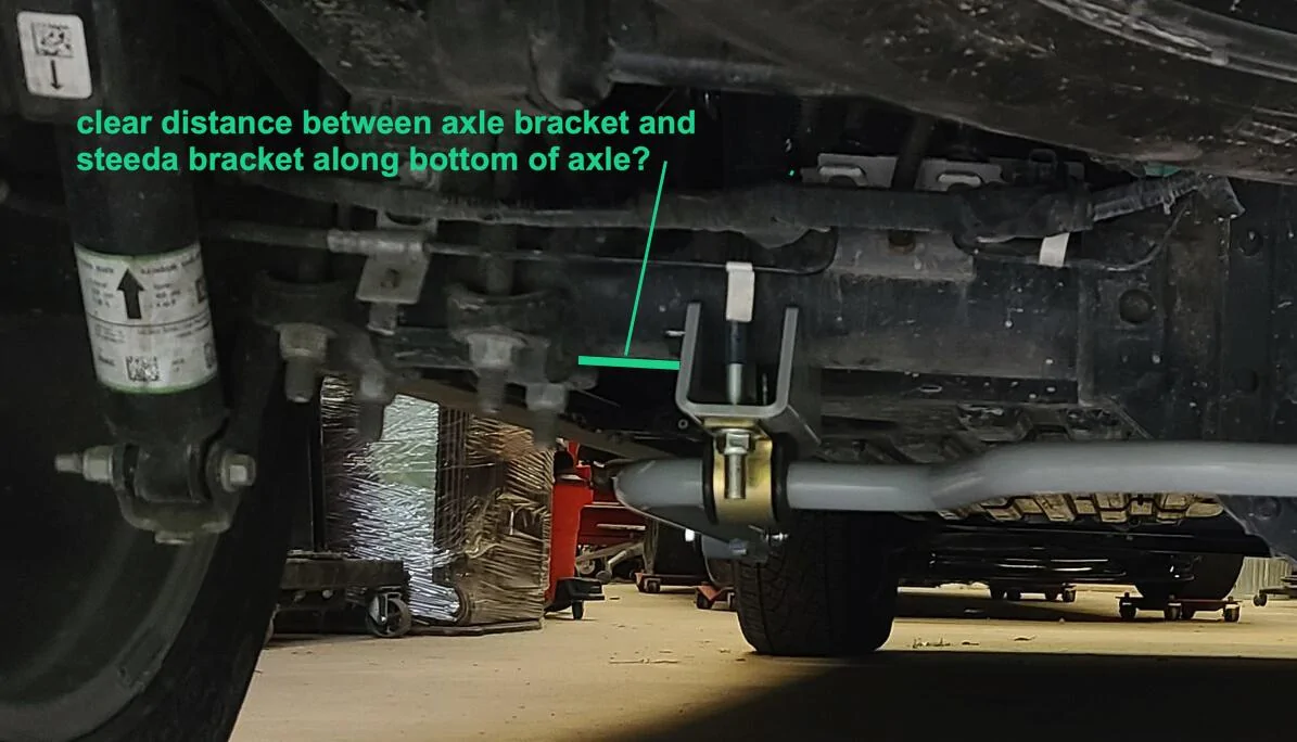

Pursuant to the earlier question of using bags for sag adjustment along with a bar for roll-resistance .... can someone who has installed the Steeda bar measure the space between brackets on the axle as in the pic below (pic stolen from @Snakebitten's install pics)?
Ford F-150 Anti-Sway bars questions measurement
I'm curious to know if there's likely conflict between the Steeda mount and the Air Lift 5000 PN88355 bags mount.
Thanks In Advance!

The length of the green line or the distance between the two brackets is almost exactly 3" in my case with the Steeda bar as shown. In my case, I have the U bolt up against the brake bracket, which seem to work nicely.
As I previously mentioned, I'm not happy the length of the end links because they are too long and hang down at least 2" lower than they need to be. I think Steeda tried to accommodate lifted trucks with the same end linke setup and it is too long on a non-lifted trucks. I have them adjusted as short as they will go. I think I'm going to modify mine to shorten the adjustment bolt by 1 1/2". I can easily see most people not caring about this, but I do. Everything else regarding the Steeda setup seems excellent.
