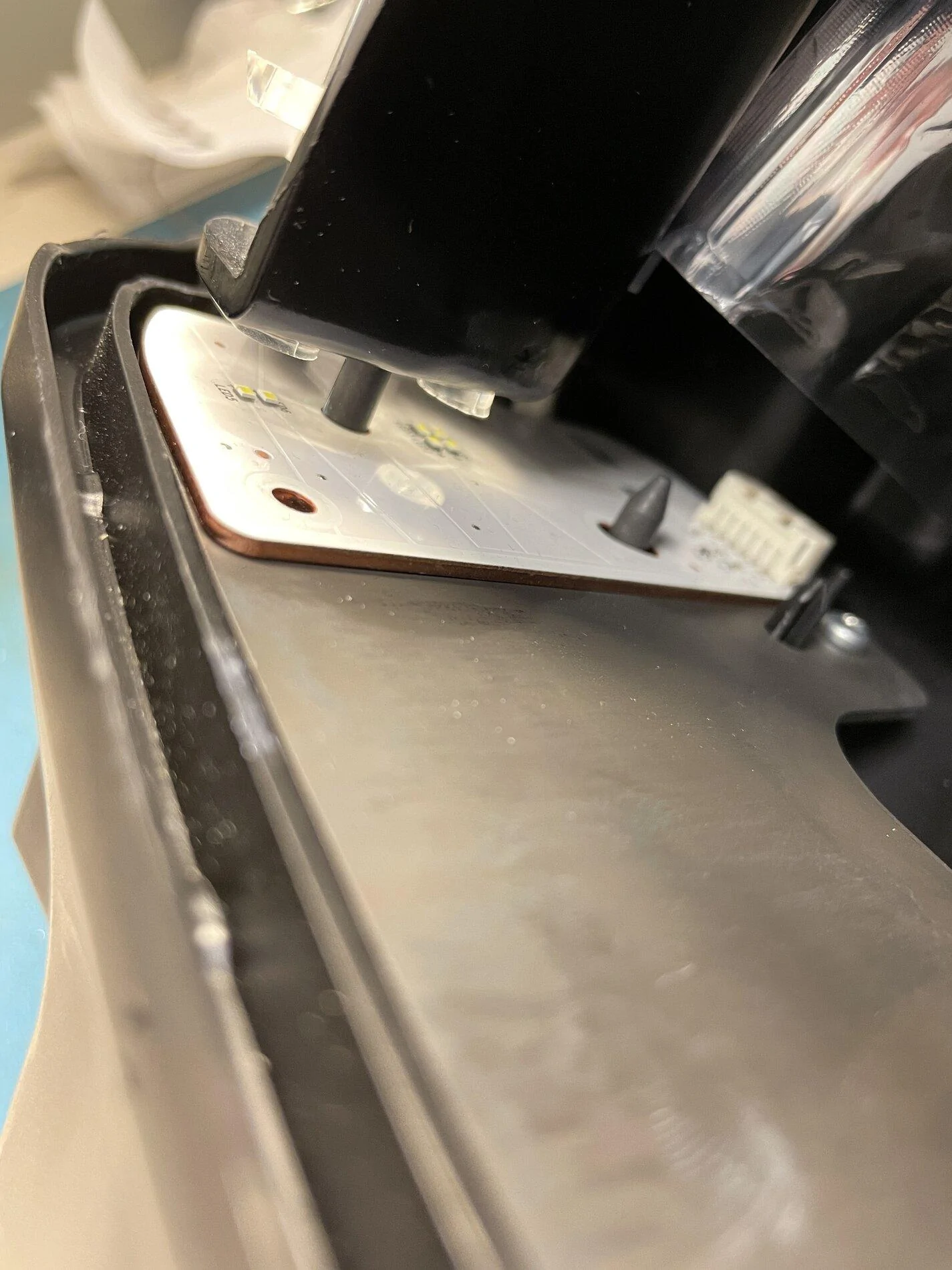

I was able to find the board. I was close, there’s a two LED array for one light pipe and a 4 LED array for the second pipe.
Ford F-150 Amber DRLs? 4150CF41-18CE-4B43-AA6F-098CE91CB786
This photo shows the PCB in the headlamp housing:

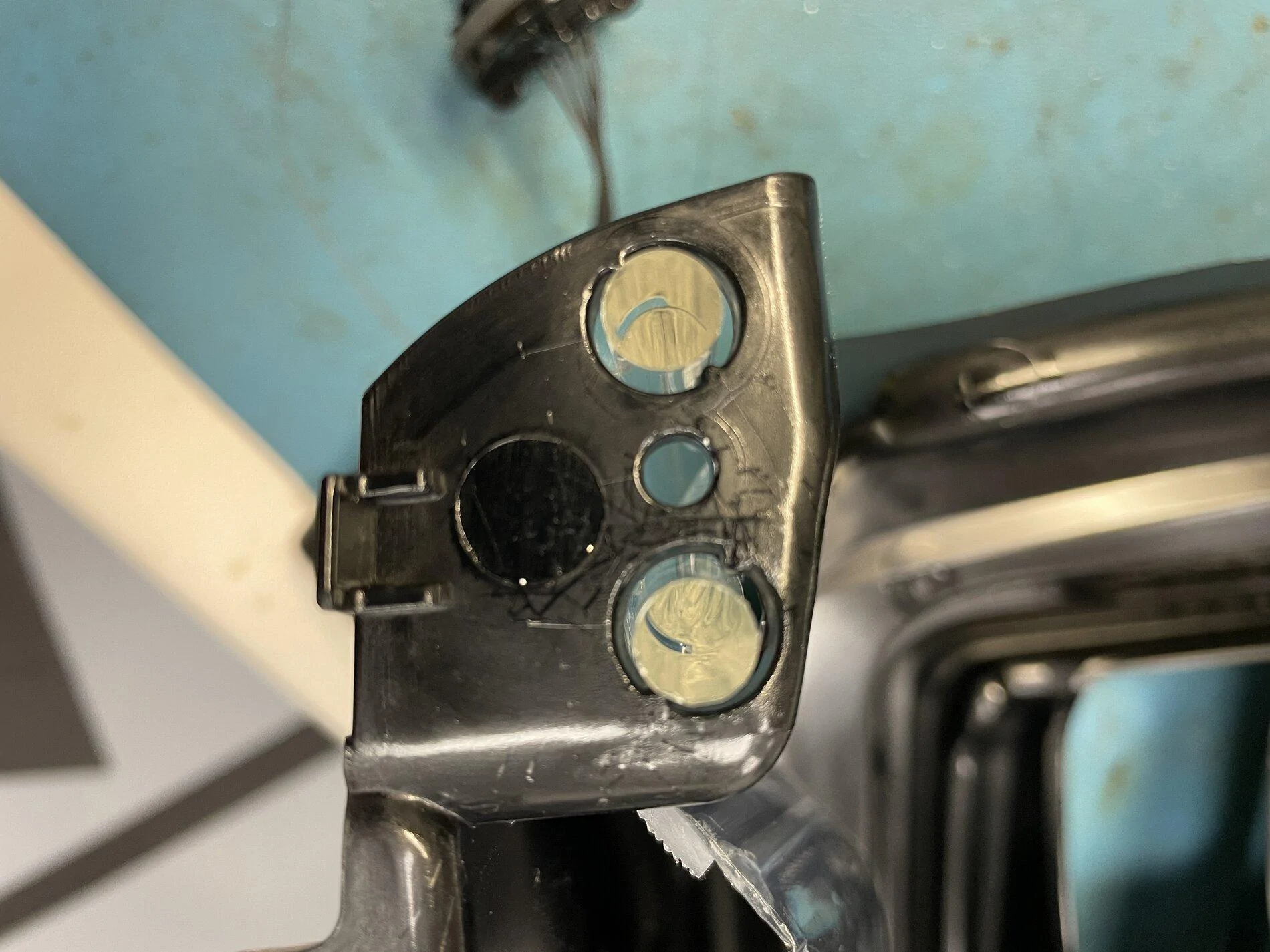

This photo shows the two separate light pipes that couple the light from the LED arrays:
Ford F-150 Amber DRLs? 53E506F8-26FD-4CA6-8BE3-3915F9F2D3F2
This photo shows the assembled position of the light guides to the PCB:
Ford F-150 Amber DRLs? 94E5C81A-3407-4F8B-96CD-EDC3E6ABFE2A
Closer view:

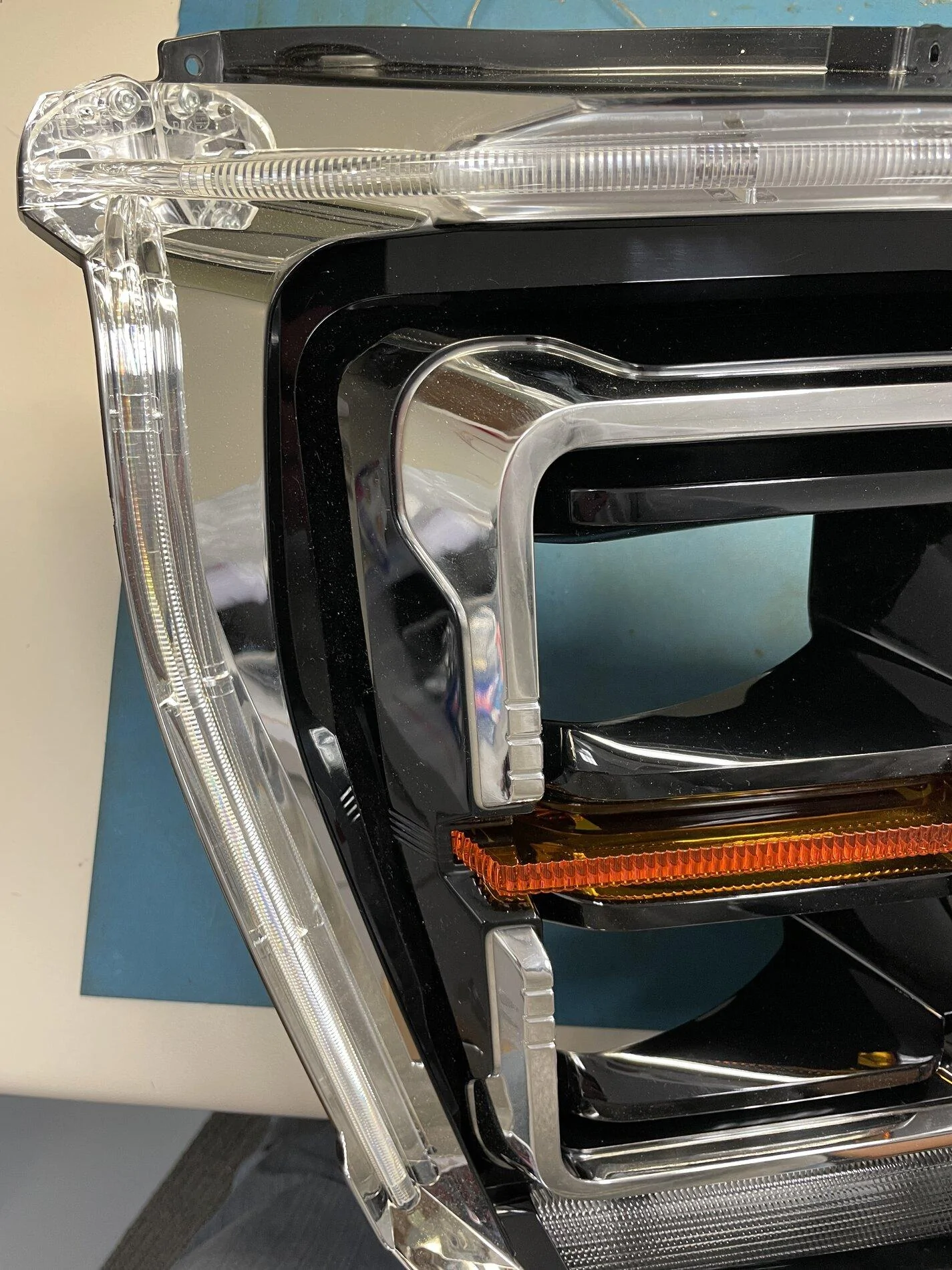

And finally the middle section of the headlamp that incorporates the two DRL light guides:

You could remove and replace these white LEDs with amber. These are Nichia brand LEDs, so you’d have to get the same Nichia device only in amber. White is more efficient than amber, so the amber devices will not be as bright as the white.
Also, this PCB is a copper core board which is used to help with the thermal management. You’d have to have access to the right equipment to be able to remove and replace LEDs from this type of substrate. Takes a lot of heat.

You’re welcome! It’s what I do for a living so I am more than happy to share. ??
The LEDs are white. No RGB for this application.
Yeah, a soldering iron unfortunately would not work here. The solder pads are completely on the bottom of the device. You would need at minimum a really good hot plate and ideally a good reflow oven.
The idea of an amber film could perhaps work. It would be worth a shot if you decide to take out a lamp and disassemble it.
