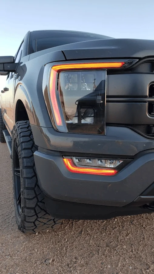

Strips, two in the headlights and one in the fogs. You have to tear them apart regardless to change anything. Had them done a year ago professionally and zero issues.
It would be extremely difficult IMO to match the fogs to a factory raptor drl as you'd have source the same led board and wire it up if you wanted the turn signal as well. Without the board you'd have to run a stand alone controller to try and match it the best you can.

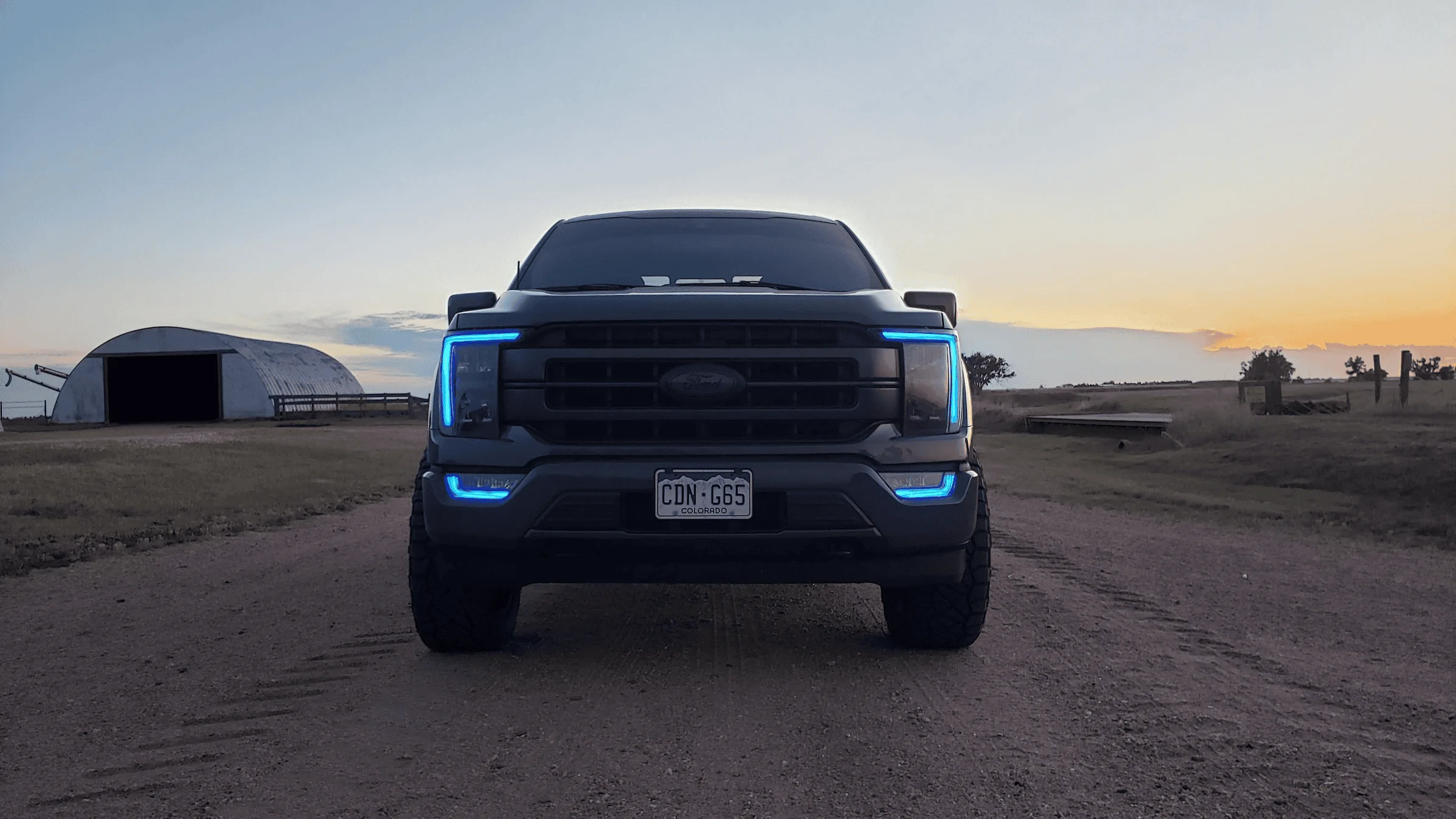

They're ran with a standalone aftermarket controller and run off keyed power. I completed disabled the factory white DRL's. Precision Retrofits did all the work on them for me.

Thanks! Cost about $1200 for everything, but that was opening the headlights and foglights, adding the RGB stips to all of them, the drivers and controller for them all, then blacking out the headlights as well.
Here, I'll add to your addiction... :ROFLMAO: Ya, for a couple days after I got them all hooked up, I would just stand out here and play with the different colors and combinations for way too long haha.

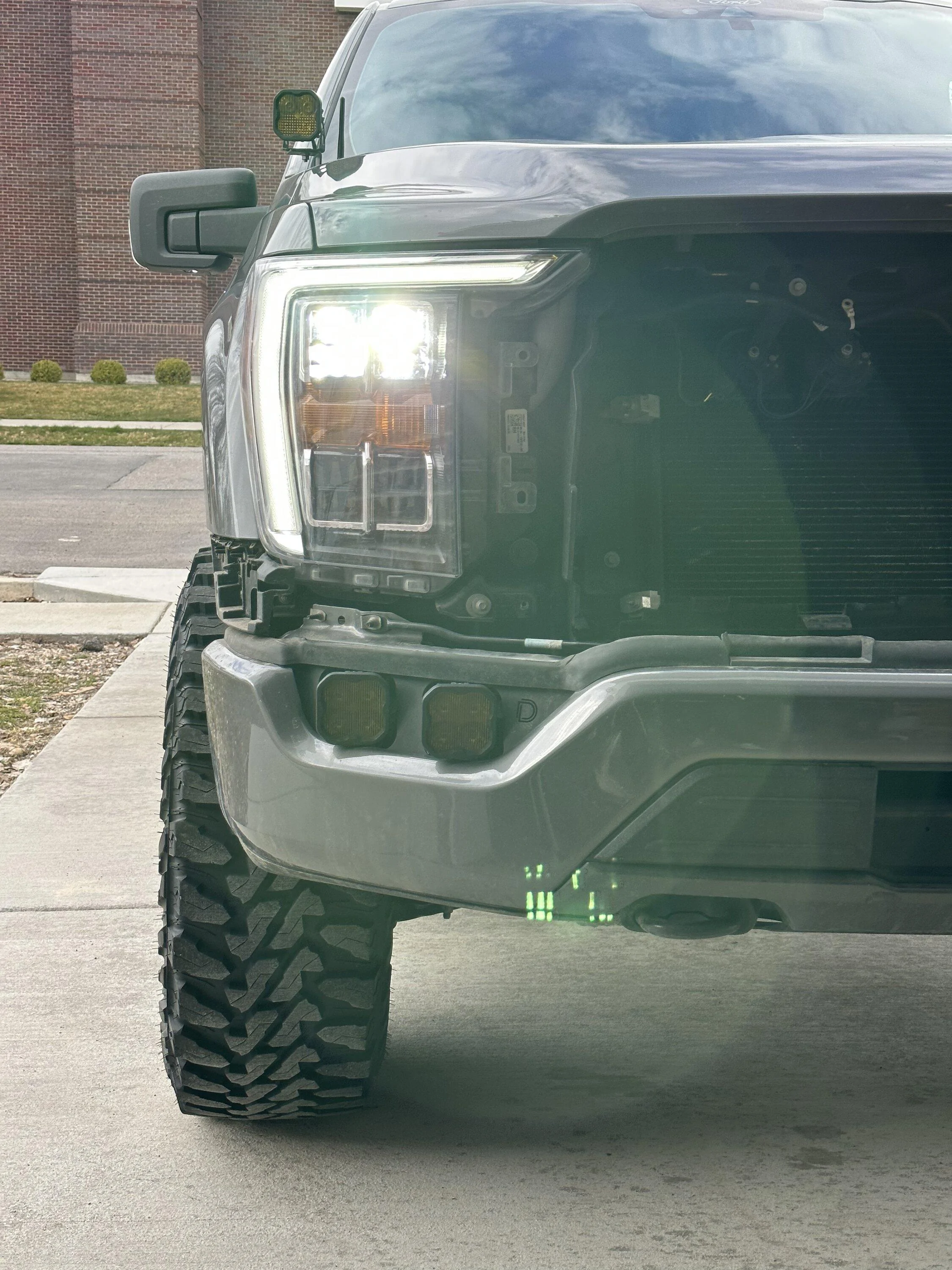

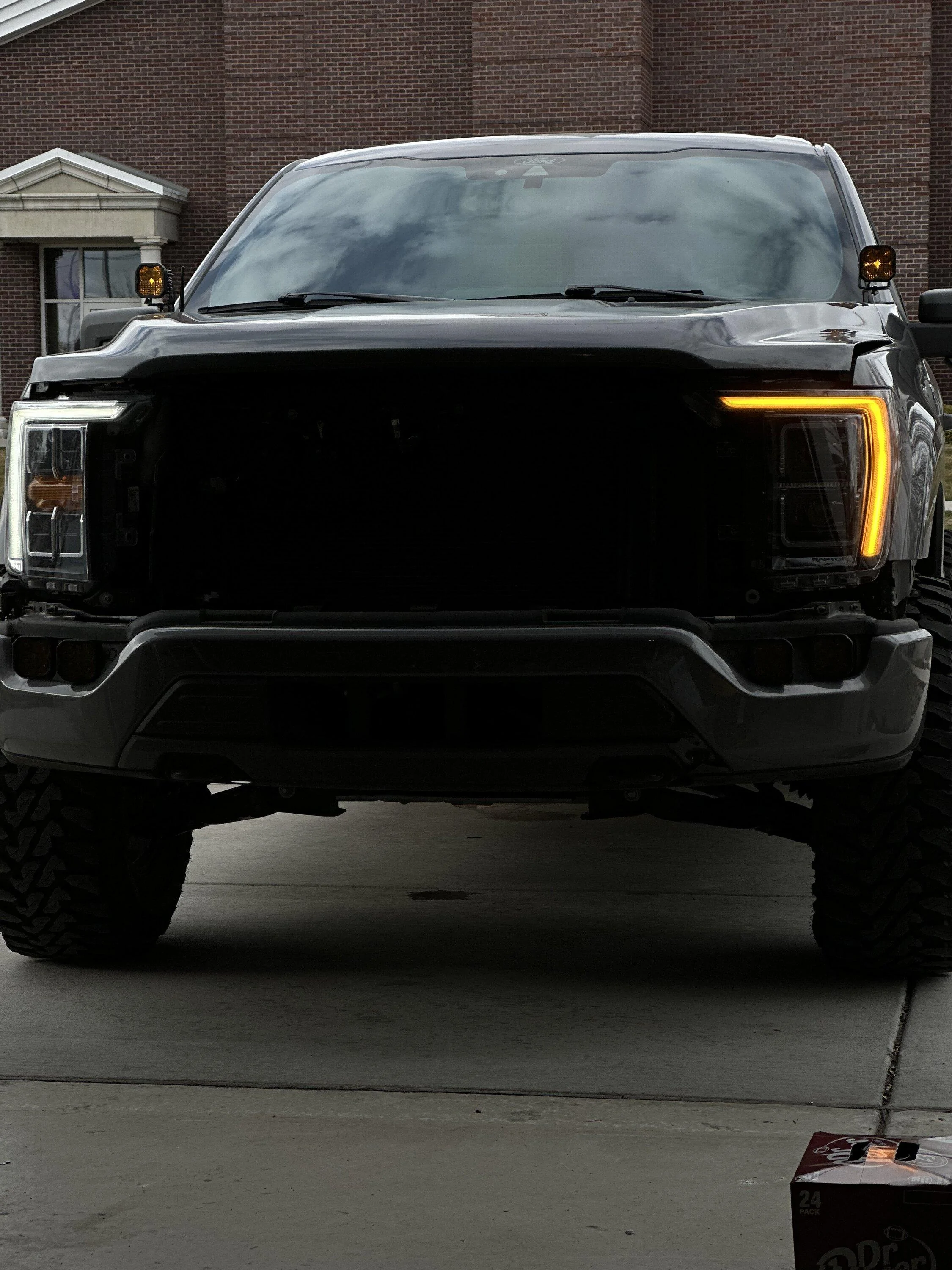

I'm in the middle of this right now. Swapping from bi-led (quad led) reflector to raptor on my 302a. I will be trying to get drl as turn to work, then deal with the high beam functionality with a new hcm.

I was just able to get drl and signal working. Stoked on how it's turning out!
