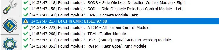

Confirmed today my front camera does not come on when the sensors are triggered. Entire touch screen only shows front zone diagram. Job 2 '22
Ever since I've got my Forscan adapter 2 months ago there has been one CMR DTC which recurs after clearing. Google refers to a thread here for same DTC indicating its the driver nanny camera/led though its the rear camera module. I have never seen an LED come on inside (maybe IR?). I've run the treads diagnostic precedure (except for module self test, not sure how or if I can) and no errors after clearing and a couple cycles of ignition. Front cam still does not come on after clearing with sensors triggered.
https://www.f150gen14.com/forum/threads/any-idea-what-this-code-is-for-b15e1-97-08.7085/
HVAC DTC for programming after swapping controller, but should not be relevant I'd think.
Would appreciate any thoughts or insight. All external cams function as do external LEDs when enabling with zone lighting.

@Jesse-Infotainment , any chance you would have some thoughts or suggestions on the front camera not coming on automatically when the front proximity sensors trigger. Currently only get the proximity screen. Front cam works fine when turning on thru the menu or the 360 view.

There is an as build that sets that up. Possibly it got changed or something. Send me your vin and I’ll look
That would be great if its a quick change I can do in Forescan. Only change I've done so far is to the IPC to enable gauge numbers. Don't think I can take credit for hacking this one lol
VIN 1FTFW1ED0NFB15356

706-16-01124300000079
Change this line to
706-16-01124B00000079
