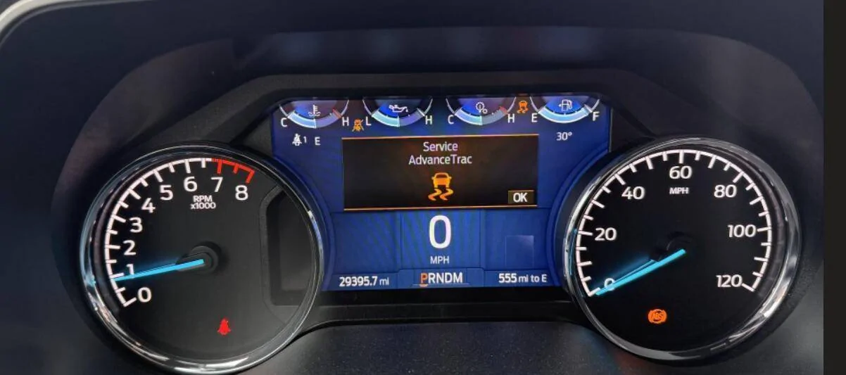

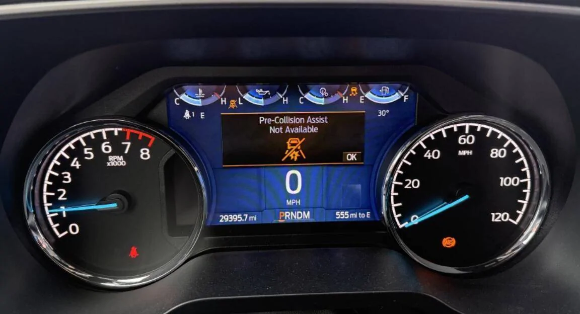

Second time now this has happened to me. The first time it happened I sprayed off the truck to get salt and other grime off the suspension and so forth. After a few hours I drove to the store... when I came back out to my truck and started it, I get "Pre-collision Assist not available" great.. Then I get more... basically all the safety systems get disabled. Even cruise control assumedly because I have adaptive cruise control.
Second time, we had wet slushy roads... drove about 20 minutes (again to the store) with the slush splashing around the whole way. There was quite a bit of it so under carriage got trashed with it... Came back out to truck... and again, all the warnings. had to drive home the whole way without any safety features. Basically everything gets disabled, even ABS. ABS light comes on too; tested this and sure enough... no ABS activated.

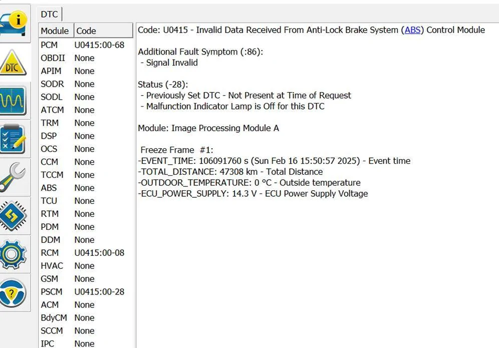

Anyway, does anyone have any clue? I pulled codes with ForScan and it just had the 'Bad data from ABS module code'
There are multiple modules giving a U0415 - Invalid Data Received from Anti-Lock Brake System (ABS) control Module.
Ford F-150 All safety systems getting disabled when cold and wet? 1740146618407-sd
Code is being thrown by PCM, RCM, PSCM, and IPMA.
