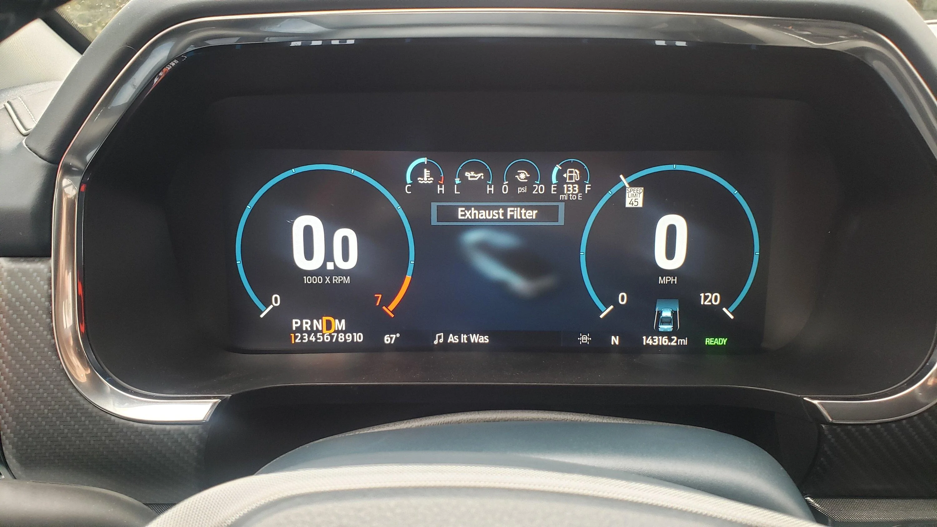

After putting up with a constantly rebooting instrument panel cluster (IPC) for the past 1.5 years (has rebooted hundreds of times), and after the dealer applying every update, patch, and software fix known, they ended up completely replacing my IPC. Time will tell if that fixes the reboot issue, but after IPC replacement I get a weird "Exhaust Filter" screen when I toggle through the My View screen options. It is not a selectable option to hide / unhide, but it is always there when I toggle through the enabled My View screens.
Any ideas what this is for, and how to turn it off?

Likely something to do with the Powerstroke would be my guess. Maybe poke around in the IPC with Forscan and see if anything matches this. Just be certain to backup your settings BEFORE changing anything.

Sounds like the dealer needs to fix their programmable module installation mistake.

Means they didn’t configure it

Take it back to the dealer---let them fix it!!!
