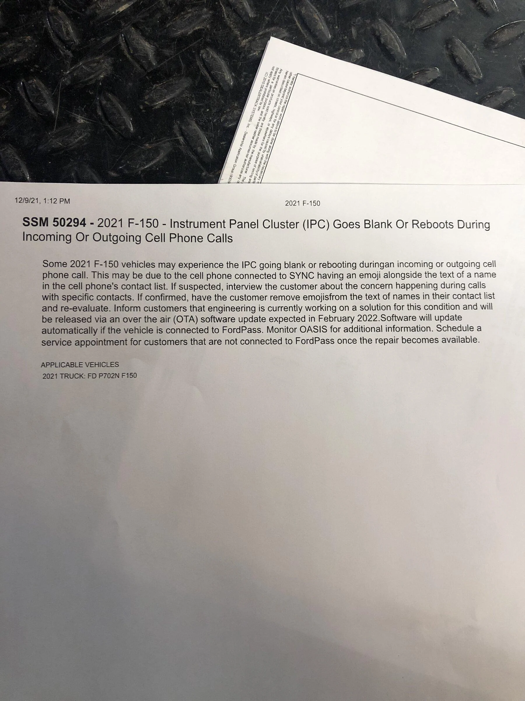

I’ve uncovered a problem that I haven’t seen posted before.
I noticed my instrument panel restarting while I was driving. The first couple of time I couldn’t figure out what was happening until I finally noticed it only happens when I call certain people saved in my favorites on my phone.
I can now consistently make it happen when I call them or they call me. Every time there is a call with those certain people the panel restarts while the vehicle is in motion. I don’t lose any power or control of the truck, just complete loss of the panel while it restarts. Anyone else noticed this issue?
I have a 2021 Lariat 502A PowerBoost and mine started to do this yesterday. There erid thing is I would time it and it was almost every 6 minute it would reset. Once it complted that my radio would run through a quick cycle but never lose sound.
Almost from the day I got it sometimes calls would not hang up as well. I would hit the hnagup and it would cycle back to the call even though there was no call on my phone. I would have to turn bluetooth of on my cell to get it to stop.
My Fixed Ops director today said those two issues are somehow related. Hoping for a fix soon thats for sure.
My truck is doing the same thing. I’ve narrowed it down to answering incoming calls on the screen (using Bluetooth). My truck is a ‘21 Lariat SCrew, 5.0.
