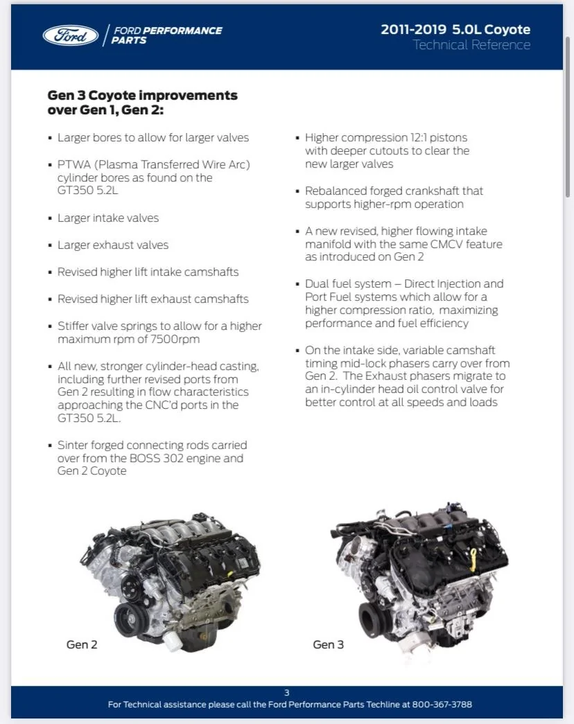

By the way this material does confirm our engines have the same sinter forged connecting rods found in the gen 1 Boss 302 RoadRunner engine, that was one of my big questions. Probably part of the reason our motors are good to spin up to 7,000 rpm. For gen 3+ the short block is the same between the Mustang and F-150 with the same pistons. Only the camshafts and intake manifold vary unlike the older coyotes where they were two different engines.

Pardon my ignorance, so what "gen" do I have in my 2021 F-150, 3 or 4?
And yes, joining @OP, I would love to have some more detailed info about this engine. The material above is for the previous generation I believe.

@sbi It’s hard to pin down. Some call it gen 3 still, like an updated gen 3, and some call it gen 4. There are certainly updates from the 2018-2020 version, but a lot also remains the same. For one our throttle body is larger (87mm vs 80mm) and our cams actually have reduced lift from the OG 3rd gen to accommodate more low end torque. Our engine (21+) also is capable of a lot more RPM in stock form. From my understanding the Kevlar belt driven oil pump is safer for high revs, so that is why our engines can redline at 7,000 from the factory instead of 6,000 rpm. We also have a new intake manifold as well. Fords engineers stated they torture tested the 2021+ 5.0L at 1,100 horsepower and the engine passed with flying colors. The old cast oil pump gears were a weak point at high revs, so Ford eliminated that design.
Comparing the 2018-2020 to our 14th gens our engines actually have both more low end torque and more top end horsepower. The 18-20 made 400 lb ft @4500, the 21+ makes 410 lb ft @4250. Power is also up to an even 400 horsepower over the previous 395 of the OG 3rd gens. They accomplished this with the reduced lift on the lobes and allowing ours better induction with the throttle body/ manifold update. We still have the plasma arc transfer cylinder liners which keeps the 307 cubic inch displacement. I have read that the oil control rings are also new.
To be honest with you it’s not easy to find info on either the 3.5 EcoBoost or 5.0 Coyote regarding the updates that were done for the 14th gen F-150.
