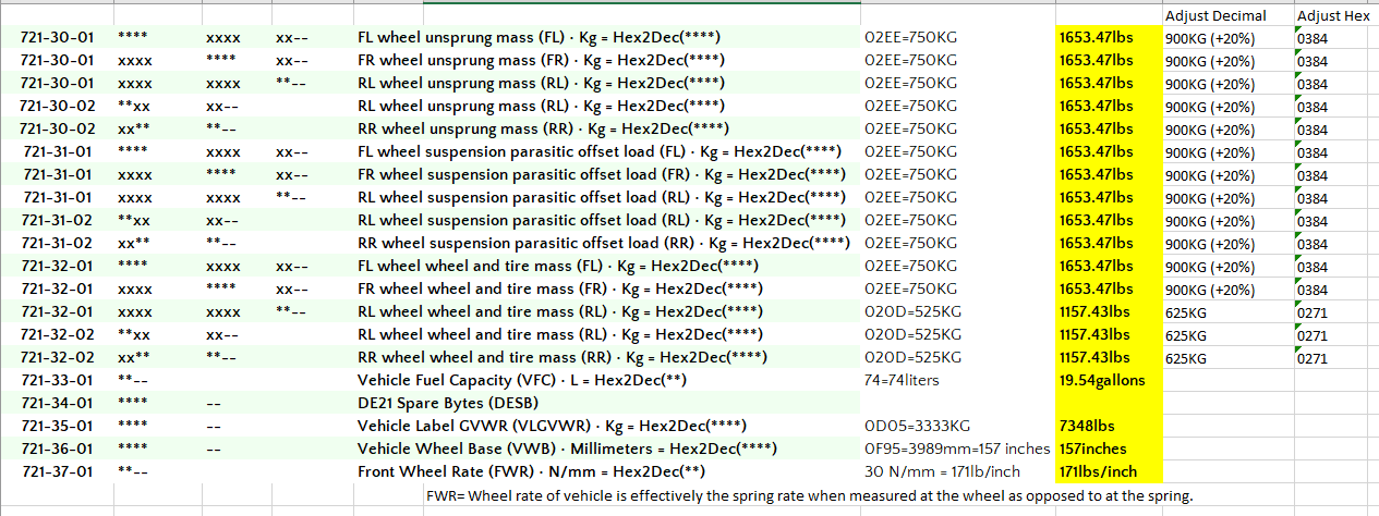

and editing some values in the VDM module, I was able to "dial it in" for an empty long bed F150 in Normal mode.
I'm curious, what did you change in regard to the Values in the VDM module?
Do you have CCD?
I basically edited the weight (in KG) of multiple categories based on the field mapping that one of those Forscan gurus laid out.
Yellow was a conversion to lbs just so I could get my head around the factory values.
The next column was the target weight after editing.
Last column was the substitute hex value representing the target weight.

Adjusting these values will change things for all drive modes, or just normal mode?
Do you know if this effects the headlight leveling?
Does not affect headlight leveling.
I will look for the thread that discusses what I did, why I did it, and what I was aiming for.
Just editing the VDM would be out of context.
