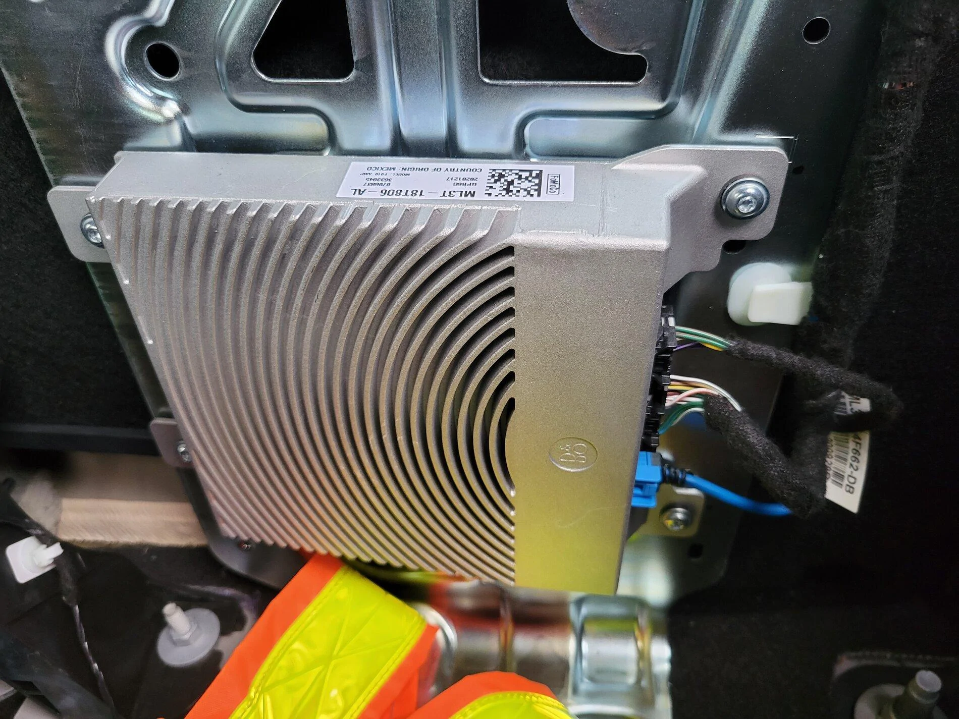

Please tell me if I'm crazy and going to waste my time? What if I were to remove that speaker behind the rear seat and replace with LC2i and one of these powered sub options?
https://www.crutchfield.com/S-qxddrb6Poxm/p_777B8PTD/Sound-Ordnance-B-8PTD.html
https://www.amazon.com/Rockville-SS8P-Under-Seat-Powered-Subwoofer/dp/B079PRCP9W
I'm sure there are much better quality custom option but to me the only thing missing in the B&O factory system is little more base. Not expecting any huge bass gains.
Thanks for any input!

I know a lot of people are taking this route where they add the LC2i but they are adding a sub and an amp, i haven't seen anyone with those type of sub. Wondering how would the sound be?
Ok thanks, I will probably give this a go, see what kind of results.
Now does anyone have wiring schematic for this, assuming I could just tap into it for High Speaker Inputs and Amp Remote?

I got the Kicker install and just got to say wow I am impressed on this little sub. (Next thing i want to do is change all the speakers) So the kicker comes with all the wiring you need. Power wire from power block in engine to amp and as well signal wire from head-unit to amp. From factory all holes for screws and slits on carpet are there. Ford just didn't add the harness like they used to. Now on the head-unit there is no addition setting for just the sub so you still only have the 3 settings (Bass, Mid, Treble). A ford dealer needs to do the install it since they have to update the ACM and other components. Running the wires and all was pretty easy and only took about 1.5hrs.
