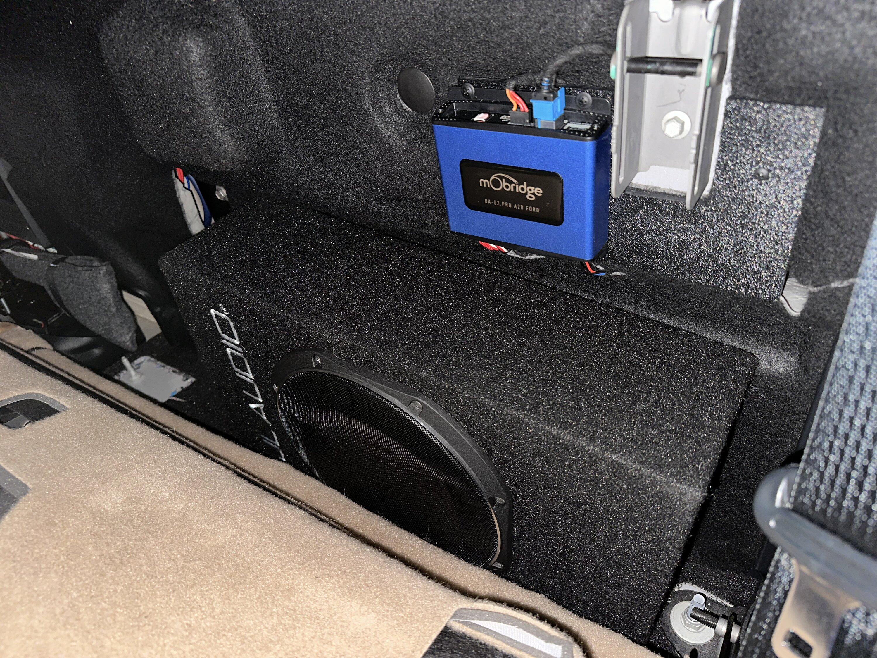

That said, there is room behind the rear seats for a very small enclosure in a SuperCrew, but watch your depth. I had this JL powered sub in my Lariat. It just barely fit behind the seat. And I do mean barely; the grille on the sub got dented by the seat.
Ford F-150 Add sub in factory location 1693166331443
You can see the dent in the above pic, that’s how tight it was. Before purchasing this, I looked up the dimensions of the enclosure and made a mockup from cardboard to see if it would fit. If you do this, remember to check the fit with the seat folded up if you want to retain that functionality. I made the mistake of not checking this, and was not able to fold my seat with the sub in place.
