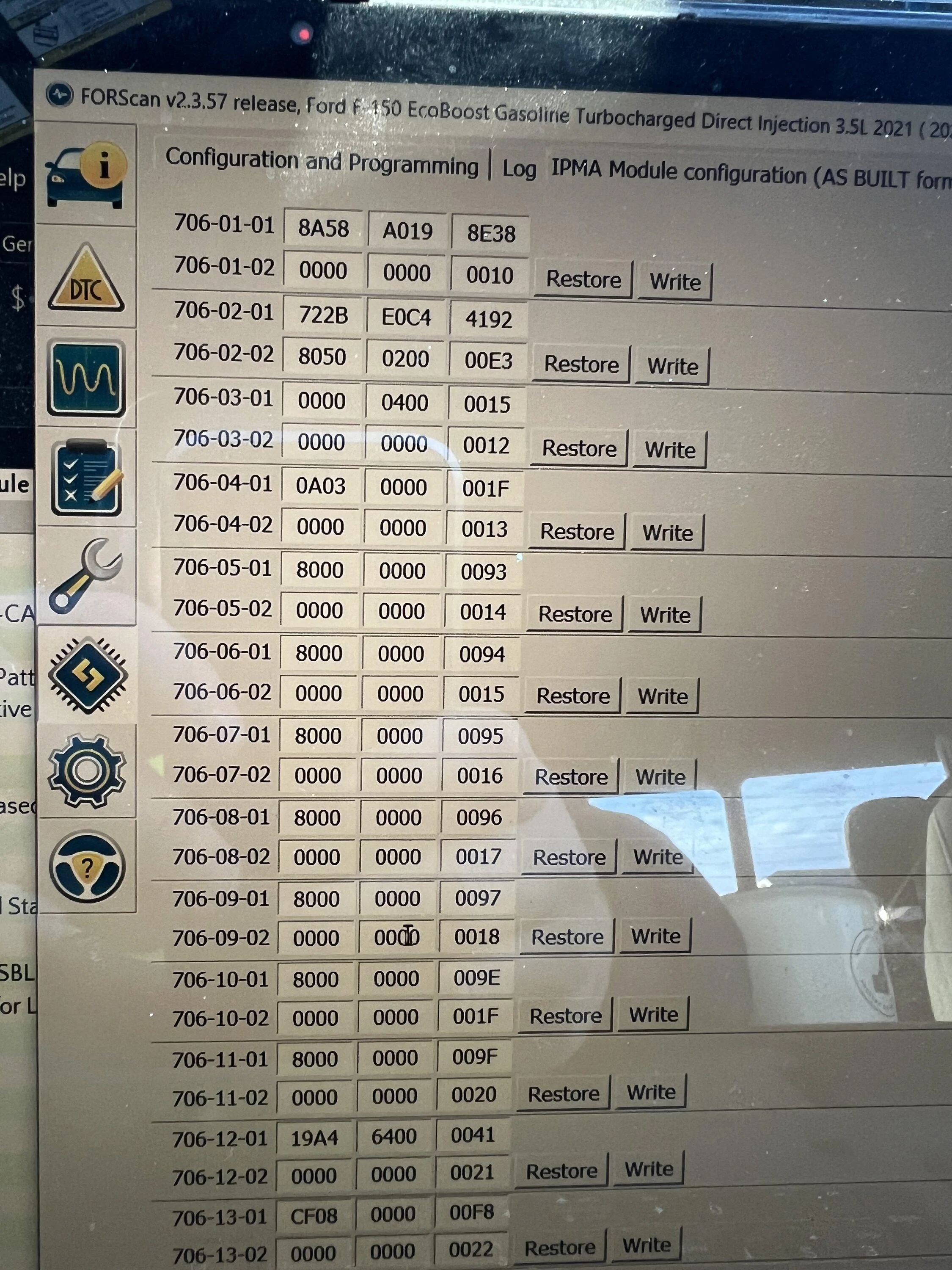

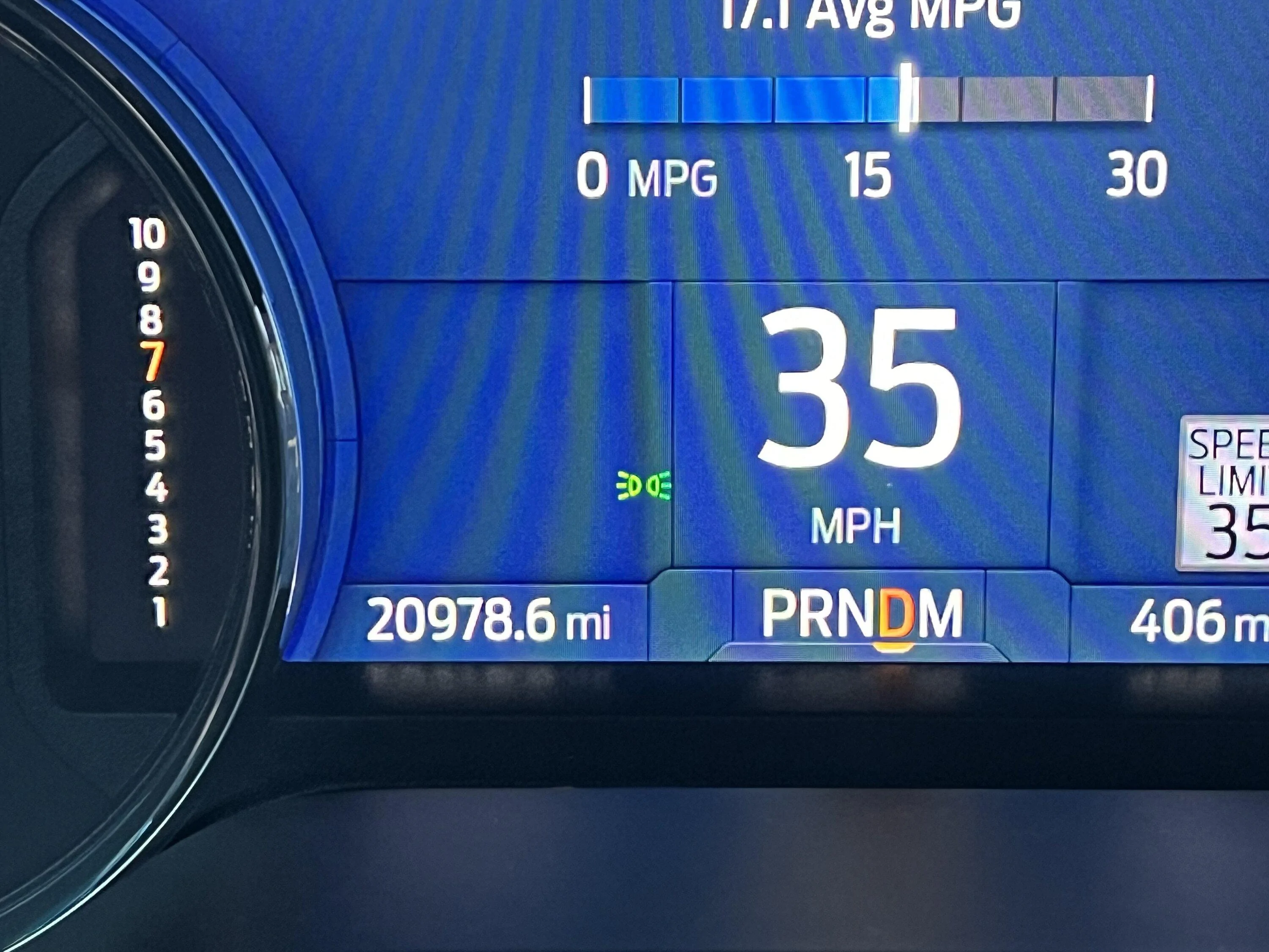

Hey guys, i'm finally catching up with modern technology and completing this mod to my 21 XLT 302A. picked up a set of tremor projectors and low beam harness kit from Scott Treichel (highly recommend him for lighting needs) and a high beam harness from a forum member. Got everything installed and programmed. From what i can tell, it all seems to be working but i do not get the auto light telltale on the cluster. I do have 2 codes in the hcm for the missing level sensors.
i've triple check the settings and i'm not seeing anything wrong. maybe a fresh set of eyes will help.
i obviously won't be able to test any changes right now since the suns up but am open to suggestions.
Anyone have any insight?
I just went through this same problem and I was not able to get them working until I added the level sensors. Now Glarefree auto headlamps is working.

You don't need the ride height sensors to make glare free work, unless something has changed over the last 12 months
I was not able to get them working with all the changes in the spreadsheet until I added the level sensors.
Thanks
any chance you know what the resistance of the level sensors are? Maybe I can fake it with some resistors…
I don’t think they are resistance based the give out a LIN signal to the HCM. Three wires each power ground and LIN
Myself and several others did not have to install the ride height sensors to get glare free to work. Interesting that yours is different

Yes I agree maybe forscan settings or something.
I kinda feel the glare free/ramping is working but haven't driven much out of the city yet.
Did you get the headlight symbol with an A? without your level sensors?
Yes

I also had problems with the Raptor DRL changes that were supposed to work and they did not on my truck. Maybe because it’s a 23 or maybe from software updates not sure???

Also Glarefree uses your front cameras maybe that DTC in the ipma needs to be addressed to eliminate that potential problem.
