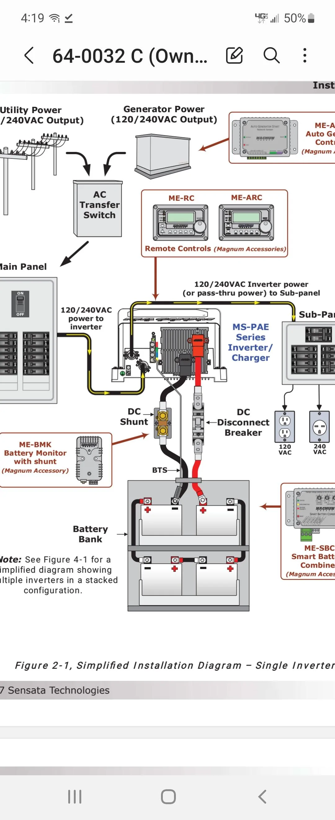

So, here is my guess ... from the manual:
Ford F-150 7.2KW ProPower for Off-Grid Cabin Screenshot_20220907-161941_Samsung Notes
No main panel. The generator connector comes into the inverter where the main would.
The sub panel has the bonded neutral/ground in it (as it should).
But, the inverter does a pass through and charge on the input. So the truck sees it.
If there is a setting to only charge, it would cause a lot of loss like @daemonic3 said, but would stop the truck from seeing it.

Very cool find! The pass thru makes a ton of sense. I missed in the feature set of the inverter that it has that AC input and pass thru, and is bidirectional to the battery.
I now wonder what the solution would be. Add a switch in that sub panel to unbond the neutral for propower use, and let the truck bond it?
I think that is it really!
It does mean manual actions for each situation. And, an untrained family member or cabin member could put the cabin in an unsafe state. Just putting that out there.
Not sure there is an automatic way to handle this.
If there is a setting to only charge, it would cause a lot of loss like @daemonic3 said, but would stop the trick from seeing it.
