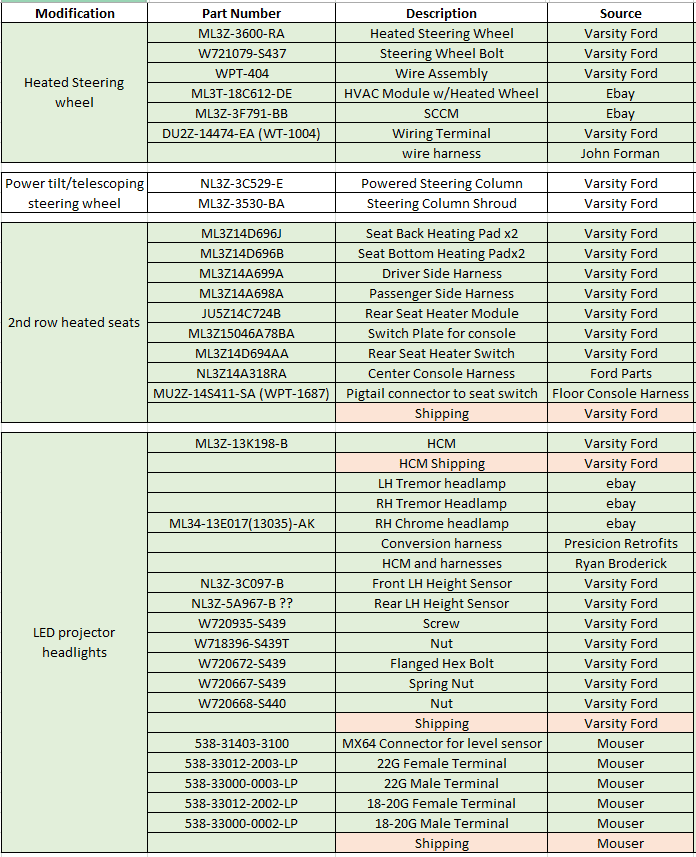

I went back to the first page and found you already listed all the part numbers so unless it needs updated I think that should be good. Are the part numbers for the headlights you listed standard projectors with the chrome trim or BAP/Tremor? Eventually I would like to add BAP/Tremor headlights, tail lights and also the Tremor front skid plate.I have all my parts lists now, I can share them if you want them
There may be a couple of updates that need to happen. I’ll check it out tomorrow.I went back to the first page and found you already listed all the part numbers so unless it needs updated I think that should be good. Are the part numbers for the headlights you listed standard projectors with the chrome trim or BAP/Tremor? Eventually I would like to add BAP/Tremor headlights, tail lights and also the Tremor front skid plate.
Nice work looking good
TBH, with this I just bought from eBay and couldn't really nail down a good Ford part number for the BAP/Tremor lights, I do know the suffix on the headlamps (at least on mine) was "EA". If you buy from ebay, be VERY critical of the pics, as it is hard to differentiate between chrome and black chrome in a lot of the crappy pics taken.I went back to the first page and found you already listed all the part numbers so unless it needs updated I think that should be good. Are the part numbers for the headlights you listed standard projectors with the chrome trim or BAP/Tremor? Eventually I would like to add BAP/Tremor headlights, tail lights and also the Tremor front skid plate.
none of those part numbers pulls anything up on the dealer parts websites I use. What DOES work is using ML3Z-13008, but none of the suffixes contains an "EA", so I don't really know what to make of that, or how to specifically find the BAP headlamps. Info is sorely lacking on many of these parts sites
well those are bap/tremor head lights. so...none of those part numbers pulls anything up on the dealer parts websites I use. What DOES work is using ML3Z-13008, but none of the suffixes contains an "EA", so I don't really know what to make of that, or how to specifically find the BAP headlamps. Info is sorely lacking on many of these parts sites
I understand what you're saying, but try looking that part number up on any Ford parts website. That must be the part number for a sub-assembly (maybe just the housing?) that Ford does not sell. That is not an orderable part number through Ford, you might be able to use it on eBay, but it is technically inaccuratewell those are bap/tremor head lights. so...
ok bud, i was just trying to help, good luck.I understand what you're saying, but try looking that part number up on any Ford parts website. That must be the part number for a sub-assembly (maybe just the housing?) that Ford does not sell. That is not an orderable part number through Ford, you might be able to use it on eBay, but it is technically inaccurate

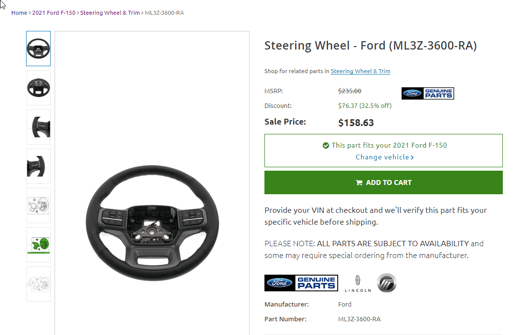

No worries, that’s what this thread is for.Did you do the Heated Steering Wheel yet? Is the clock spring in your parts list? Does the steering wheel look and feel as good as the original? Did it have the buttons for the ACC? $160 seems awful cheap.
Did you consider doing the Rain Sensing Wipers also?
Sorry, so many questions. Getting my parts list together for this and the ACC.
Well I was afraid of that. ThanksYes that is the wheel that I got. The leather feels more plasticized than the factory wheel. Not enough to make me uninstall it, but the difference is noticeable. Yes it has the buttons for the ACC.
