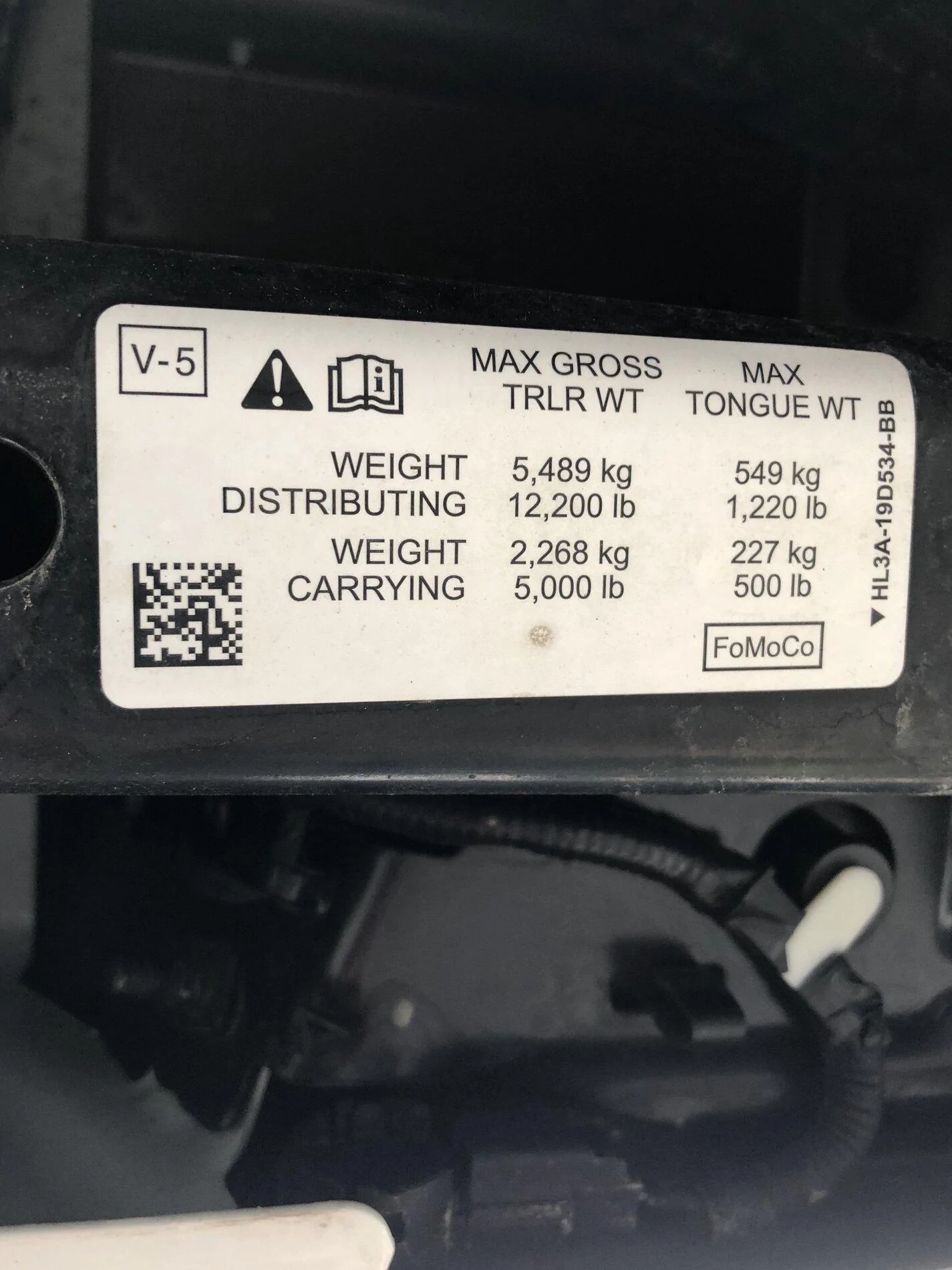

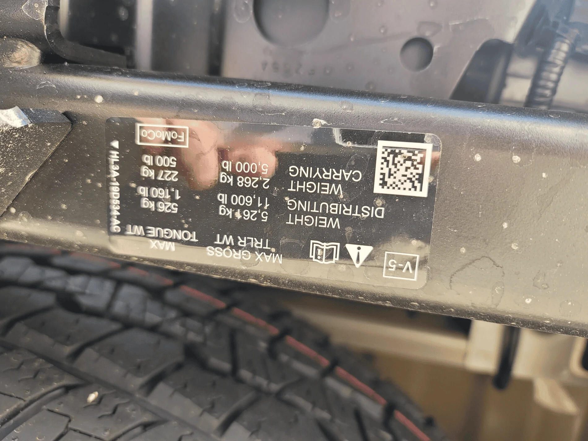

I think we need someone WITHOUT ANY tow package, to take a pic of their hitch receiver. It has the ratings for straight on ball, and for using a weight distribution hitch. I think @Crapblaster posted his from the tow package the other day. It clearly said something like 11,200. So maybe you only get a class 2 or 3 hitch and that is why?

Here’s the hitch sticker.

Another point of reference: from my former ‘18 with Max Tow.
