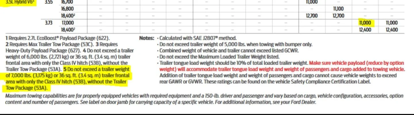

The Powerboost 4x4 701A 5.5' can tow up to 7,000lbs w/o TT package, though it can go up to 11,000 with the TT package. According to the documentation.
It has to do with the receiver, and then the brake controller. A class IV and then the brake controller gets your everything. My dealership was telling to get me to stay with max tow and that tow tech only got me 5,000lbs which is not the case, but I wanted to see if anyone had been told the same.

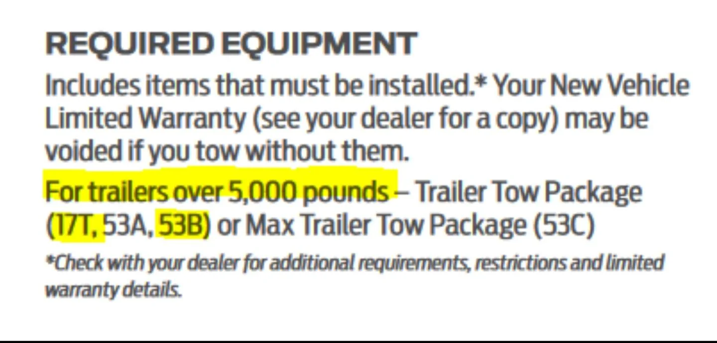

My dealer said the same thing, then I showed them the part in the F-150 tow guide that says above 5000lbs, you need a 17T,53A,53B,53C. If you look at the power boost tow ratings, it has disclaimer "5" that if you want to go above 7000lbs for powerboost, you need the normal trailer tow package or max tow. They said I was correct.
I hate spending $1000 for the trailer tow package on what I think is an upgraded sway bar, but I am having my dealer add it. It will boost it up to 11,000lbs. I can't really reach that in reality, but as I tow boats, they have half the tongue weight of a travel trailer. It will be nice to have a lot of breathing room.
I think they are mistaken there but only because I don’t think there is anything in the trailer tow package you don’t get on a lariat 502a and the tow tech package. If I’m mistaken there let me know.
The towing guide says the tow package 53a not tow tech. Where are you seeing this. Fords documentation is very cryptic on this.

I don’t see anything about different radiators anywhere on the towing specs. Still searching.
Check out my post here: https://www.f150forum.com/f82/tow-technology-vs-trailer-tow-packages-491149/index2/#post6796970
There is a lot of variation between trims, power trains, etc.
The bottom line is that Max Tow is not a great upgrade for PowerBoost due to the low payload, high cost, can't get the 36gal tank, and that PB comes with a 3.73 rear axle. Though the Max Tow might get the HDPP axle.
Agreed. What I still can't nail down is what is a Lariat 502A tow rating with Powerboost 4x4 145". It appears to be lacking the heavy duty sway bar, which could cost 4,000 lbs in towing?
