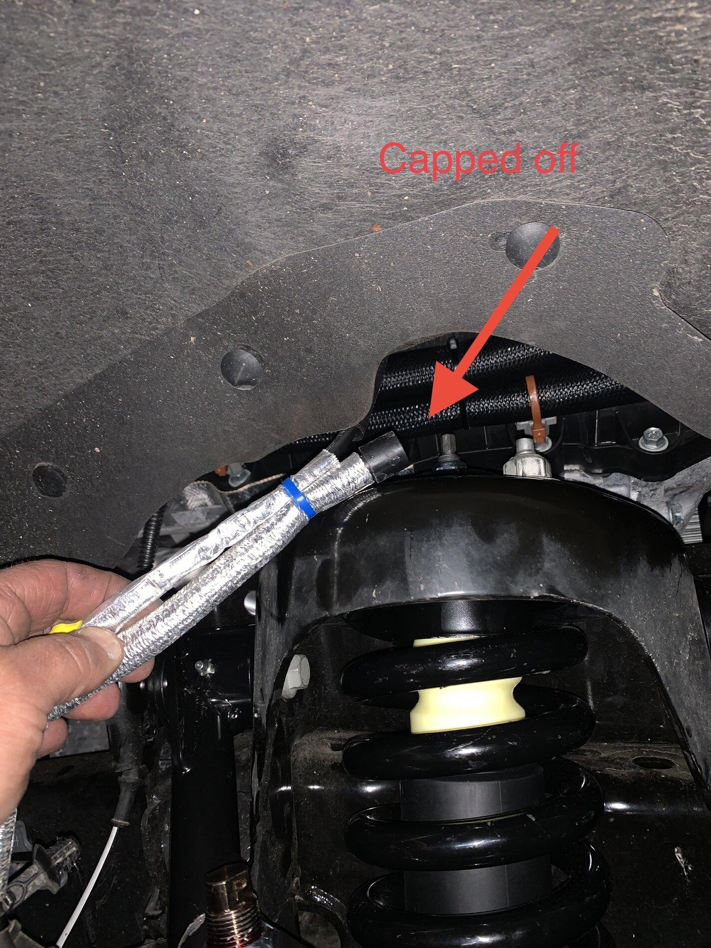

Ford F-150 4X4 System differences AFDE76D9-3CB0-45B2-8DF2-186DD89FC615
I I may be a little late on this, but Im in middle of installing my lift. I followed the possible “Vacuum line” up. See pic. It’s capped off. I’m assuming it’s a vented cap.
