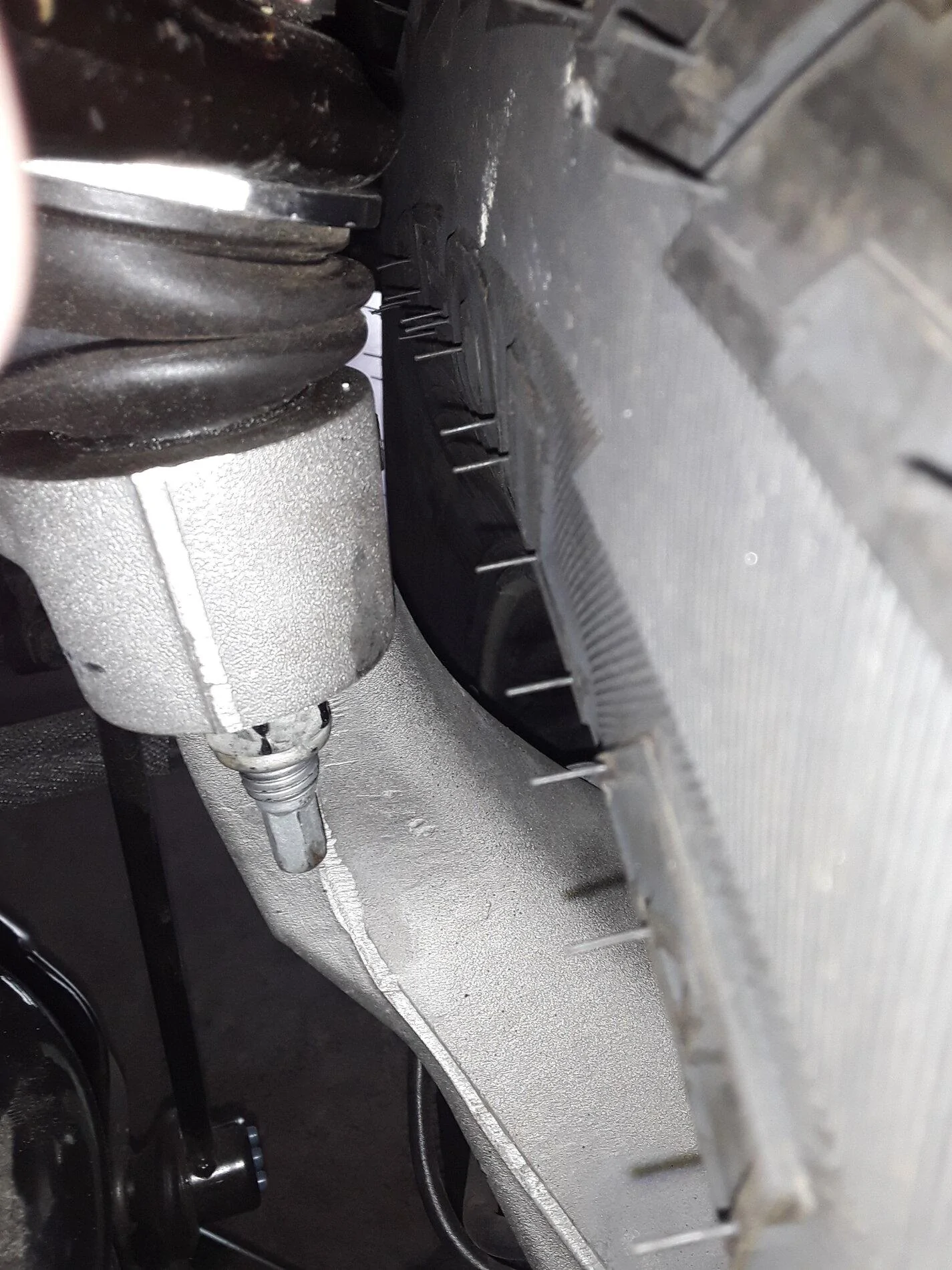

Just got the Eibach pro truck sport leveling struts on last night. They say 2" of lift on the highest ring setting. I got 2.75" with my factory max tow coil springs. So far ride is good no floating or roll. It looks to be 1/4" high in front. Only 25 mi. So far am hoping they will settle a bit. Went with Geolander G015. 295/70/18 stock sport wheels. No rubbing, even have the factory splash guards. Upper control arm ball joint and side wall is 3/8", 7/16" won't go. I'll post more tomorrow. I think the eibach may be a good fit for me
