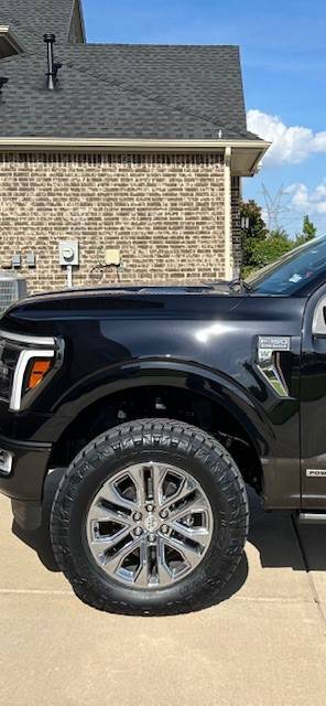

Get my Nitto Ridge Grapplers (275/65/20) - 34" in SL load. You can also get the Nitto Recon Grapplers in SL on the same size (I think the Ridge looks more badass).
Ford F-150 34" A/T tires with lower load range? KR Tire
Ford F-150 34" A/T tires with lower load range? Nitto Front
Ford F-150 34" A/T tires with lower load range? Nitto Close U
