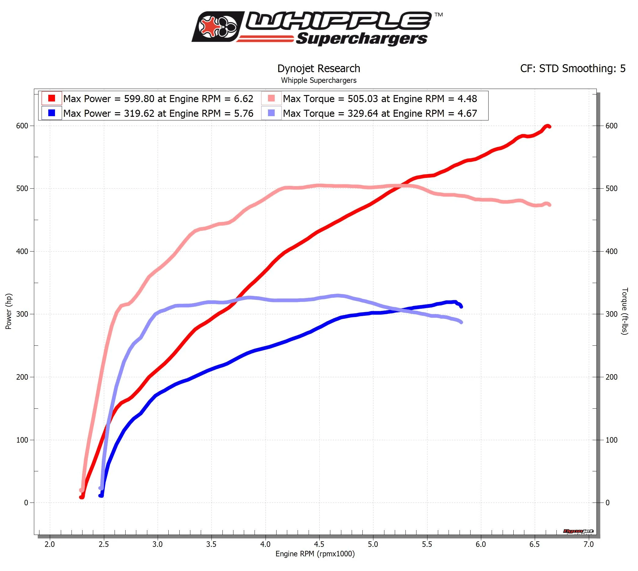

Ford F-150 3.5L EB vs. Supercharged V8 IMG_4542

This is not an actual dyno graph, just something I generated with Ford's advertised numbers and what I'm seeing on my own 3.5EB with a mild 93oct tune. Comparing the very conservative FPP 5.0SC to a mild 93 oct tune 3.5EB should look something like the graph below.

Amazing what that Whipple will do to a Stock 5.0----
It really is.... I can't explain it..... I've got about 1500 miles on the very conservative FP/Whipple 5.0 SC. It's normal, just more responsive in the 2Kish RPM, linear, deliberate, just nice...... now take it to 3.5-4.5K RPM and even then, smooth, deliberate faster acceleration... the engine sounds happy if that makes sense....
Sorry to distract from the subject.... I think the chart @SALEEN961 shows is the best compilation I've seen yet....

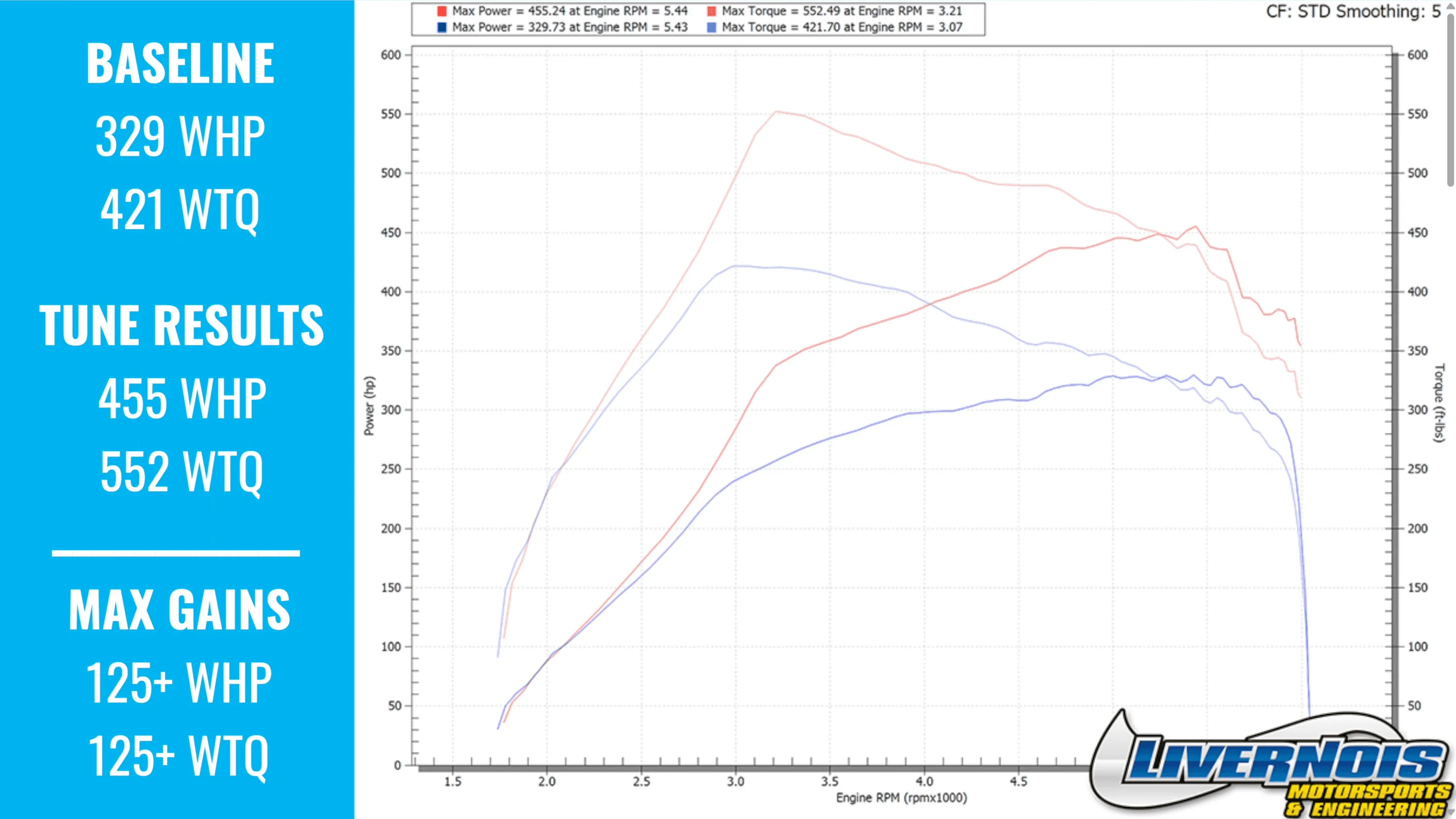

This is why I didn't go with the supercharged Coyote.. $10k for that and another $10k in lift/wheels/tires was a bridge too far.
Just a tune on an otherwise stock truck shouldn't cause issues assuming Livernois didn't overdo it. With the supercharger you know you are getting longtubes and I'm enjoying my first quiet vehicle in a long time.
Here's what Livernois is claiming on the 3.5EB stock; I've since added an AFe intake for whatever that's worth:
Ford F-150 3.5L EB vs. Supercharged V8 1707318105216
